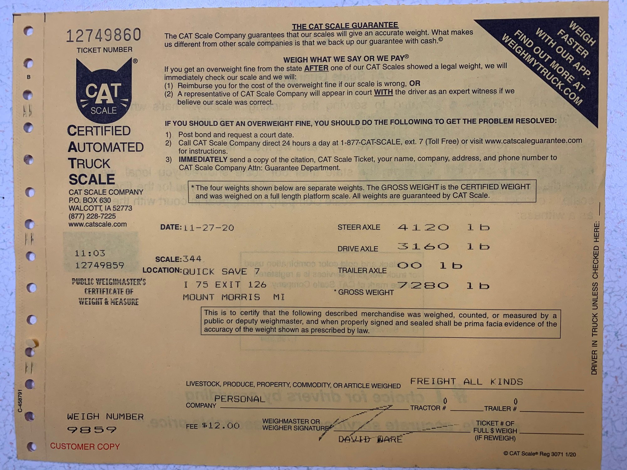

Got to the scales today! still trying to get to the available pin weight for fifth wheel.
The truck with me in it and full of gas we are at 7280.... ive plugged in the numbers, the only unknown is the hitch.
i feel i will have right around 3k for pin weight.
payload sticker 3888, actual payload 4214.
would love to hear your thoughts on what i have here.

Just wondering how you got to an actual payload of 4214. 11,100 GVWR minus 7100 actual curb weight of truck equals 4,000. What is the Gross Rear Axle Weight Rating for your truck. You don't want to exceed the axle rating. That is a more important consideration than payload.

weight of gas is 214.
rear axle is related at 6780. Tires are rated at 3415 each @ SRW

Rear GAWR is 6,780, so subtract your scaled rear axle weight to get your remaining capacity on the rear axle:
6780 - 3160 = 3,620 lbs.
As you add passengers, stuff, hitch, etc, your rear axle capacity will be used a little. Absolute "sure fire" method would be to load up the tanks, the family, all the stuff and the hitch, then re-weigh on the scale.
In theory, you should run out of GVWR before you run out of GAWR

Got it. The trucks stickered payload is calculated by subtracting the curb weight from the GVWR. Curb weight includes a full tank of fuel.

I think the 6,780 GAWR is derived off the tires.
I think the 20 inch and 18 inch wheel AT tires are like 3640 lbs each at 80psi and they tag those trucks with a higher rear GAWR.
Incase you need some extra safety margin in your rear GAWR. Food for thought...
