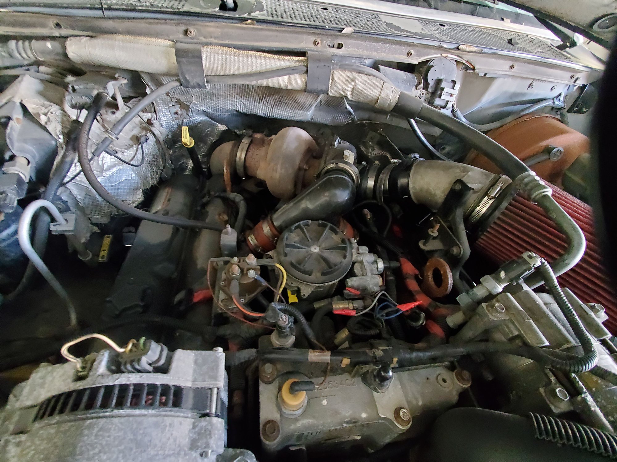

-the ICP sensor twice (connections are to addressed, i know they look bad in picture, i assure you that the connection is solid)
i am not sure what cause them to go.

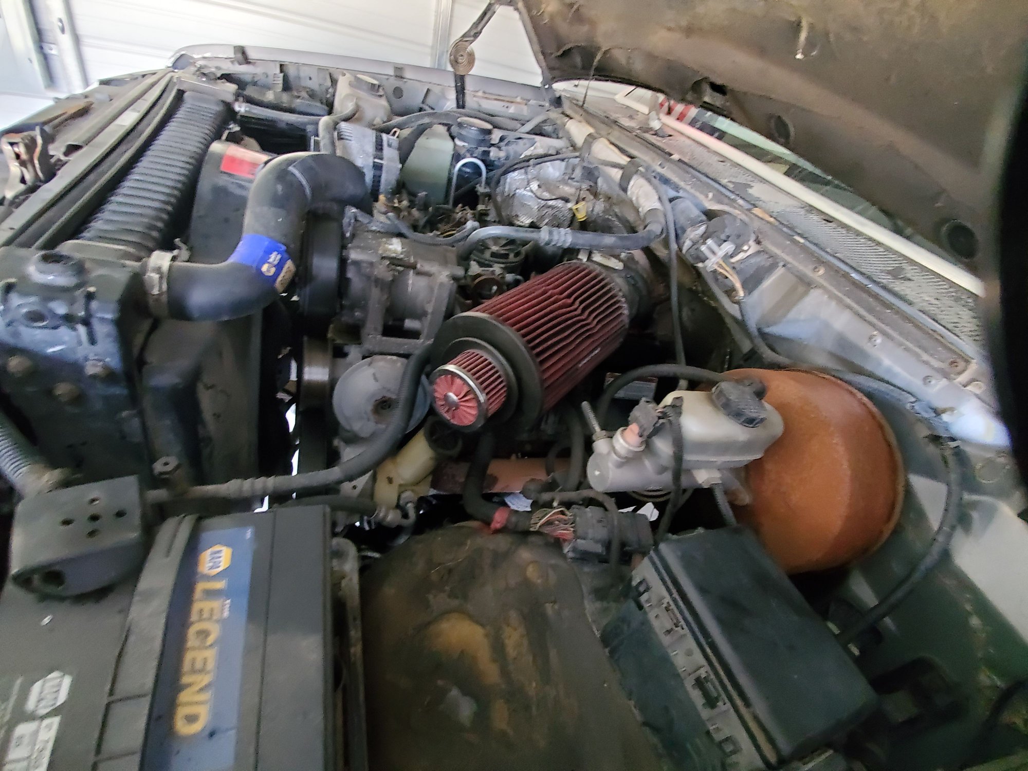

Nice truck. I like the simple approach to the air filter. If its a K&N it needs to go. The filtration lets too much crap in. A standard 4" flex boot and a chunk of 45* bend 4" tubing and a riff raff 6637 and you're all set. DIY Tymar on a budget

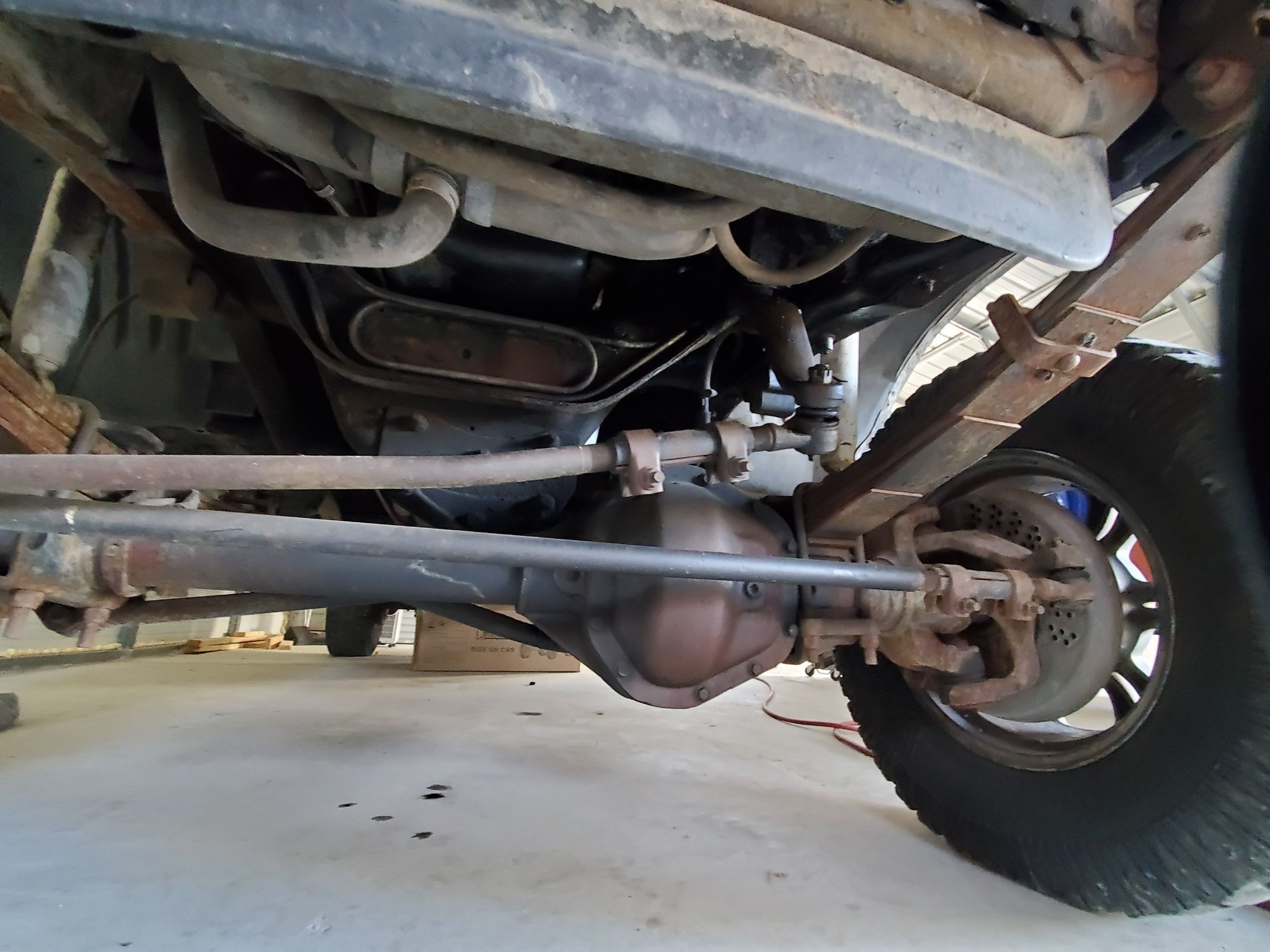

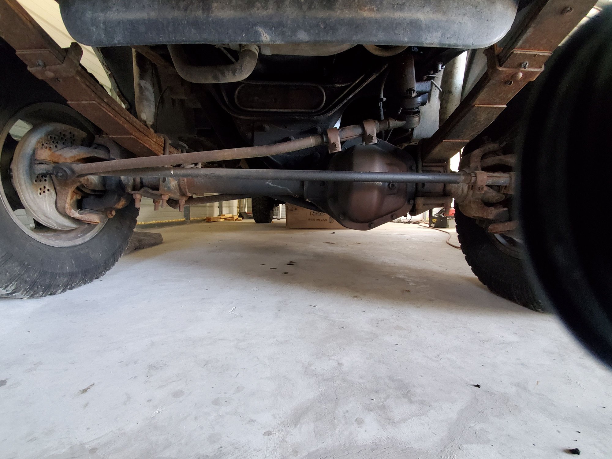

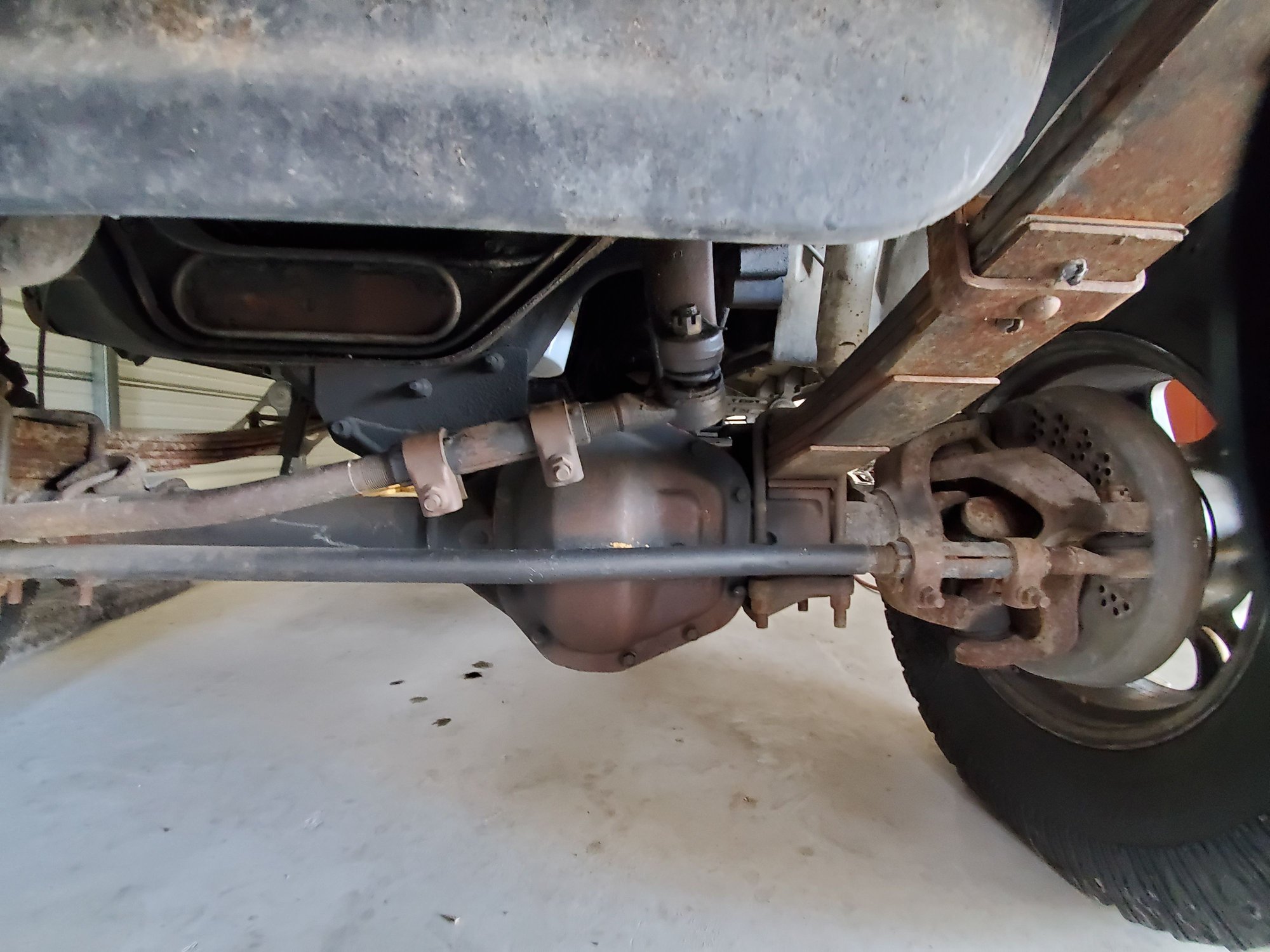

I am currently tracking down a clunking noise when I turn, it makes the clunk when I turn from 1 direction to the other. I replaced inner and outer tie rods, which were definitely needed, but I feel the clunking has gotten worse. When I had the wheels off the ground, I didn't have much movement up and down. Its been difficult to track down by myself. I was planning on replacing ball joints and u joints for maintenance purposes but I'm not sure that is what is making the noise.
Here is what I know
When hubs are unlocked, I can free spin the u joints, but the is a little grinding noise which isn't consistent with the clunk
I know my steering box has seen better days, along with steering shaft, but I do not the the clunk while stopped, only while moving
I am not sure if my pitman arm is stock or not, I dont really have anything to compare it to, but since the truck is lifted, there is a good chance that it is stock
Would anyone be able to post a picture or take a measurement of the drop of their pitman arm?

If you're going to update the steering shaft and box, they make new shafts with universal joints instead of the rag joints. I believe Borgeson makes them.
Red head or Blue top are good. Blue top used to work at red head and split off and started his own company. I usually like to support the little man instead of the mainstream so I'll go the blue top route when I do mine.

I had a clunk when turning or driving over small bumps.
turned out to be my steering shaft down by the rag joint where it connects to the steering box had a bunch of play in it. There’s a rubber bushing on the stock shaft that goes bad and causes the clunk. This drove me nuts for some time. New ball joints, tie rods and red head steering box did not make it stop.
Look and listen to that rag joint while a partner moves the steering wheel back and forth to confirm
Borgeson makes one for are trucks. It’s pricey but it was one of the best things I have replaced on my truck.
Steering improved dramatically

Under $4k for a CCLB 4x4 F350 is not a bad deal to me! Low power is probably a ton of small issues...you probably have no turbocharger drive pressure due to leaking uppipes. Plus stock injectors, 35" tires, heavy wheels, etc.

That Borgeson shaft is overpriced, but worth it. Real easy to install, loctite the bolts.
That combined with a red head box made my trucks steering better than new.
Truck has 245k and the stock shaft was completely worn out, rag joint bushing was gone and that was where my clunk was. There was also play in the upper shaft where it’s made to collapse on impact.
