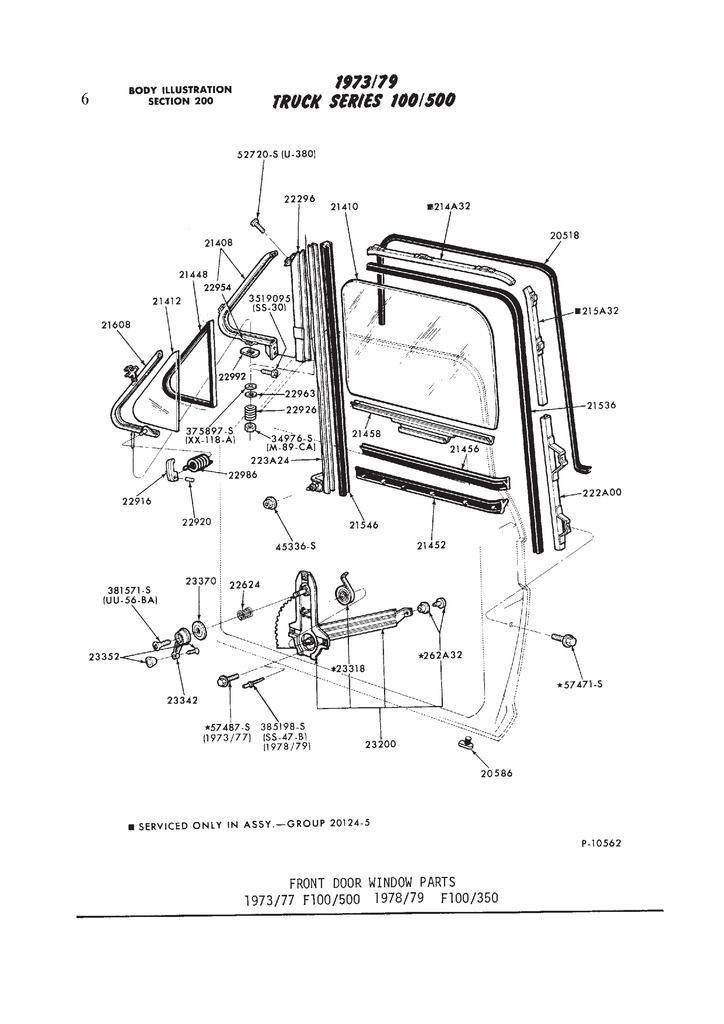

Looks like it might be a problem to get loose and reset? I know that 214A32 is/should be held in with bolts/screws?
