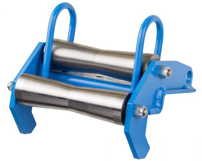

Corner guide cable rollers would be what is used on the rear of a trailer. you can fab the mounts and buy the hardened rollers or buy the whole thing. These do not accommodate side loads.

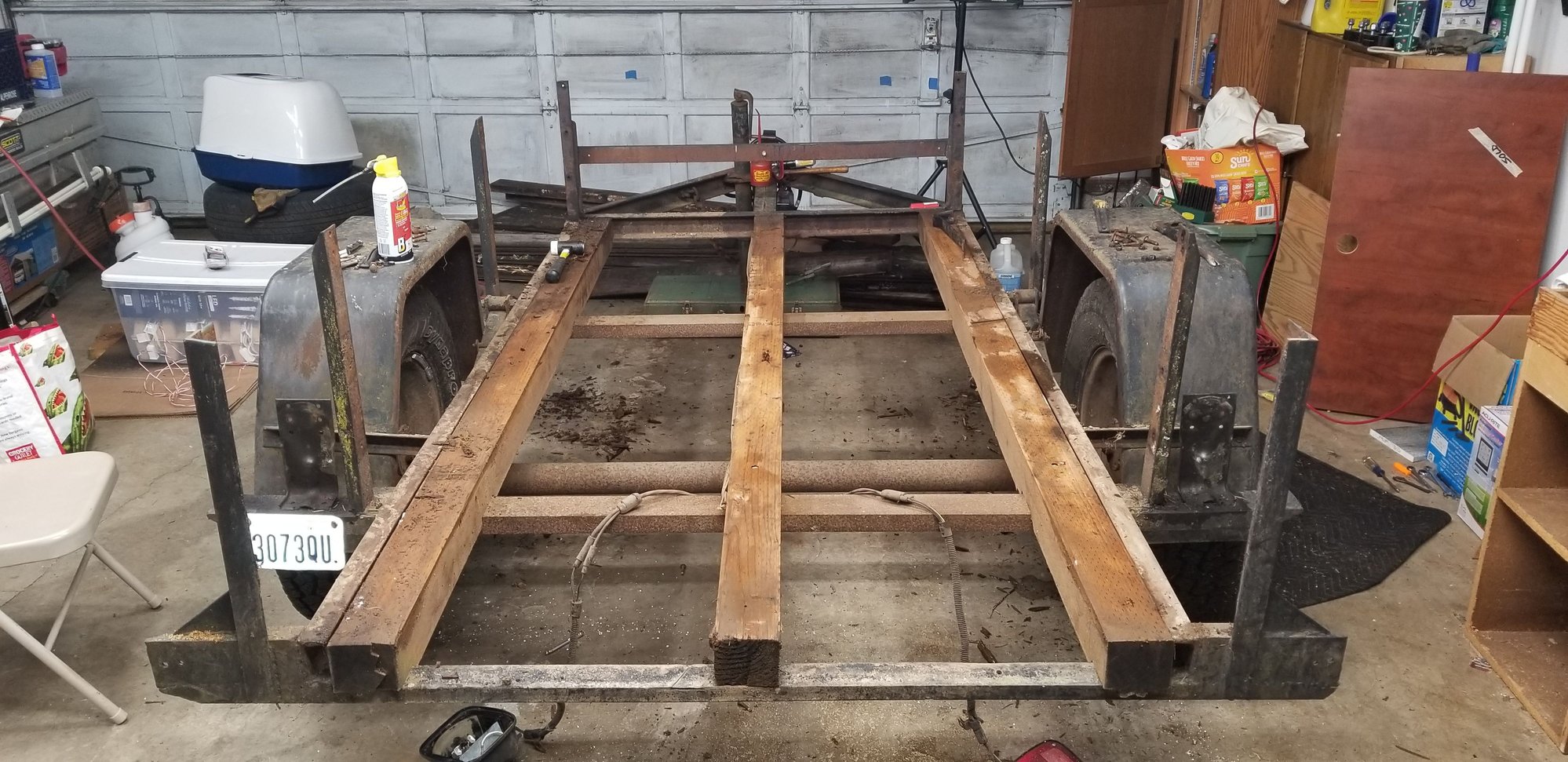

I have a utility trailer that i want to put a winch on. I was thinking the same about winch height.
The difference for me is that i want pulling power up. Reason is i will be lifting log rounds that i can't lift myself.
I want to build a mount higher than my side walls.
Here is what i am working on. The height of the wall will be just short of 4'.
