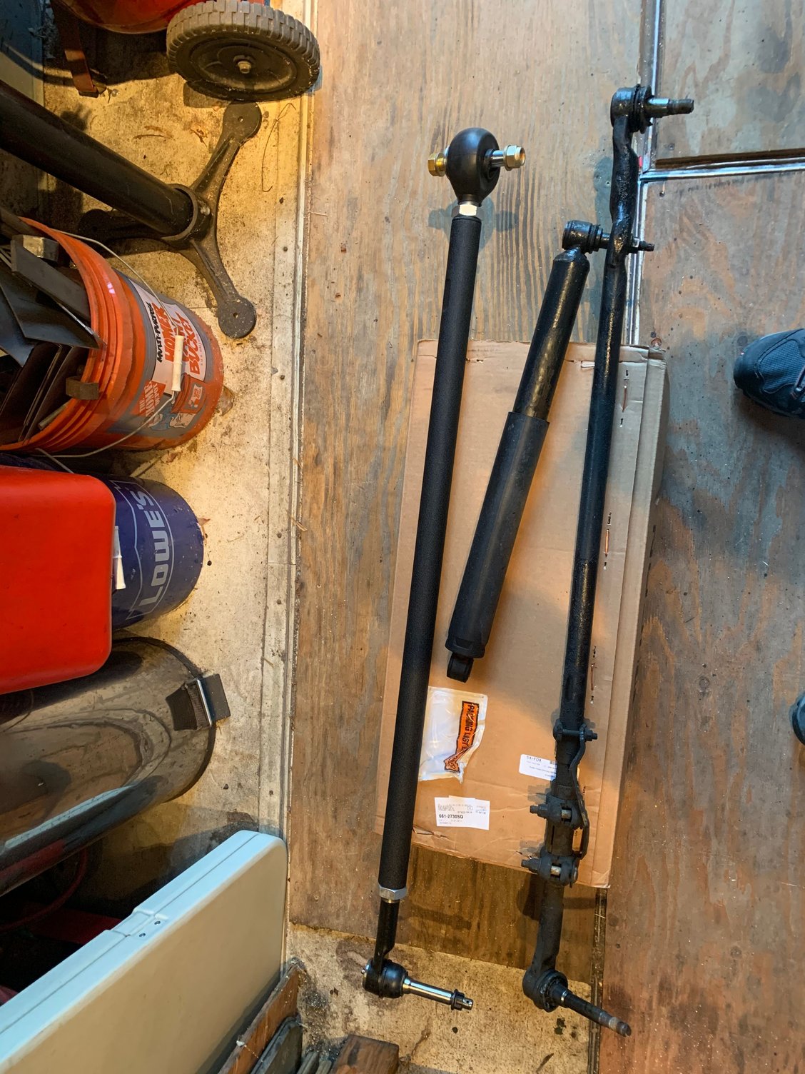

If you want a real upgrade, check out PMF. Just installed their Draglink over the weekend, super beefy. Have their adjustable trackbar as well and it’s awesome.
OEM vs PMF.

I’ve been mulling that PMF drag link. Did you have a bit of slop in your OEM drag link? I see you went with the heim joint. It’s not a castle nut so does it lock in some other way? I like to know my steering linkage isn’t going to let go at an in opportune moment!

The oem draglink was definitely starting to develop some play, the knuckle side joint was getting sloppy. I did go with the FK heim, it is SUPER beefy and extremely stout, easily double the size of the oem joint. PMF machined the joint down to taper into the pitman arm like OEM, and they supply a grade 9 bolt with a friction lock nut. I added a little locktite for added security, but after threading the nut on i can see there's no way its coming loose unless you put a socket on it. Threads on hard until its tight. Definitely tightened up the steering greatly. I highly recommend it, solid upgrade.

Was road feedback increased with the PMF drag link? I’m considering one. Are there any negatives?

I have not noticed any more feedback. It would be the same as the OEM joints on the draglink as there should be zero play, solid as the PMF. Now i did notice at first a "wandering" feeling, or slight feedback. I talked to Trevor the owner of PMF and he said drive it a little, the FK joint is VERY tight and will break in. Sure enough after a day of driving and properly centering my steering, all was good.
OEM vs PMF.
Where would the stabilizer go?
Or do you not run one with that drag link?
