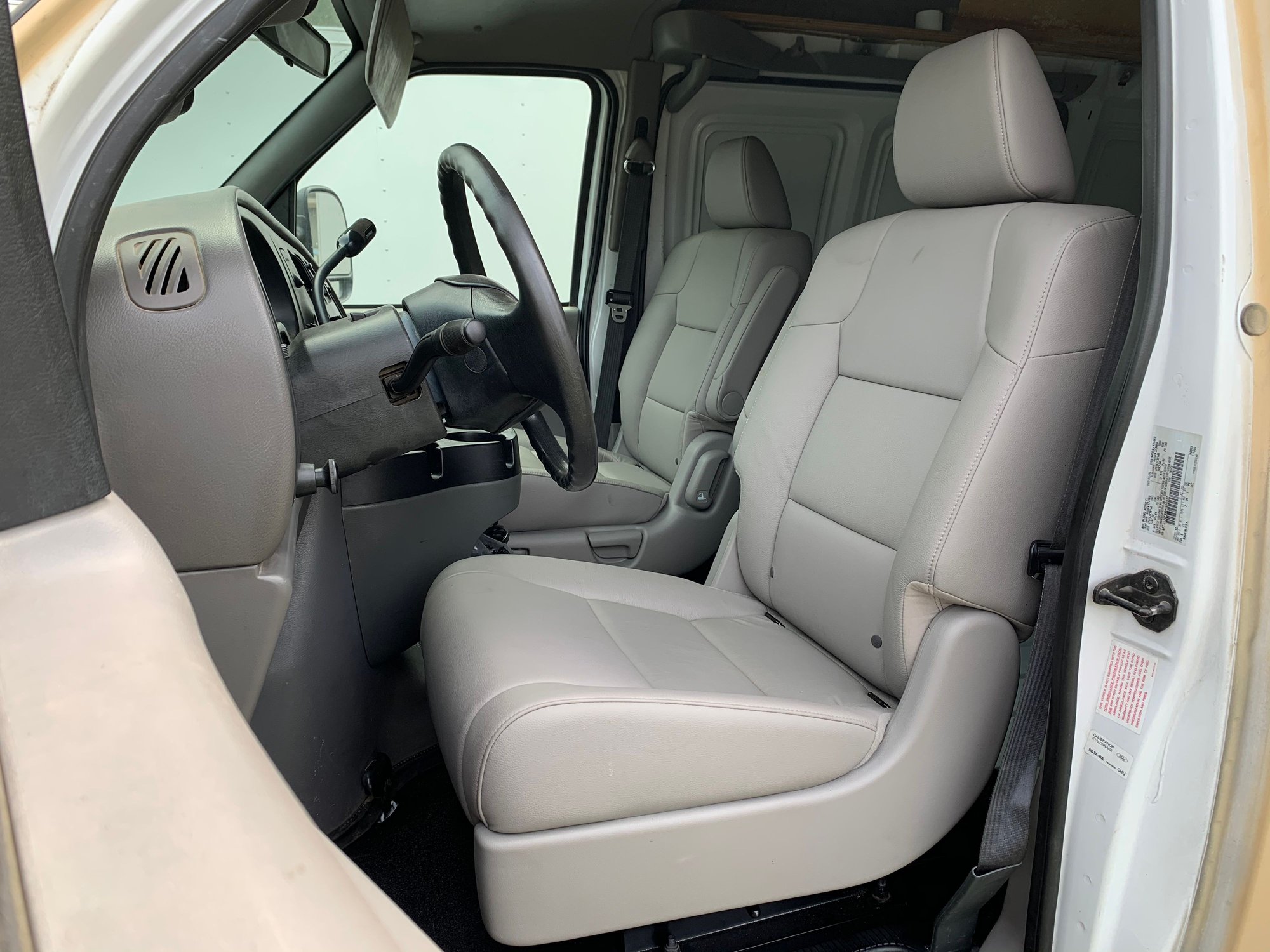

As for the van, it’s a home-brewed build using parts from U-joint Offroad and Weldtec Designs. Chris @ U-joint sells the suspension lift (6”) and 4x4 conversion pieces, as well as the front bumper. The rear bumper is Weldtec, and the tire carrier is my own concoction. I rebuilt both a 2004 F-350 D60 front and the van’s original FF D60 rear with Eaton True-Trac diffs and Dana-Spicer 4.10 gears. My buddy who is sponsored by Toyo got me some of their 35x12.50” M/T’s. I added a 12,500 lb Warn winch and seats from a 2014 Honda Odyssey (on Sportsmobile swivels).
I actually still need to finish the 4x4 conversion. The stock 2WD transmission needs to modified to accept the t-case (not a lot of room under the van to run a divorced unit). And the interior is still just empty stock cargo van, but I’m planning a full build out. I’ll keep you guys posted, but if you have Instagram check out @ExcellentAdventurevan where I’ve been posting the build (including the before pictures).

WOW!!! I LOVE that conversion and those seats are beautiful. I am going to hit you up on Instagram right now....

Thank you. I’ve wanted to build this van for several years, and, I’ve been in process on it for almost two already. It’s really a “dream rig” for me, and it’s really exciting to have it far along enough to actually get out and drive it a little while I’m finishing it up.
