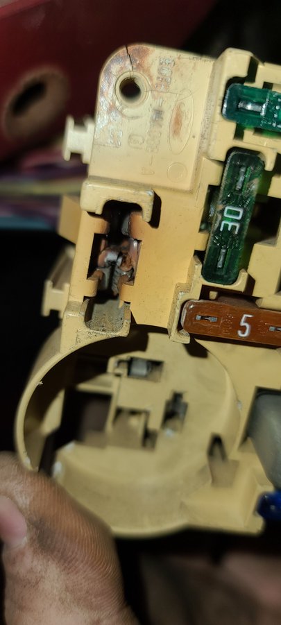

Think I have it figured out. Looks like it got very hot and destroyed the connection at the fuse block. #13 is open so I may just extend the wire and move it to 13 until I get a new fuse block installed

I’ve never seen that before. I wonder if the blower motor is bad: was drawing a lot of amps and burnt it up?
