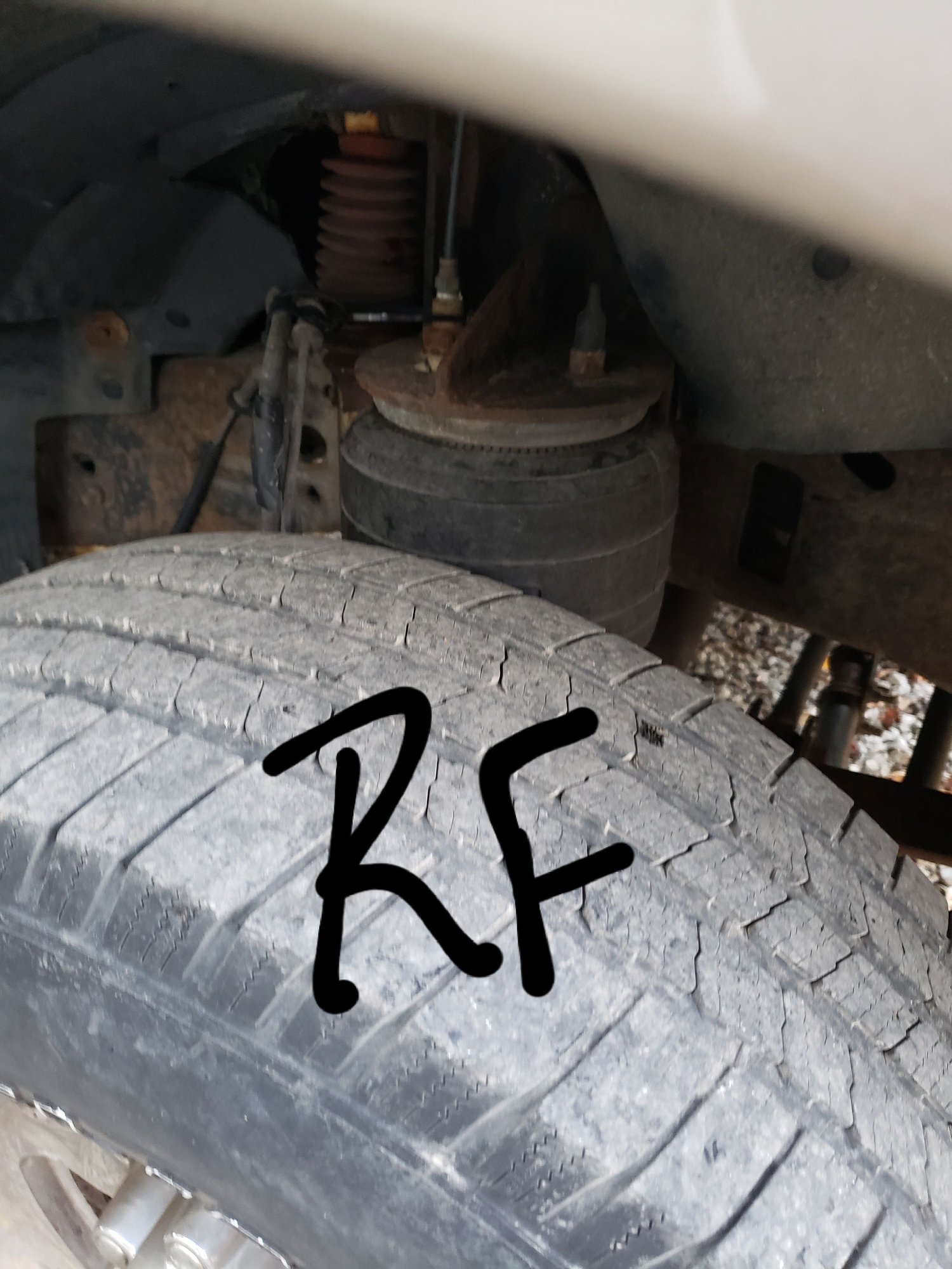

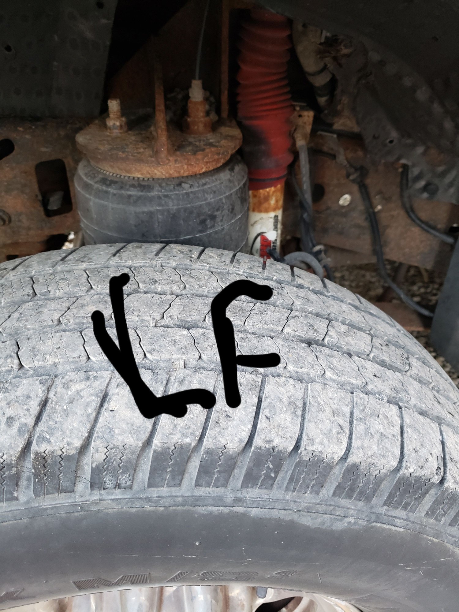

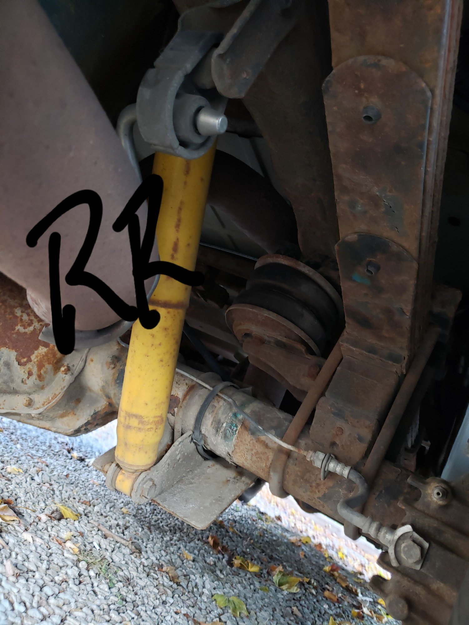

I'm still trying to figure out why someone put air bags on the front. Op, can you post a few pictures of all four of your air bags please?
I would not recommend relying on bags for an everyday lift.

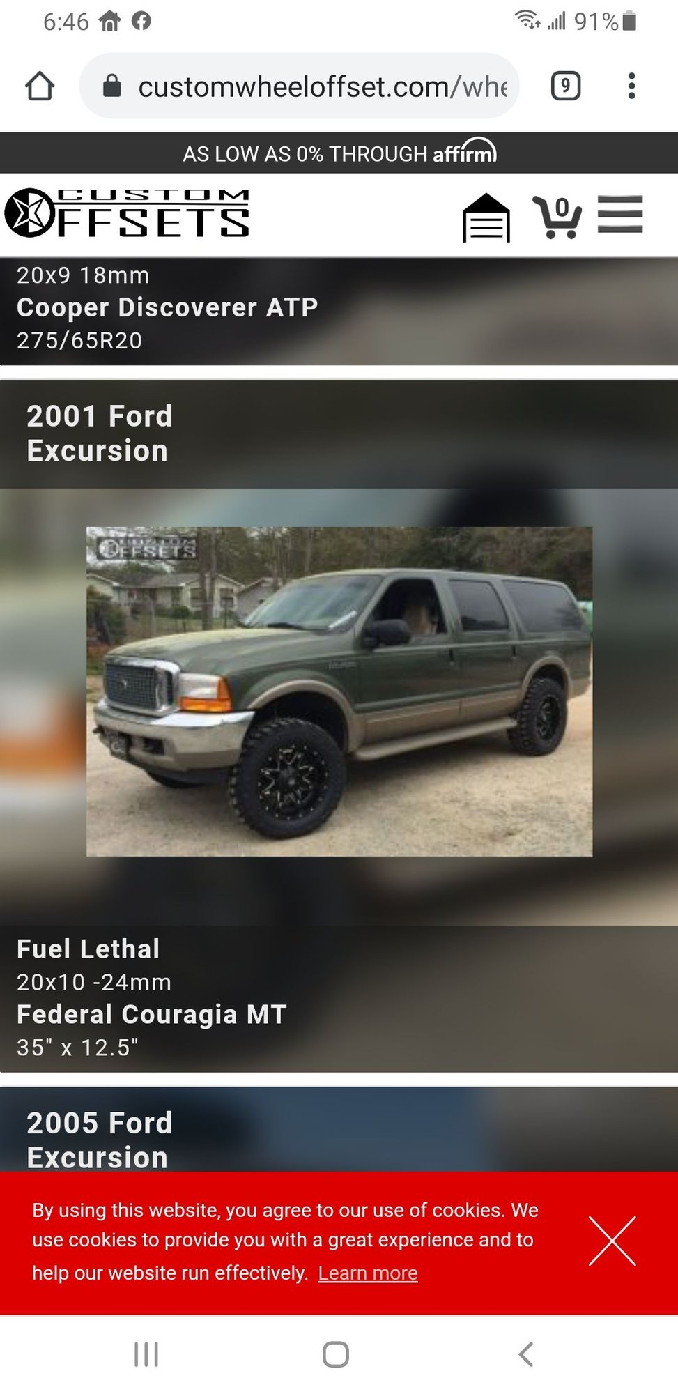

Since I posted this I found customwheeloffset.com. There are tons of pics in there with different Xs on different size wheels/tires. All of them list offsets also. I really dig this look, but probably will not go 35s on this set of tires.
Yes, soon as the sun comes up Ill snap some.
There is an on board compressor to run the rears. Fronts I have to do manually. When I bought it the pressures were 65/55 front/rear. The lady liked sitting up high. Truck bounced all over the place. With the steering wandering like a priest through a boys choir it was an interesting 2 hour trip home from the seller's house. 1st thing i did was drop pressures to 25 all around.
Obviously, real suspension upgrades are preferred, but its tires or suspension right now. Fronts are almost bald and winter is coming. Tires win. Bags can hold me up higher until the slush funds recover. Plus, I need this thing to work right now. Having it down replacing broken rusted parts from removing old parts is not an option. Spring/summer i can do it right. I just need to clear the tires until then.
