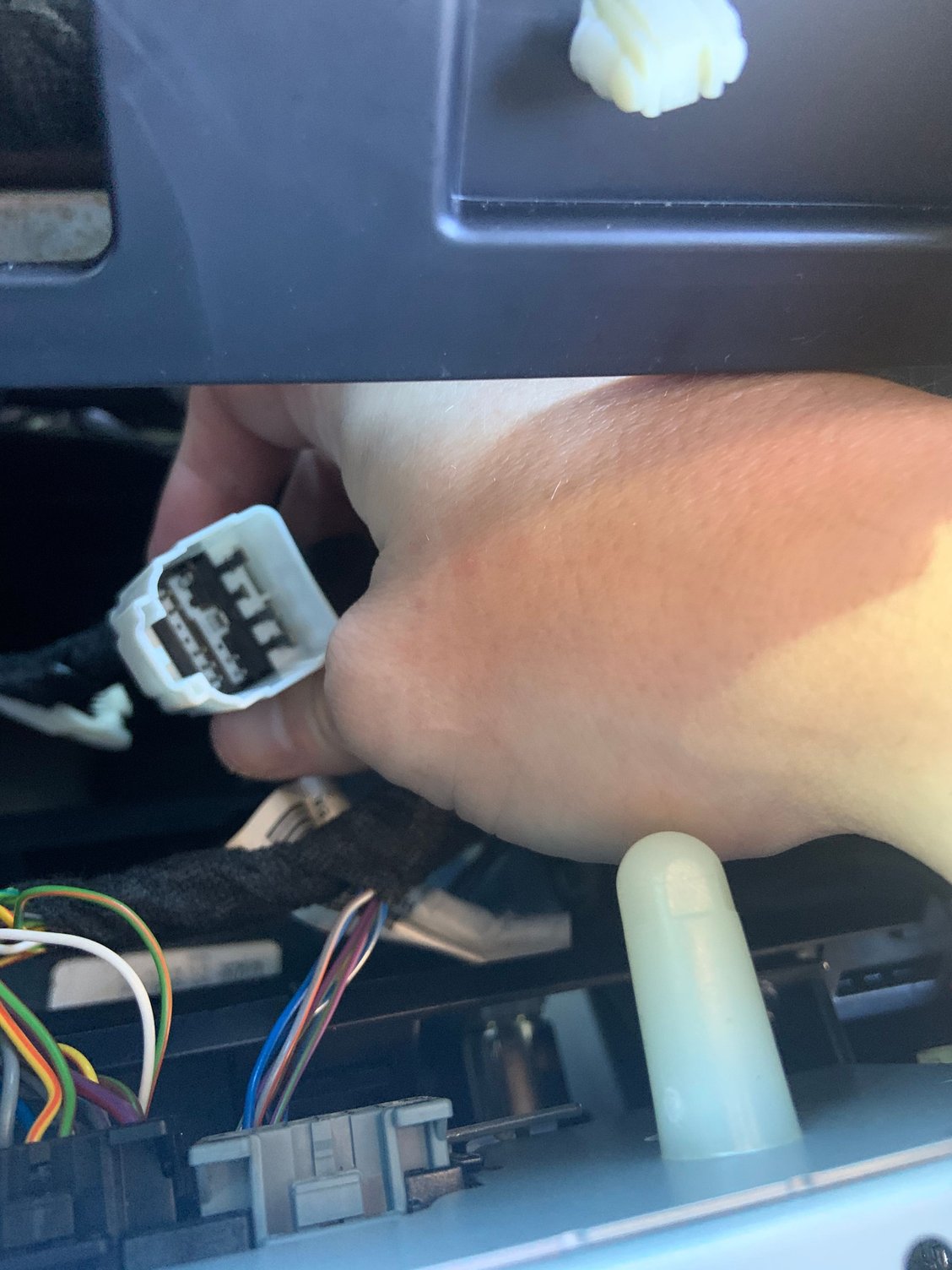

So I did find this plug coming out of my dash. I believe this is the harness that plugged into the console.

You're missing power to the media hub and maybe the USB cable isn't plugged in the correct spot (I'm not sure where the USB cable is going). The last picture is potentially the right one that connected to your console, if so here is the pin out (although probably not useful):
Pin Circuit Gauge Qualifier
1 CRT36 (BU-GY) 22
2 LME89 (YE-BU) 22
3 VLN04 (VT-GY) 22
4 RPK07 (GN-OG) 22
5 VPK07 (BU-GY) 22
6 RME89 (WH-BU) 22
7 GD214 (BK-BU) 22
8 VDB29 (GN-BU) 22
9 VDB30 (WH-GN) 22
10 VLN73 (GY-BN) 22
11 VLN04 (VT-GY) 22
12 * *
13 GD214 (BK-BU) 16
14 CBB29 (WH-VT) 16
15 CBB35 (YE-GY) 16
16 * *
17 GD214 (BK-BU) 16
Here is the pin out for the actual power needs that you're missing:
1 LME89 (YE-BU) 22 CTRL MOD. - MEDIA CONNECTIVITY POWER
2 * * Not Used
3 VLN04 (VT-GY) 22 CTRL MOD. - IP/SWITCH ILLUMINATION
4 RME89 (WH-BU) 22 CTRL MOD. - MEDIA CONNECTIVITY GROUND
4dtech has a harness you can buy that powers from the factory radio, not sure if links work, but search for "4'' TO 8'' PNP USB HUB POWER HARNESS FOR SYNC 3" that has the power adapter for the media hub. Probably cheaper ways to get power to the hub.
