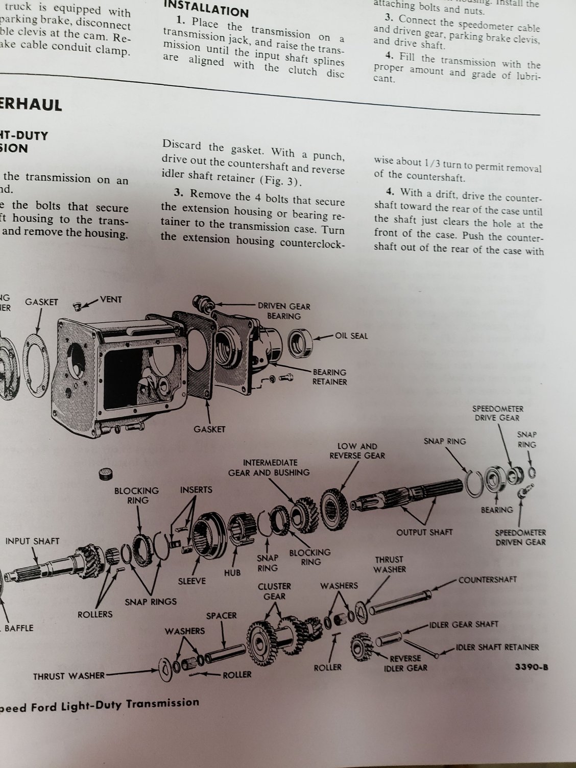

Hi there i have a 1958 ford f100 the speedometer is not working the cable broke shortly after i bought the truck i replaced the cable and now the speedometer gear that goes on the end of the cable will not stay on the end of the cable and keeps falling into the transmission is there a reason for this as it did not do this when i bought the truck any help would be great thanks

Not to sure on what trans you have. Is there a clip to hold it on? I'm sure someone will have your answer

Here are pics of t98 from f100 and dirty pic of three speed od.

I did not realize you could separate the part where the speedo gear goes in from the rest of the trans i also have a 3 speed manual trans in my f100 is there supposed to be a block that prevents the gear from falling in? if so is it possible that mine has lost that block?

Sorry the separate part is rear housing if four speed. I have not taken the three speed apart. Looks like cable is held by a bracket and bolt and gear housing unscrews.

the speedometer cable housing or at least the sleeve end has been changed on mine so there is no clip to hold the gear onto the cable any idea if the 3 speed has something that prevents the gear from falling into the extension?

What condition is the one on the main shaft? My bad if this double post. First one never went through

No, mine is the four speed. Mine screws on.

here are some pictures. Shop manual for three speeds with and without overdrive and pics if the driven gear from an old three speed with overdrive. Can you see in the hole with driven dear removed? Maybe drive gear is worn or damaged? Completely different than my four speed. This three speed was attached to a 239 y-block so likely from a 1954 car so may not be the same.

with the gear removed you could look in if the trans is removed from the truck with it being under the truck not quite enough room to look in the speedo gear and sleeve end looks like the one in the pictures although my gear just sorta sits on the cable nothing holding onto the cable i have thought of gluing the gear onto the cable but would rather fix it right i will try and have a look to see if i can tell if the gear inside is worn

No idea. I only have the transmission by accident. It is nothing like the t98 in my truck.

Oh ok I will eventually have to take the transmission off the truck to get the speedo gears out again i hope this time will be the last time taking it off so far i have it off twice this will be my third time I believe seems like it has become a yearly thing
