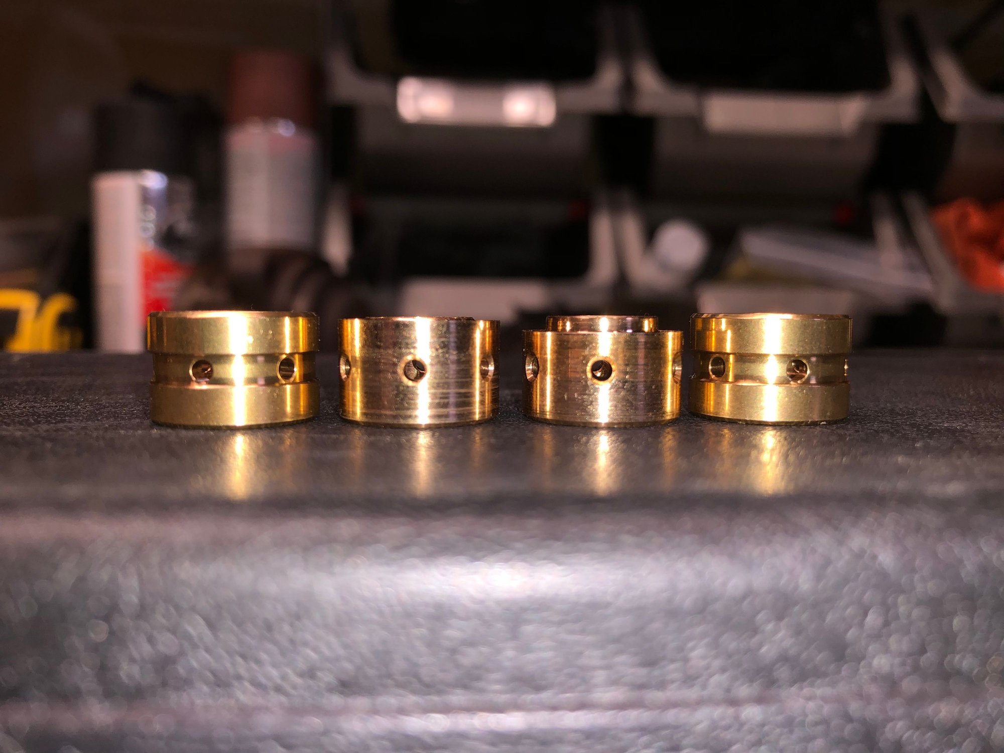

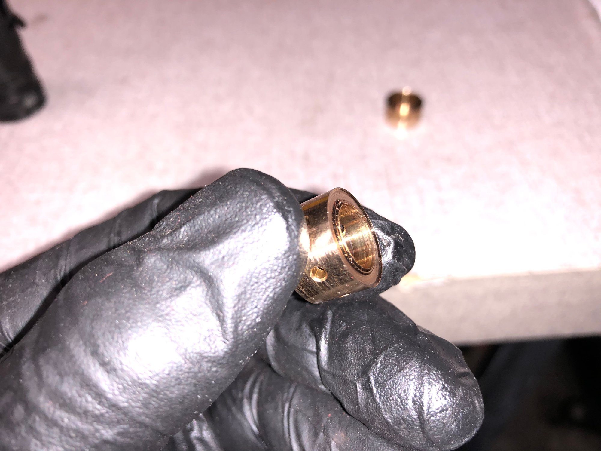

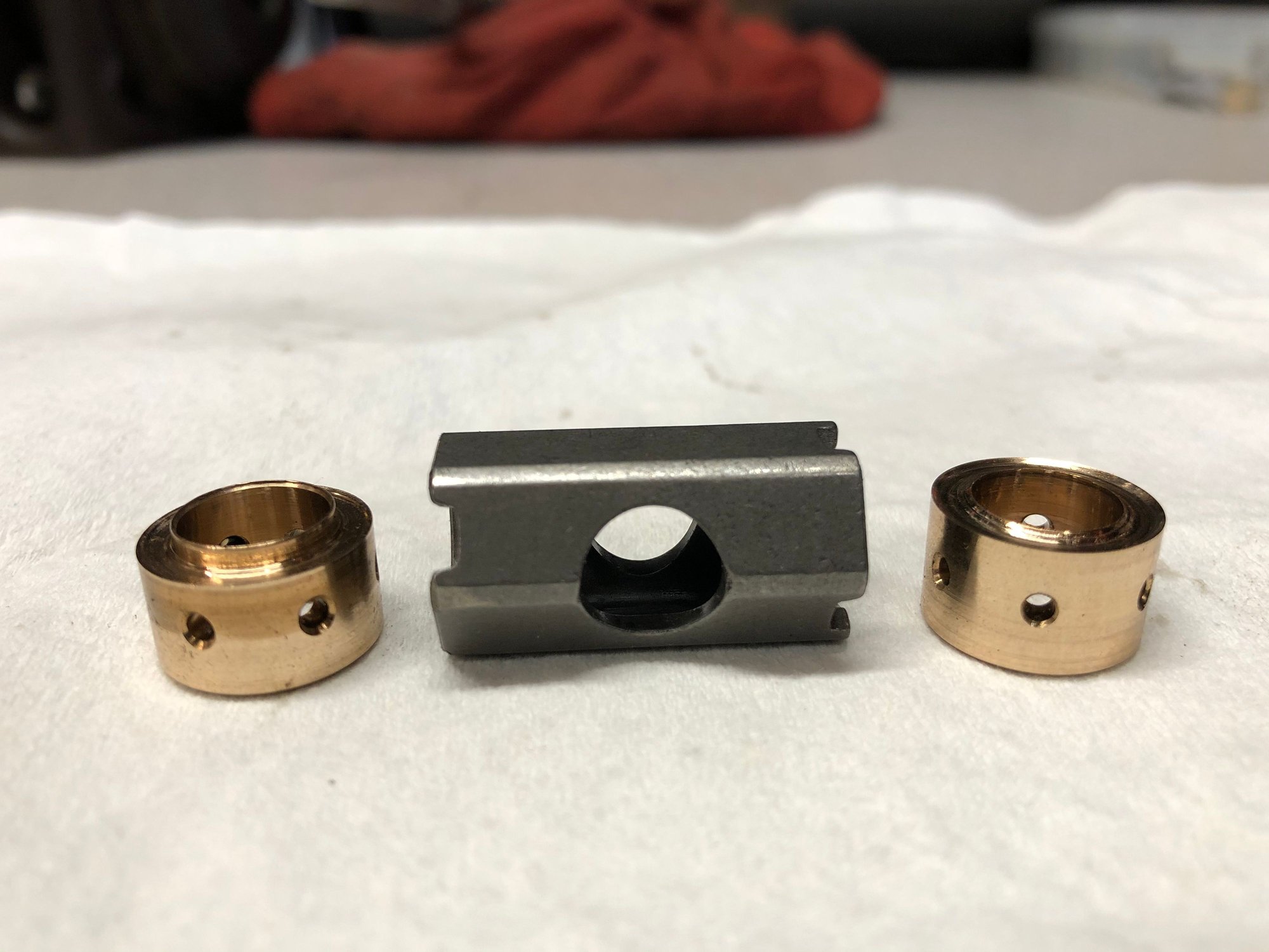

Turbo teardown results are:
(side to side) in the turbo shaft (no in and out play whatsoever - seems like there should have been after I saw the bushings?)
damage to the inside ends of both brass bushings (one worse than the other)
Close up of bushing #1
Close up of bushing #2
One more pic here of the two new bushings on the outside and the two old bushings in the inside.
Guess that's about it - fixed the problem and the new wheel defiantly builds boost different.. ..maybe better? I didn't push anything too hard on the test drive but it did build boost at at a lower RPM and once it started it shot up faster too. My boost gouge actually went up to 22psi (maxed at 20 psi with previous wheel) and that made me smile for sure. If your truck sounds like mine did - time to check the turbo bushings AND REBUILD

How did it not have any in/out play?!? Glad you got it fixed. Any idea what caused the wear? It appears your new bushings also have a slightly different design.

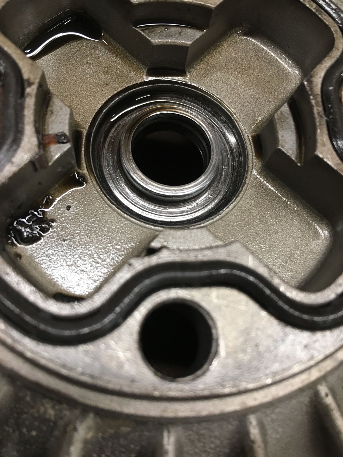

Nope that still has me wondering. 17,000 miles seems like an early failure to me? Everything looked good on the exhaust side, the shaft, as well as all the aluminum housing for the turbo. If I had to say one part that did concern me slightly was the backplate for the turbo housing had some signs of wear in the center hole. No doubt that could have occured when the turbo was "vibrating" on spool-down but it was minimal and I went on with the rebuild it was so minor. The collar that went into that hole seemed to fit correctly although some play was noticeable (side to side) and I do not know if that is normal or not? All in all at the end she seemed tight and very little side to side play once the wheel was spun on and torqued to 10lbs - MY UNDERSTANDING OF THIS (small amount of side to side movement) IS THAT WHILE THE ENGINE IS RUNNING OIL FILLS THE SMALL GAP AROUND THE BUSHINGS AND THE SHAFT/BUSHINGS ESSENTIALLY RIDE ON A THIN FILM OF OIL AND THIS IS THE INTENDED DESIGN - please correct me if I am wrong.
Yes - I think this is part of the 360 deg. rebuild kit. Looks like a better design all around. The Thrust bearing was also a different design. (See below from SP Turboost)
360 degree thrust system:
"The advantage of a 360 degree thrust bearing is that it has a full circle of lubrication, and an updated pad strategy to better disperse oil where it's needed. Most of the performance diesel turbochargers are running with this kind of set up for durability and longevity. Along with the improved journal bearing design, you will get a much better oil flow versus the conventional 270 degree thrust bearing."

This was the wear on my dad's when I rebuilt it. Had to purchase a new backing plate. Funny thing is he was driving it with no issues and I found on a completely random check. His had lots of endplay.
