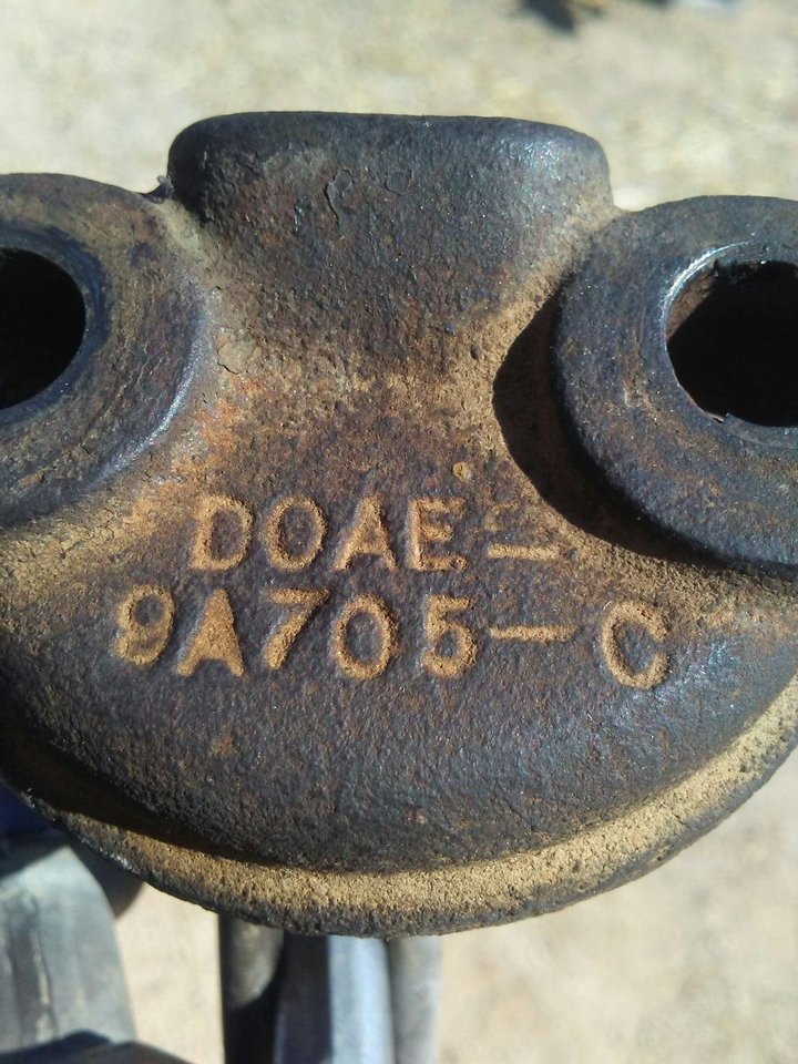

Can you identify this part?

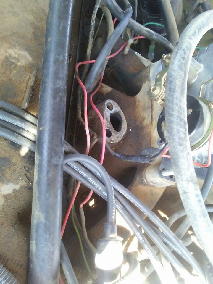

This part is mounted into the intake manifold on a 73 Q code 351 cobrajet engine. As you can see from the last photo it is located just under the carburetor on the passenger side of the engine. It is leaking air but when I removed it there was no gasket between it and the manifold. I think that the coil inside the manifold may have a leak also. I don't know what to call this to get a gasket or will I have to make my own? The engineering number on the part is D0AE-9A705-C. Thanks for the help.
I think the coil may have a leak.

That is the hot air assist for the choke. There is supposed to be a tube that connected into the choke housing to supply heat. It appears someone has converted it over to electric choke only.

Thanks for that info, I had never heard of this before. I will close it up and see if I can stop the leak. Les

The original chokes had hot air assisted choke pull off system. I don’t think the electrics came until late late 70s. I believe they make a block off plate for it. It looks like the wire feeding the choke has the good old twist together and tape splice. I’d give that a check and proper fix if needed.

I have heard them referred to as a "choke stove".
