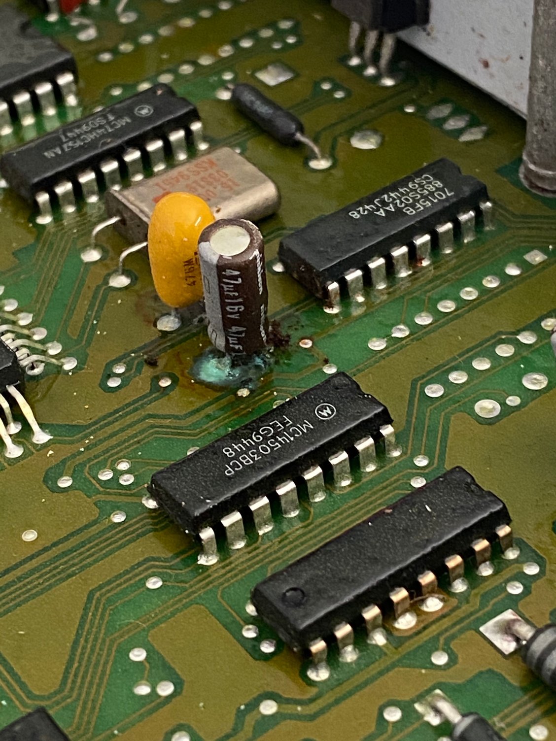

I'm not sure I follow your explanation, but if it were me, I'd visually inspect the EEC-IV for leaky capacitors. And I'd pull the vacuum line off the fuel pressure regulator - make sure no gasoline in there.

I’m not following that logic. Why would a bad switch require a new pedal assembly? Anyway, that means that computer is losing power which many or may not be related to your problem. There have been a lot of computers failing over the last several years due to age. You could open it up and check for damaged capacitors. It is removed from the wheel well on a ‘95.

Well turns out it was a capacitor in the EEC, don’t have access to a used one out of a 94 same set up as mine till Saturday.
Will post results of the new used EEC then.

Hopefully the EEC change will fix ya up. I had a code 512 on my truck and while it ran , it ran like crap. a remanned EEC fixed it and wasn't hard to do. Then I set about checking all the sensors. Then went section by section on the truck and got her to where I was happy with it and LOVE driving my truck.
