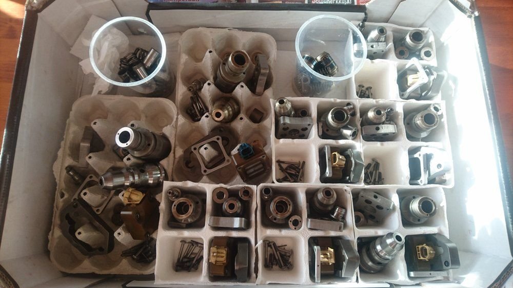

I scrubbed,brushed and washed/rinsed in off road diesel.
Fuel side assembly on kitchen table and oil side in the garage.

Originally Posted by FinnishStroker
I scrubbed,brushed and washed/rinsed in off road diesel. Fuel side assembly on kitchen table and oil side in the garage.
Can you adjust the torque on that box tubing?
