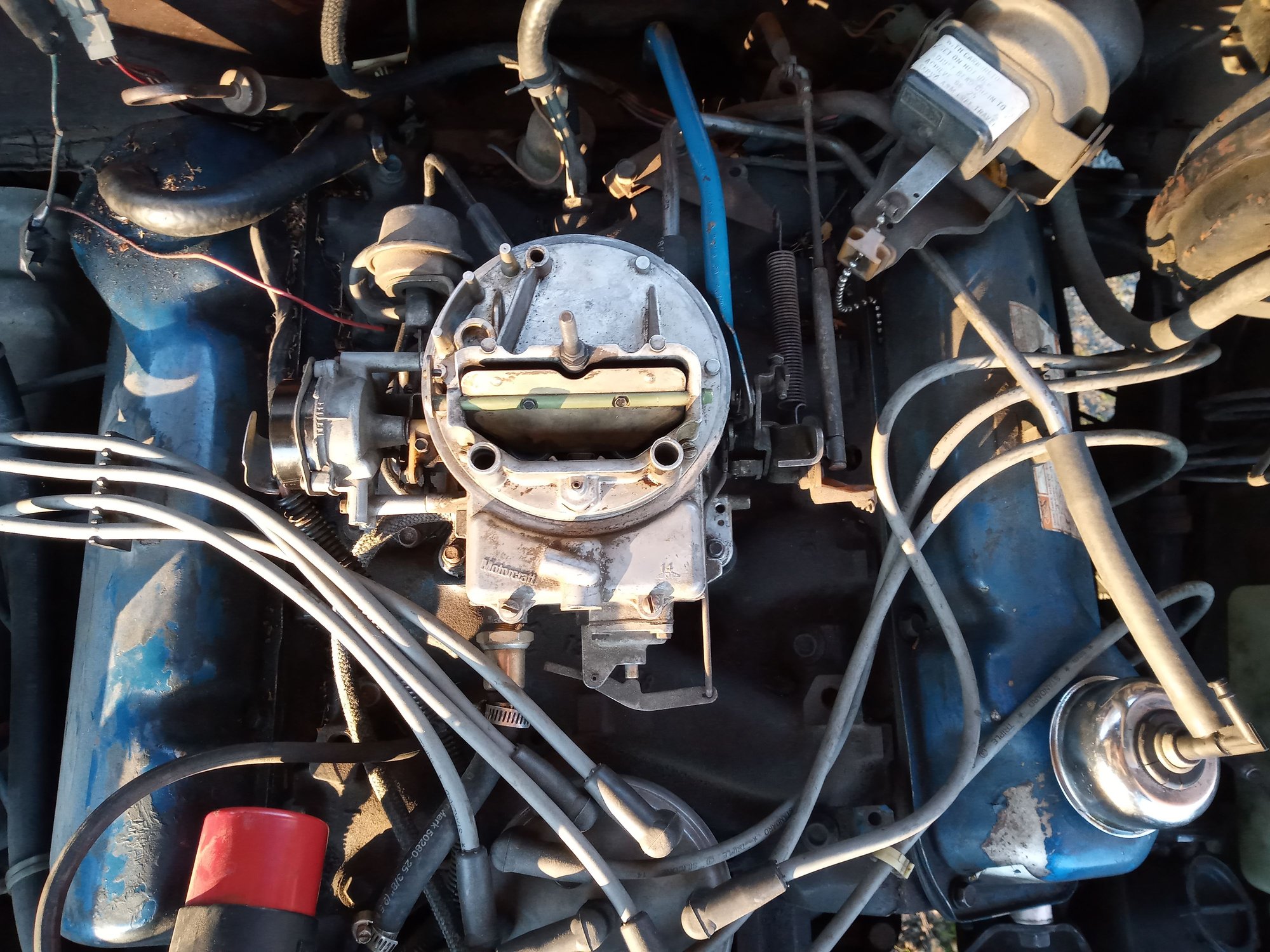

Found the vacuum gauge. It was steady at 20 from the front of the intake at idle.
I am wondering if these vacuum lines are routed correctly. Does anyone know where I can get a diagram?
This picture is at operating temperature and the butterfly is still mostly closed. If i open it all the way, it will die.
I am loosing some vacuum at the crank case vent from the big hose at the back of the carb and one from the intake to the air cleaner. Are these really necessary?
Old Oct 26, 2020 | 11:46 PM
Tedster9's Avatar
Tedster9
Joined: Apr 2002
Posts: 19,311
Likes: 97
From: Waterloo, Iowa
OK a steady 20" on the gauge indicates (among other things) that it should idle crisp and smooth. This simple test covers a lot of ground for anyone following along out here in the cheap seats.
The ignition timing must therefore be reasonably close to factory spec, or it would never pull 20" vacuum. So, you're good there. You did mention in the OP the "carb was rebuilt about a year ago".
Was that something you know to be a fact (as in you did this personally) or, is this something that maybe the previous owner of the truck claimed right before the sale, or?? See where I'm goin' with that?
Somebody mentioned checking for worn throttle shaft. This is one of the very few DIYer show stoppers with these particular carburetors. It might be worth trying another known, good carburetor, but I would resist buying another carburetor, at least for now. One reason being simply because it's better to learn how to service and setup a carburetor and learn how they work.
Buy a good rebuild kit from Mike's Carburetor or somebody like that. Use your vacuum gauge to measure fuel pump pressure output. Takes about 5 seconds and then you know for sure. Make sure the output volume of the pump is in spec too.
Download the Autolite carburetor manual and study it, and disassemble, clean and inspect the carburetor carefully. Could also have missing parts like checkballs or the wrong parts, defective parts, etc, all kinds of stuff.
Carb cleaner sold in gallon buckets used to be powerful stuff, and it would make them gleam, but it has been banned. All those tiny orifices and air bleeds and such inside the body of the carb have to be free and clear or it will never run right. If the carb is full of corrosion and crap, the alloy pitted and porous, throw it away because it probably can't be cleaned. Pay particular attention to the float, needle & seat, float height spec and "wet" float height spec, meaning check the fuel height in the fuel bowl after it's actually installed on the motor.
Maybe the carb is toast by now, but I doubt it. Have to inspect it carefully to be sure anyhoo. If it's in good shape set it up and adjust everything by the book. This is impossible without the shop manual, at least for a novice. There ain't no other way! Ask me how I know.
Once a carburetor is setup correctly, they should last a long time without any attention. Maybe the idle mixture can be tweaked between winter and summer along with the accelerator pump shot. The proof of a good sharp factory engine tune will always be good easy starts, smooth power and very clean burning spark plugs.
Also focus on Ignition itself, a lot of "carb problems" are really defective Ignition. It needs to be a good fat HOT spark at all times, especially under load and at speed.
