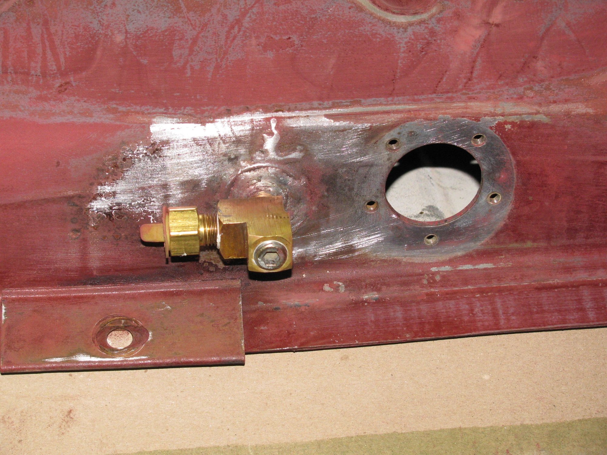

The pick up and the fuel sender are separate parts. The senders are reproduced the pick up is not. The pick up is spot welded then soldered to the tank. The shop manuals tell how to trouble shoot the sender and gauge.
It is possible to replace the pick up tube but it is more than a little work. I converted my tank and lines to a 3/8 inch. By drilling out the 5/16 tube then silver soldering a 3/8 line to a brass fitting then screwing it into the remains of the original fitting and soldering it in.
