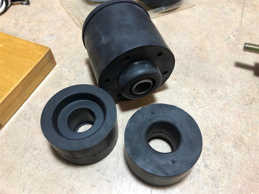

I went with the original OEM style replacement bushings on my '84 F150, purchased from LMC. They seemed to fit and work well. I actually just another set for a 1980 that I'm rebuilding. One thing to be careful of (if you happen to buy from LMC) is that there is a mistake in the parts listing. It was wrong two years ago, and it's still wrong today. The rear lower bushings are incorrect for the upper bushings...you need to buy the later ones for them to work properly. Just FYI.

Originally Posted by kramttocs
So you ordered 40-2009 instead of 40-2008?
Yes. I think it's just a typo, but the whole listing for the rear cab mounts is kinda wonky, and it's been that way for quite a while now. They show a year break for the upper cushions, but list the same part number from 1980-1996. For the lower cushions, they show a different year break, and different part numbers. In any case, the 40-2008 is the lower cushion for the cab front mounts, and the 40-2009 is the lower cushions for the rear cab mounts.
See pic below. That's 40-2009 on the left, and you can see how it's cupped to fit the bottom of the upper cushion. The 40-2008 is on the right, and obviously is not cupped to fit...therefore would leave a big gap between them.
That picture is from a couple years ago when I ran into this issue. This time, I only ordered the upper cushions since the lowers were still good, but I did check the catalog and it is still wrong.
PS: The LMC mounts seem pretty good to me. I'm more than happy with them as a stock replacement.
