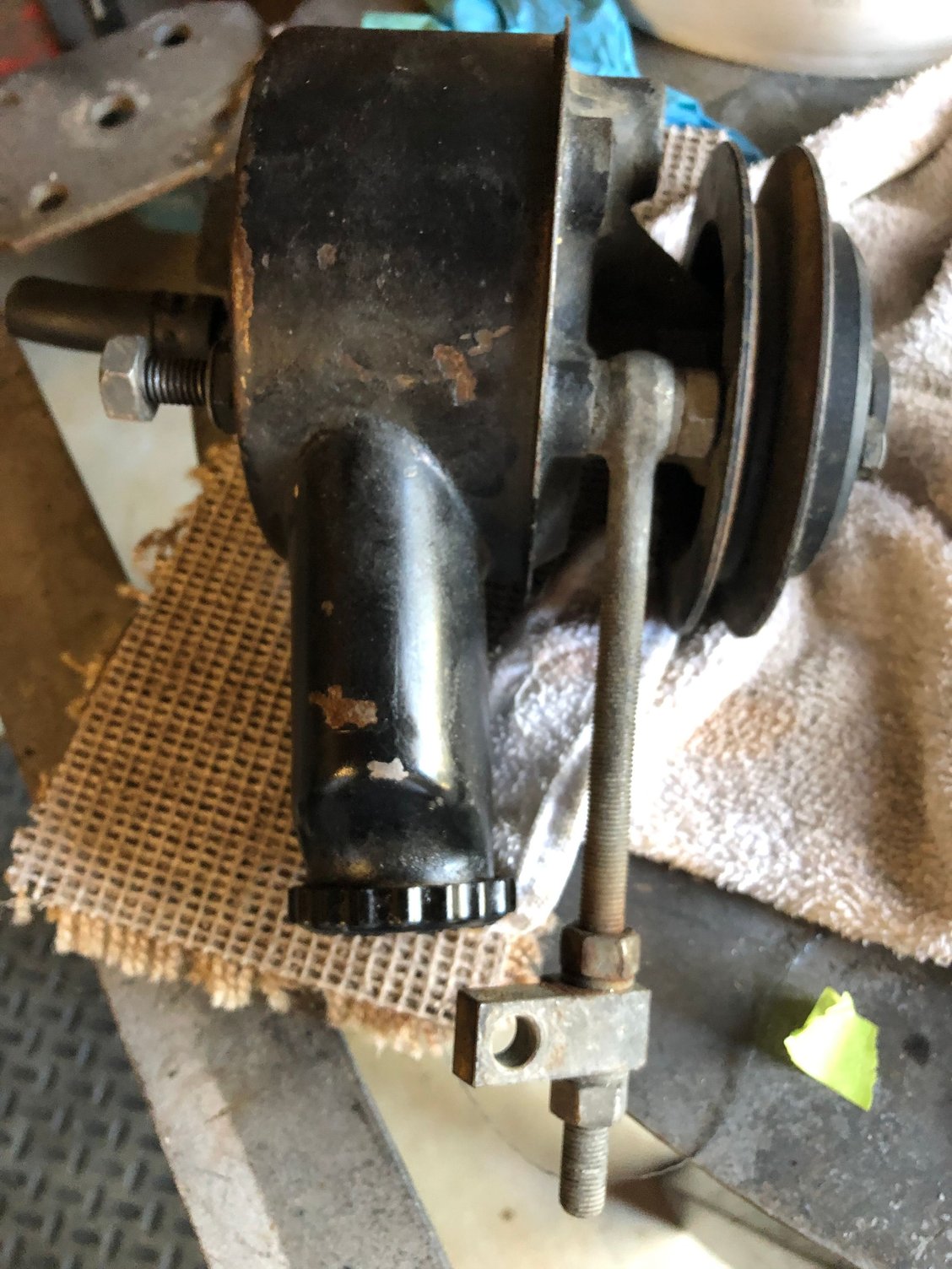

What engine are you using?
serpentine system?
mine is out of a 89 ford e250 (donor engine) Saginaw pump “Canned ham” I used some shims to reduce the pressure it is now one hand steering not one finger steering and it is every bit as big as the 87’ jag pump v belt system

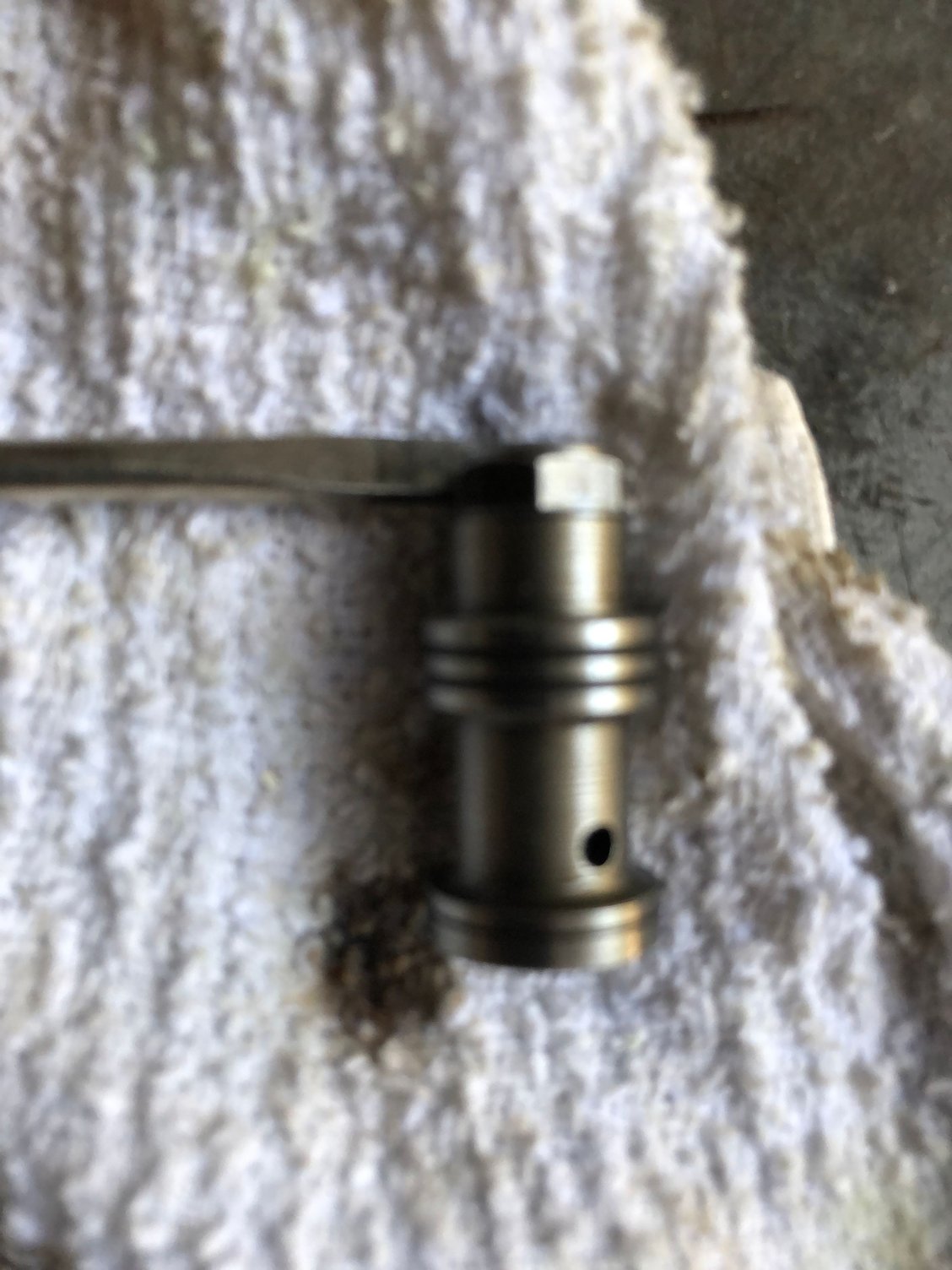

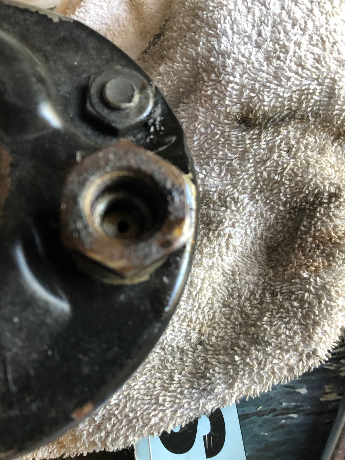

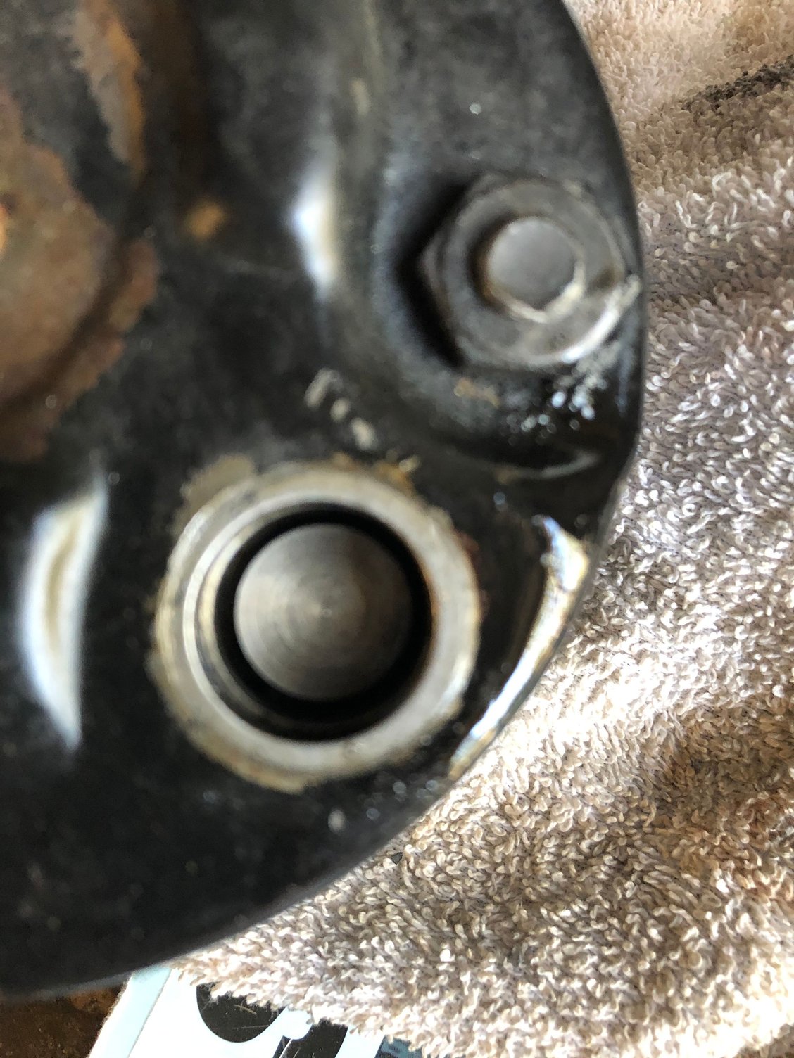

An OT addition for indybeer reducing pressure
remove this bolt on the output side
There is spring pressure on the bolt
under that is a piston
Out of pump
Top of piston in jag PS pump
i’ll do this in 2 posts
Old Oct 18, 2020 | 03:41 PM
schoo's Avatar
schoo
Joined: Mar 2012
Posts: 4,390
Likes: 44
From: placer county usa?
Lock nut on piston remove nut add washers from kit reduce pressure
Screw driver points to nut
Jag pump but ford canned ham is the same
