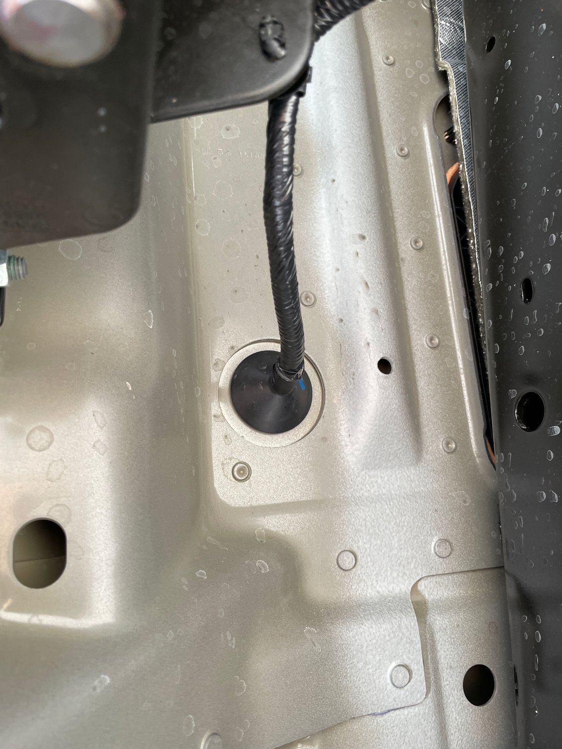

Originally Posted by docup!
Was there holes in the body to make it out side or did you route through the fire wall
I have the power running boards and just in front of the seat is a grommet in the floor.
This is inside the cab just in front of the seat. Wire is coming from the harness in the door sill.
This is the underside of the same grommet. I fished the wire through and just re-taped everything.
