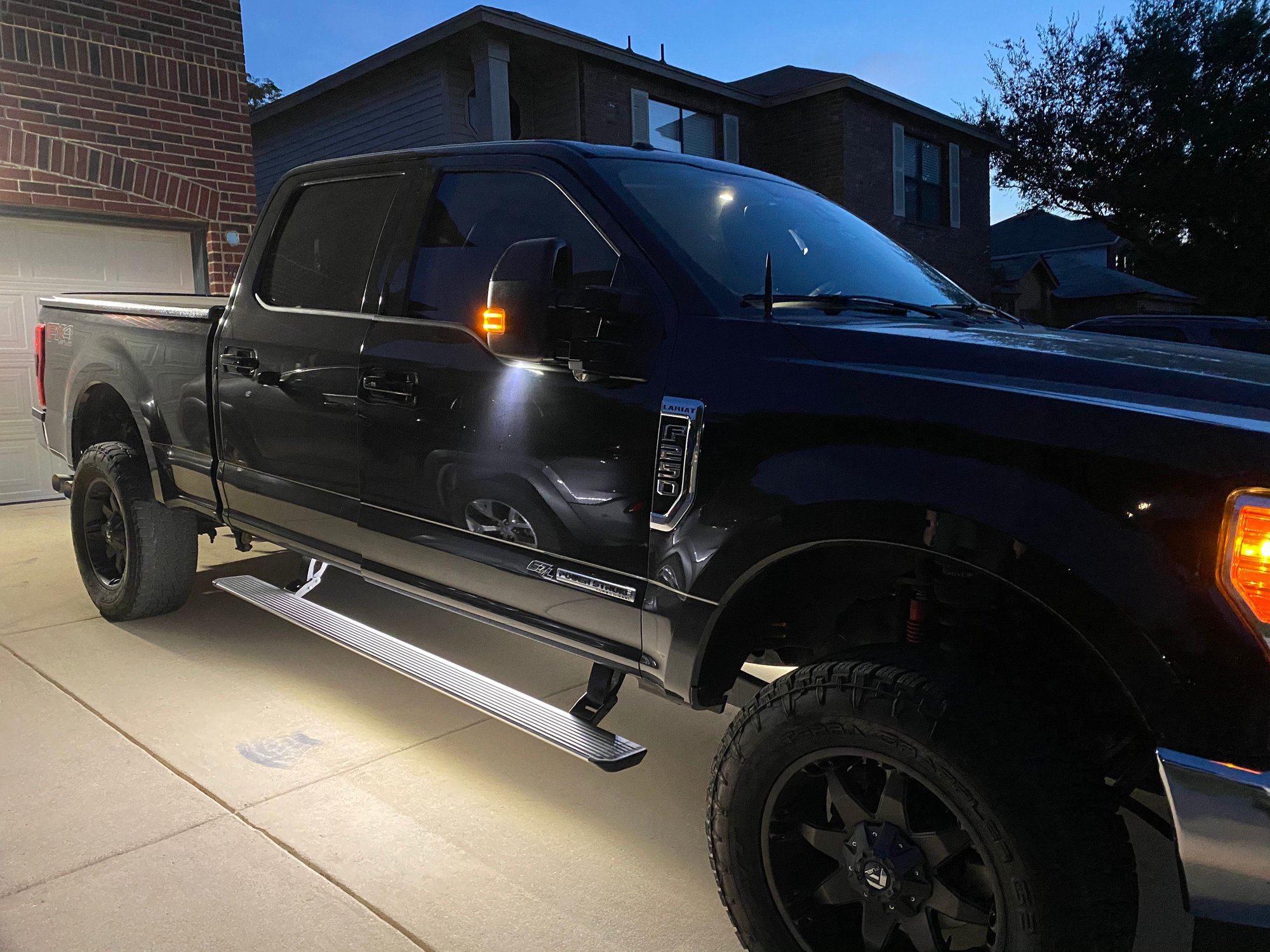

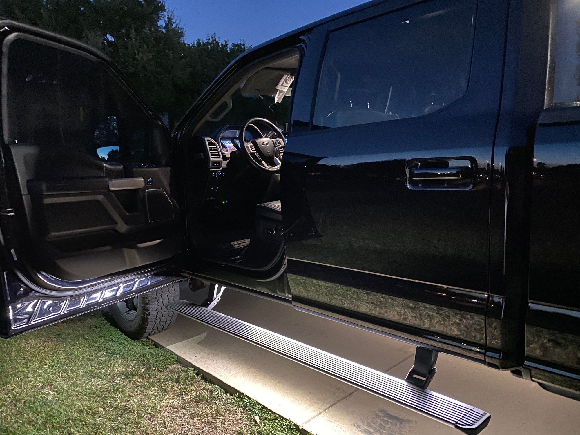

I have them mounted but I dont expect them being hooked up for a while.. here is where I ordered them from
https://www.t-toplights.com/product-...erproof-rating
I ordered 2 - 6ft /white....which should work good. If I did it again, I would order the 8ft ones..that would cover the whole underside of cab and cut the excess off. I will post pics when its completed

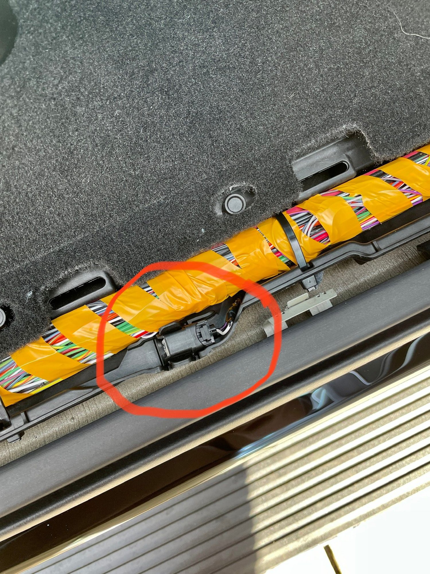

Did you check under the door sills? I have a 21 F250 Lariat Tremor with no plug on the frame rail but found them under the door sills.

Did you have to remove the door name plate where it say platinum (mine says that). My 17 had lit up platinum name plate the 21 is stamped. Could these wires be for that

Yes remove the sill plate. My 17 Platinum had the light up sills and the harness on the frame. I assume the harness is for light up sills but it works perfectly for the under cab led lights. Just installed them last week on the new truck.

does this same connector work with those plugs? I’ve seen discussion on the 20’s that they do not fit
