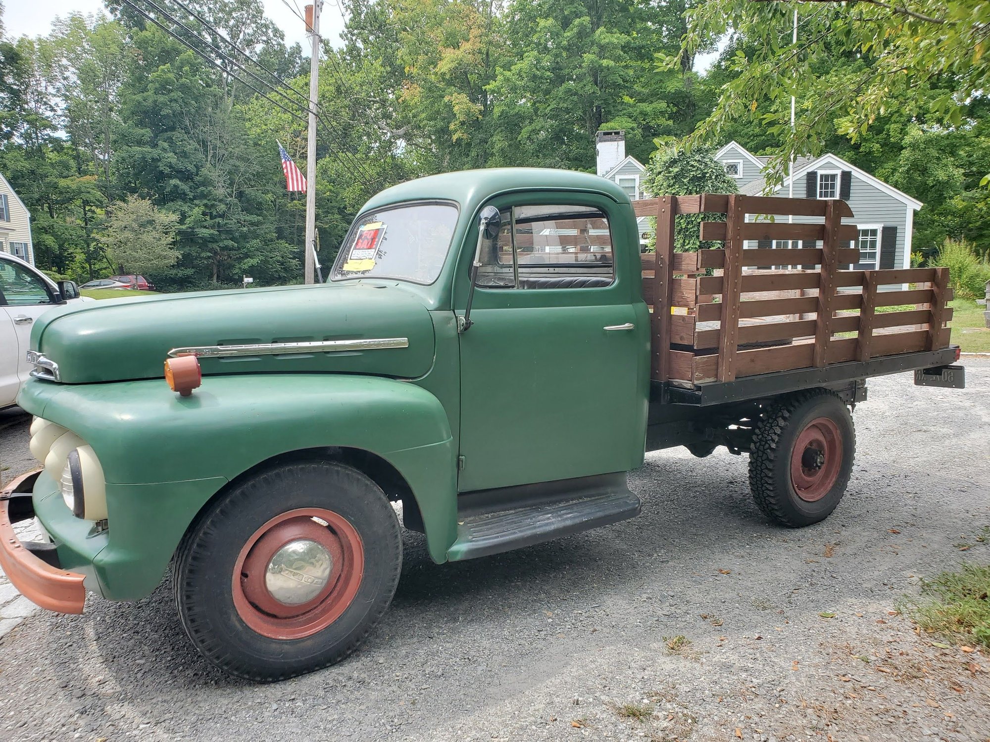

Good morning, I have recently purchased a new ford truck and am in need of some help. The seller said it is a 1951 F2 and the VIN says it is a 1952 F3 either one is fine with me I just bought it as a driver. Could anyone please help me verify what I have? I just want to be able to order the correct parts. thank you. John

As you mentioned, the serial number does show it to be a F-3. The differences between the 2 & 3 models was all about the rear springs to my knowledge. Engine components are all shared with the F-1s.

I believe brakes, wheels and tires are also different. Im thinking 51 because FORD letters are not on the front

The front sheetmetal is 51 as the guys have noted. Not unusual for pieces to have changed places after 70 years. Most people wouldn't know the difference.

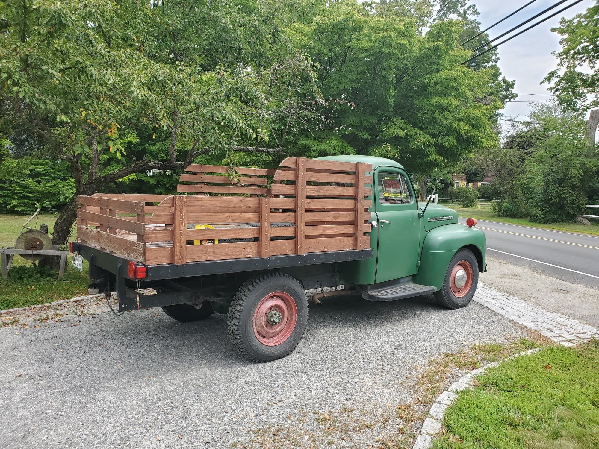

It might be a F2. Wouldn't a F3 flatbed have dual wheels?
On second thought it could have been a F3 express bed that was taken off and turned into a flatbed.

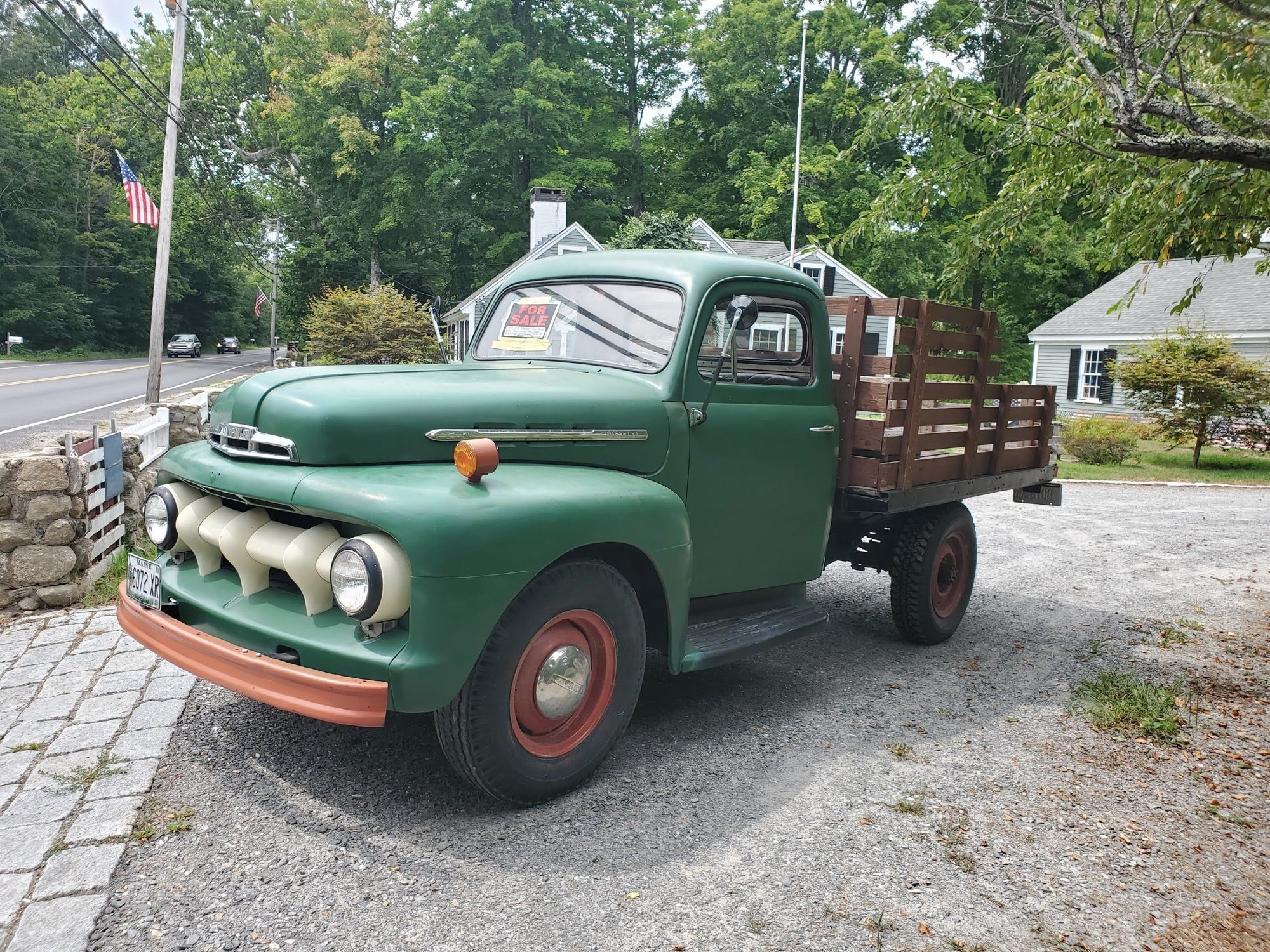

Thank you I was lucky to get it. I thought maybe a 51 hood on the 52 cab. I am new to this so I am not sure.

Could it be a 51 hood on a 52 cab?
