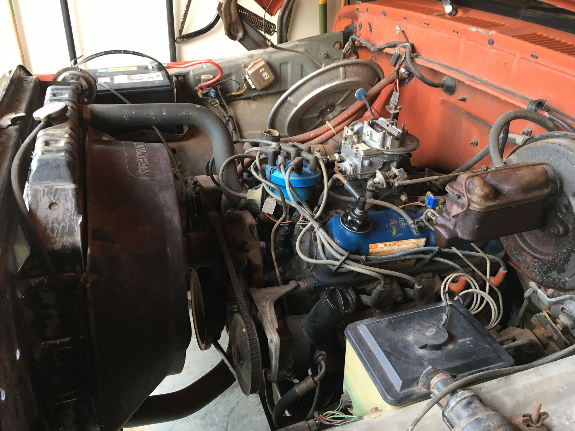

Hello. My son and I were looking to restore and old Ford truck and we found a 1978 F-150 Custom. It has the 302 V8 with manual transmission on the column. It runs, but doesn't idle very well. We are thinking it is just bad gas. We were told the gas in it is about three years old. One of the brake lines is rusted and leaking. We are in the process of trying to look at the brakes, but we are having trouble removing the brake drum. The body is in great shape and all the trim and lights and interior are in great condition, too.
