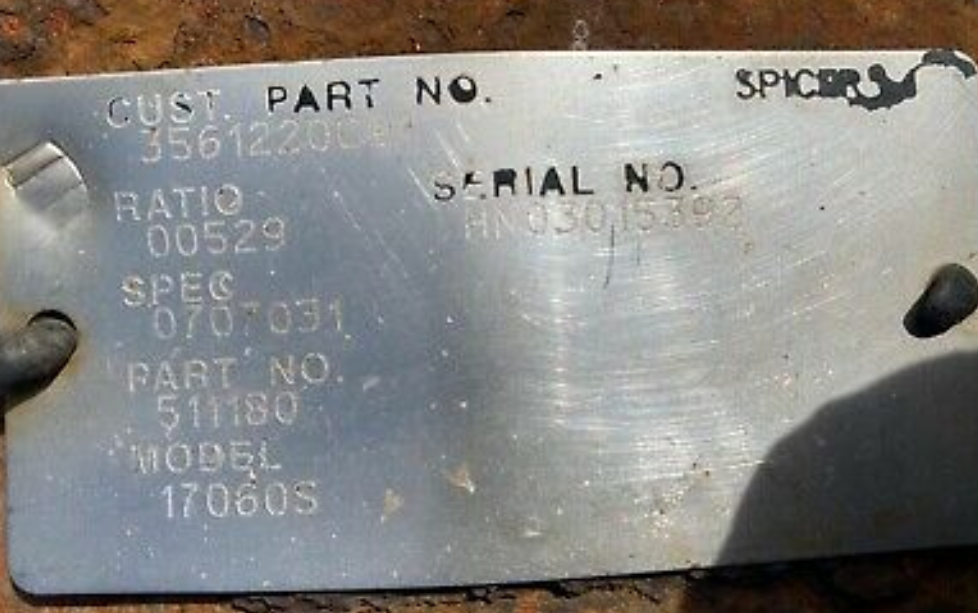

descending is not a problem, I have an exhaust brake installed, and the ALLISON AT 545 has a parking brake drum. the axle is a 17060S with Disc brakes, like the DANA 80.
