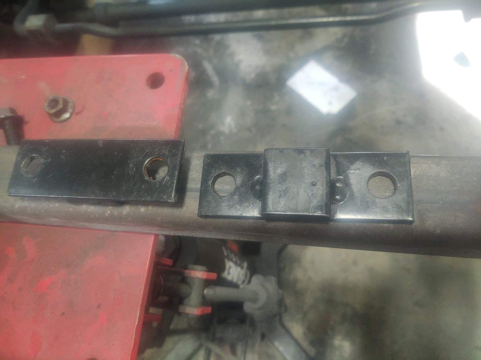

Need help identifying these two brackets please.
I recently took truck down to frame to clean and paint it, while repairing engine for burnt intake valve and damaged piston. I cant remember where these two small brackets go. I thought they went over/on top of the front sway bar bushing brackets that are welded on the frame. However the parts diagram does not show them there, and a similar truck at work does not have them there. Thank you, for your help, Brandon
Truck is a 2005 F250 4x4

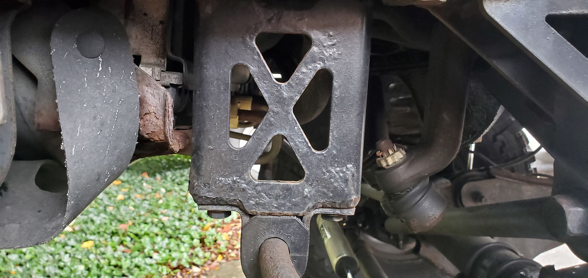

This is my 2007 F350 sway bar with a 6" lift bracket, but if you removed
the lift I can imagine that it went between the sway bar bushing and frame
going by the notch. Hope that helps.

Brackets are for sway bat.
Thank you OneTon350 for taking the time to send me a pic. I found out the bracket is part of my fisher plow bracket. It is an adapter for the sway bar bushing, as the plow mount also bolts there.
