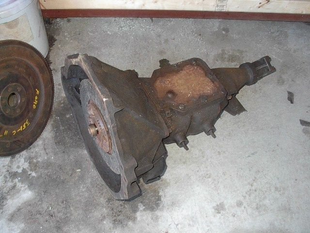

Bought a 49 F1 and this came with it extra. Was told it is a 4 speed BUT....I'm fairly sure it's a 3 speed. 9 bolts on top. Thanks in advance to all.

If you can find some engineering numbers and date codes cast into the trans and bellhousing, or metal ID tag, we can narrow it down a little more. My guess is it looks to be a 60's-70's Ford truck 3 speed trans, imho, based on the short stubby tailshaft, 2 shifter fork linkage attachment, and what appears to be a cast iron bellhousing in the small block bolt pattern. (which was also used on the 300-6)

on the trans c 2803000 cast numbers ORION
RAB6:2 CAST
on a tag..EEMD10 82
ALL I FOUND..THX
Supposedly came out of the 49 F1 I bought..along with a driveshaft
that looks like small block bell to me too

possible it came off a flathead 8 or go with an idea the truck was a 6 cylinder 3 speed standard.

RAB is a Ford 3.03 all synchro 3 speed, intro'd in 1963. They were found in almost anything Ford (and some GM) made with a manual trans as standard, or all synchrol 3 speed as an option. That is probably a '70s one.
No, the application is as stated above.
If it came out of a 49, it was because someone else put it there, behind something else. It's not original to any 49, and that bell housing will not fit a flathead anything.
