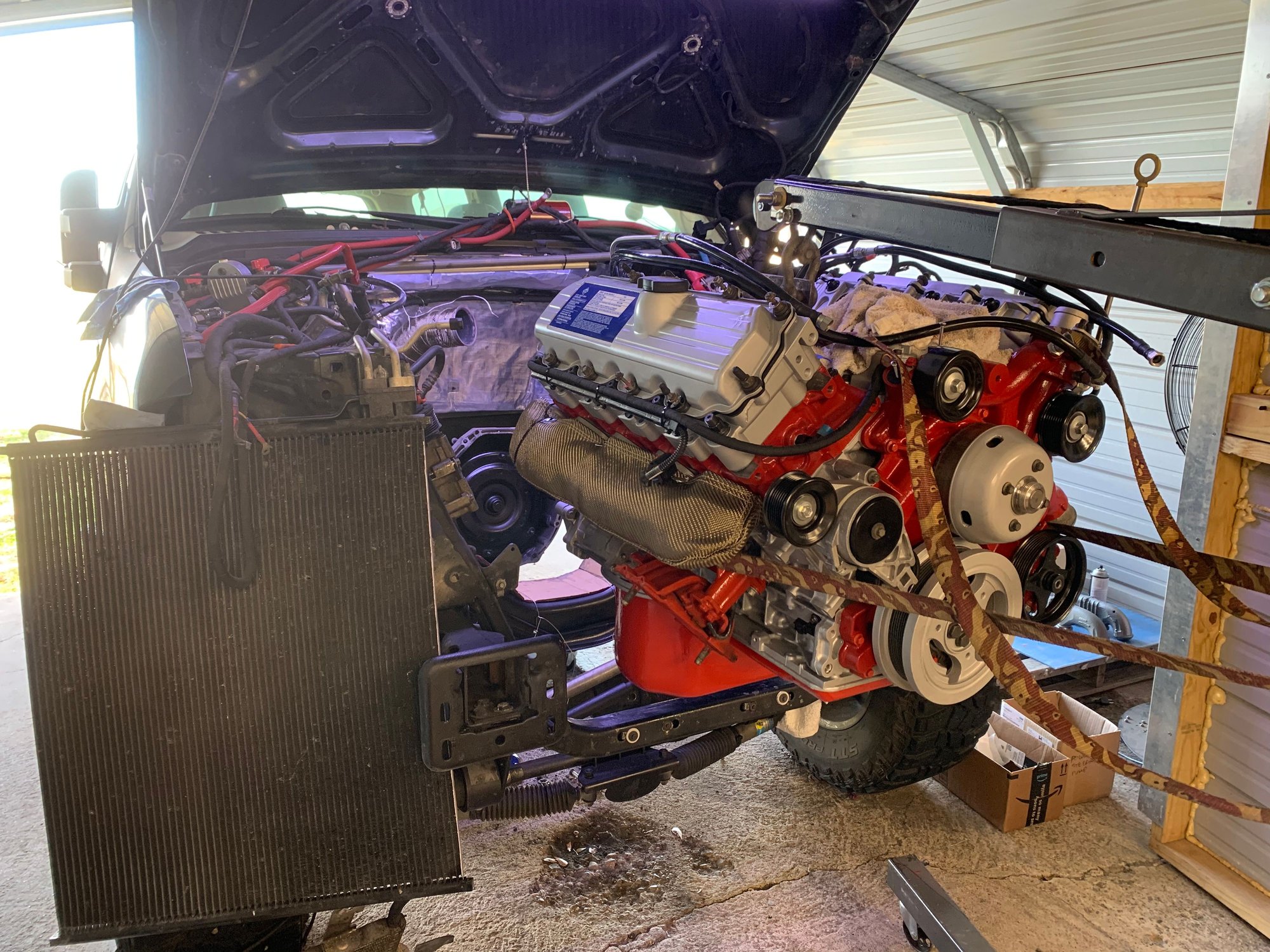

Yessir. I added an electric winch to mine similar to Jack’s but couldn’t bring myself to trust it to hold the engine so I just used a couple of clevises on the end bolt to get the arm as close to the pick plate as possible. Two ratchet straps from the lift to each engine mount and used them to adjust the angle.

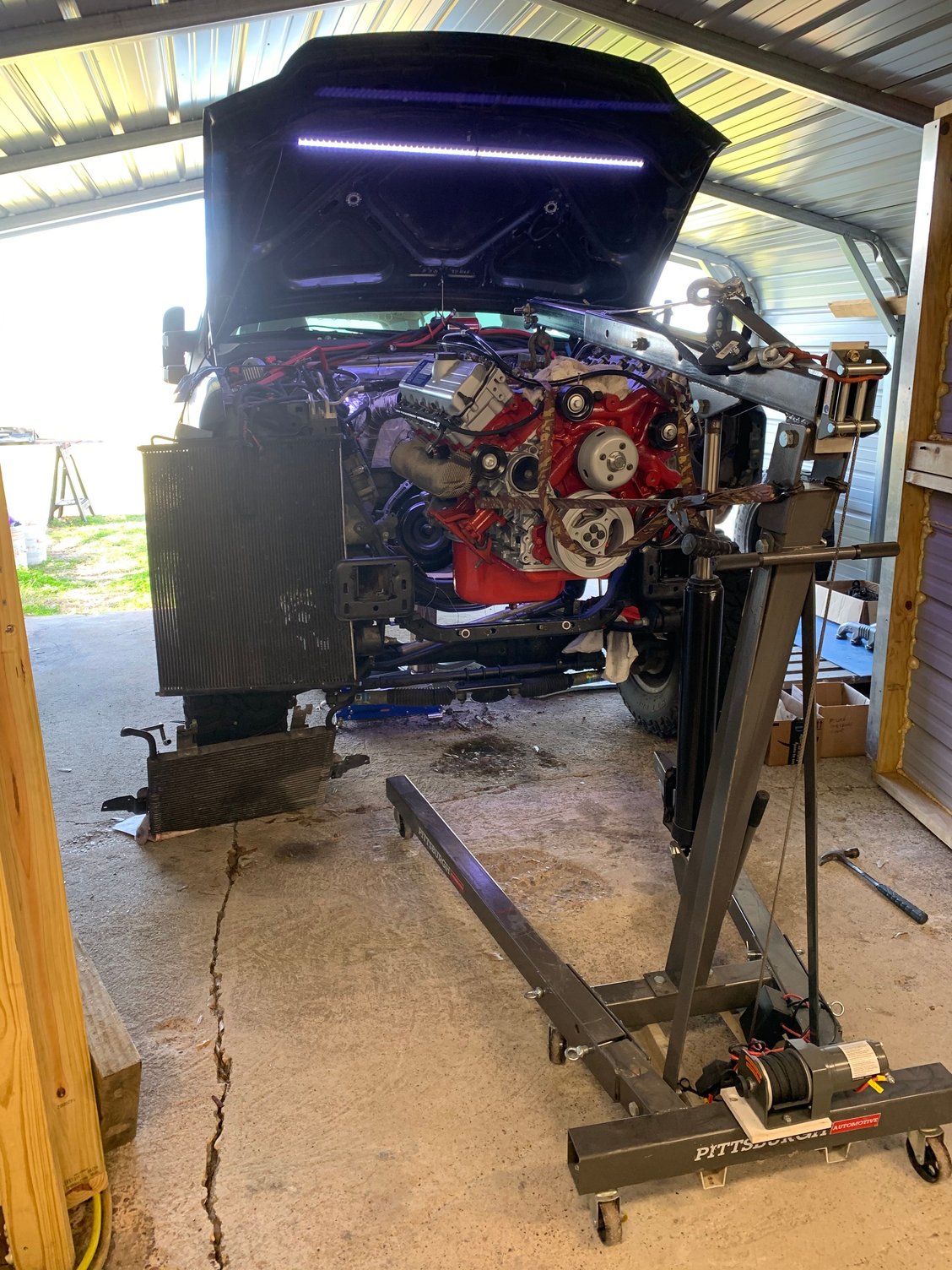

Picked it up from HB today. Worked fine on the 3.5 L engine from his Acura. Just a warm up for the real thing

Just check the welds before you put any body parts in a place where they might get crushed.
