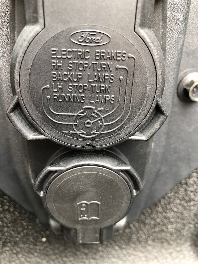

Hi, I have a 2020 F350 and a 5th wheel. When the trailer is connected I get a error in the dash when I go to use the right directional. It doesn't happen all the time and after the error pops up the directional will flash very quickly. I tested it and all lights work as this happens. I even replaced the bulbs on the trailer to make sure it wasn't that bulb.
Sometimes it even says Brake/Lamp Fault.
Is this something on the truck or is the trailer having the issue? I didn't have any issues with my previous truck and this trailer.
I tried the in bed plug and the one by the bumper, gives same results.
I don't want to haul truck and trailer to dealer if it is actually the trailer causing the issue. I haven't been able to hook to another truck yet to see if it is just mine causing the issue.
This truck also has the backup assist installed. I have not connected the cable or the yaw sensor yet.
