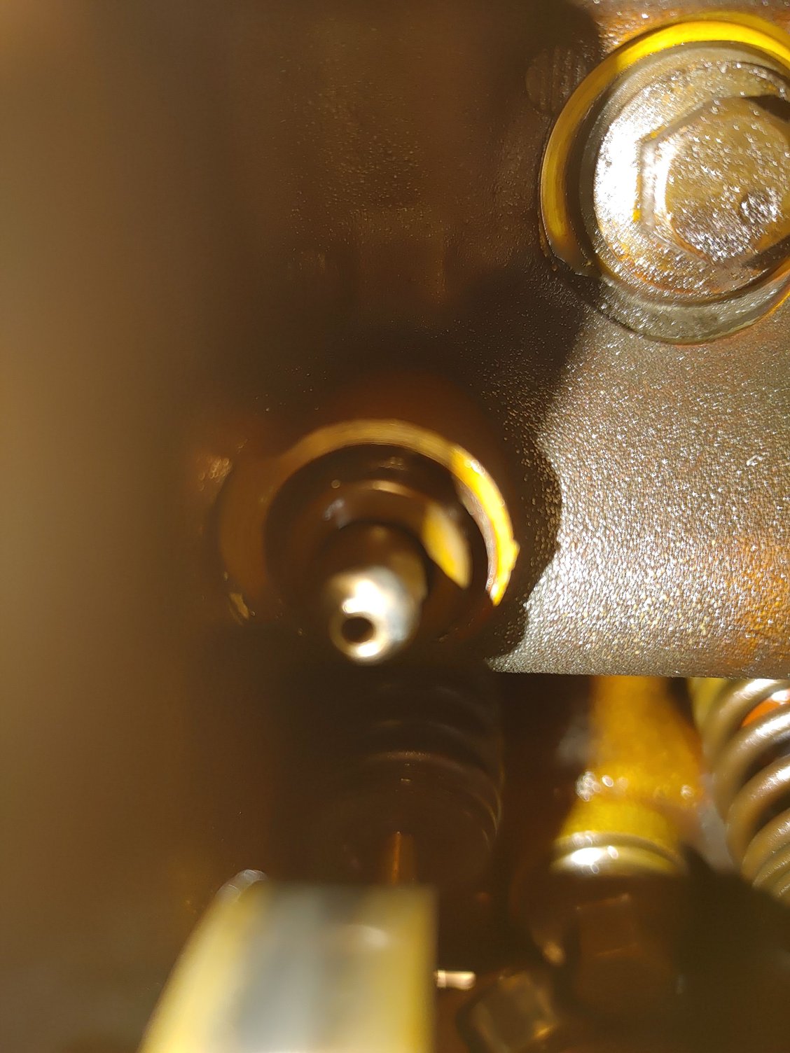

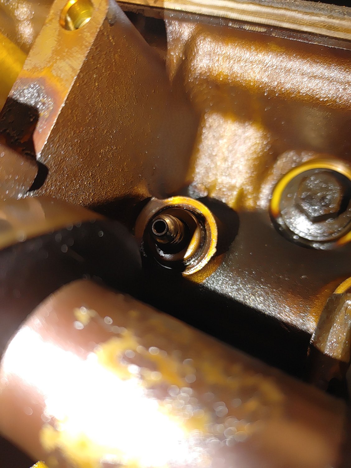

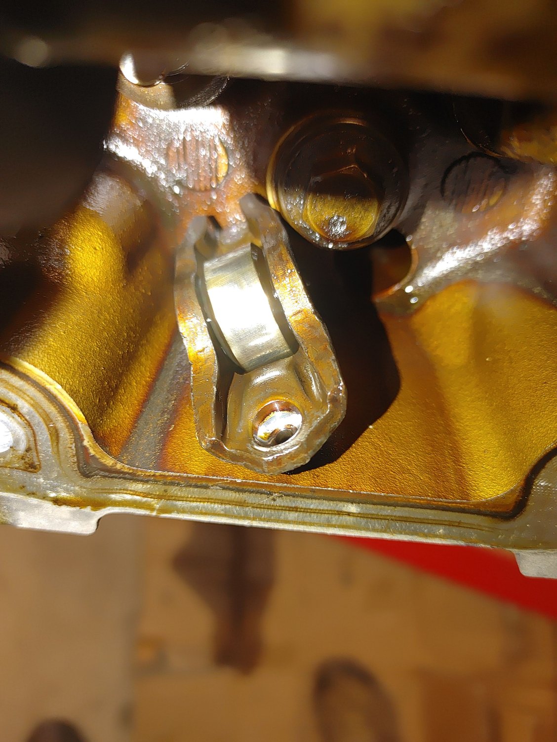

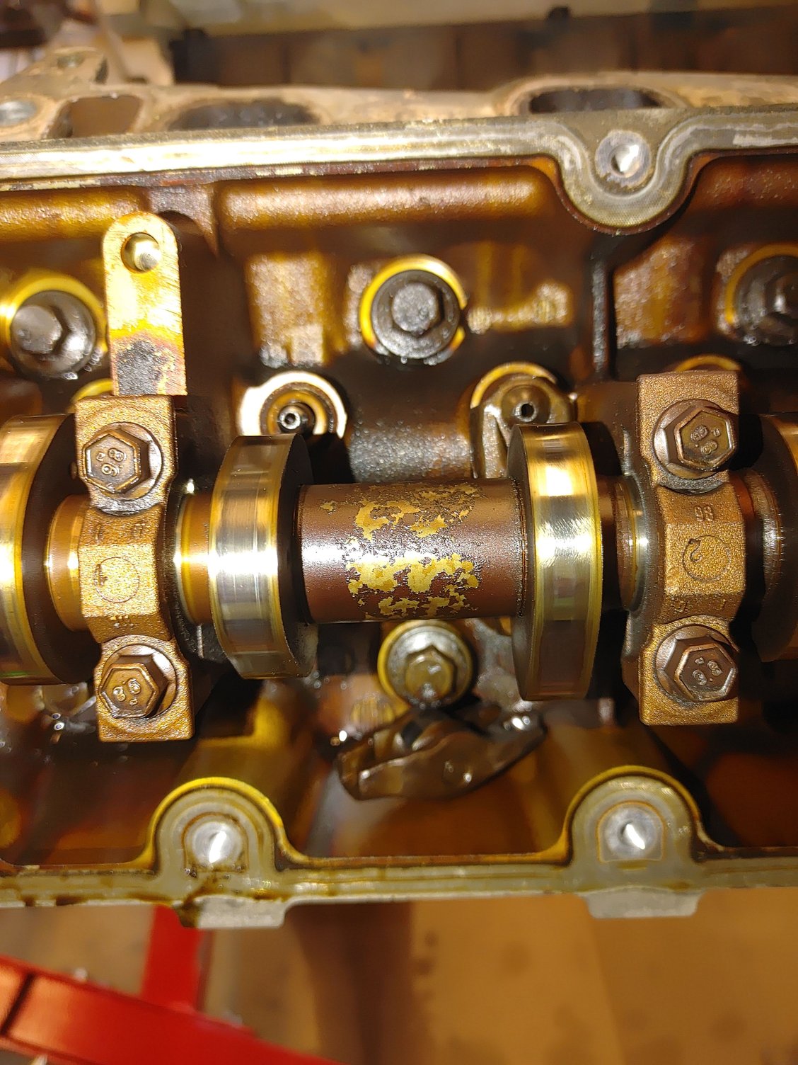

I have very low compression on cylinders 3 and 4, and the leak down test failed miserably in about 4 cylinders. Instead of doing just heads I figured I would by a rebuilt 6.8 and install it.
I pulled valve covers off after I removed it and found this on cylinder 5, please can someone explain how this would happen.
The dreaded cam follower failure I believe. Very lucky it didnt wedge a valve down, that will kill an engine.
