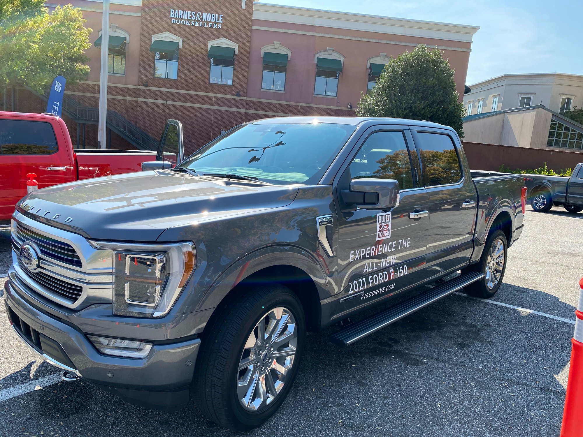

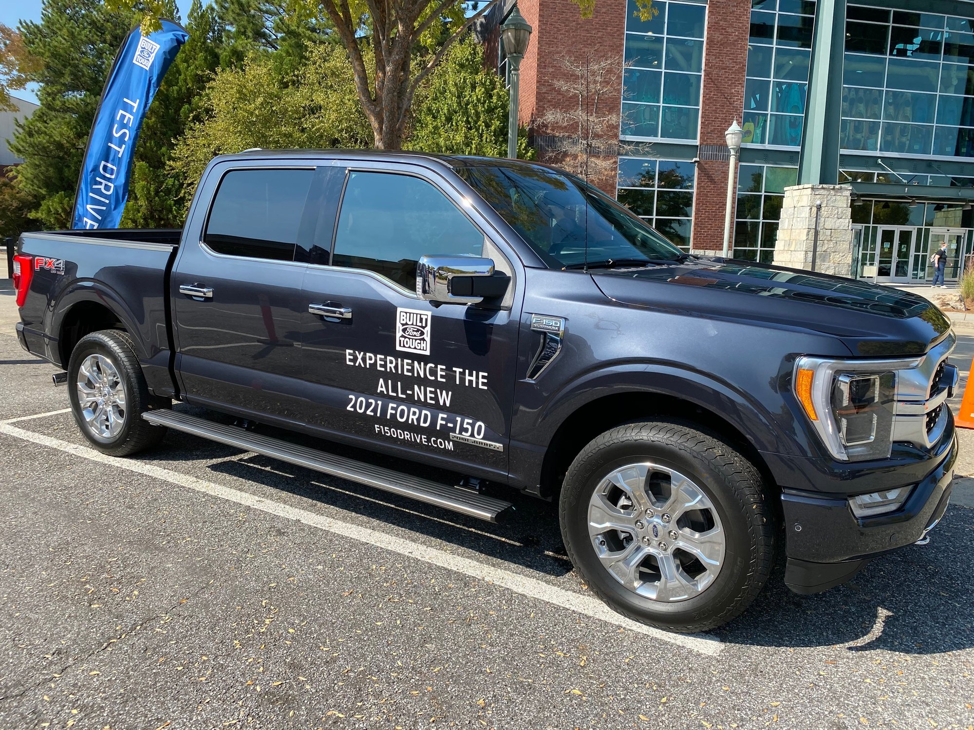

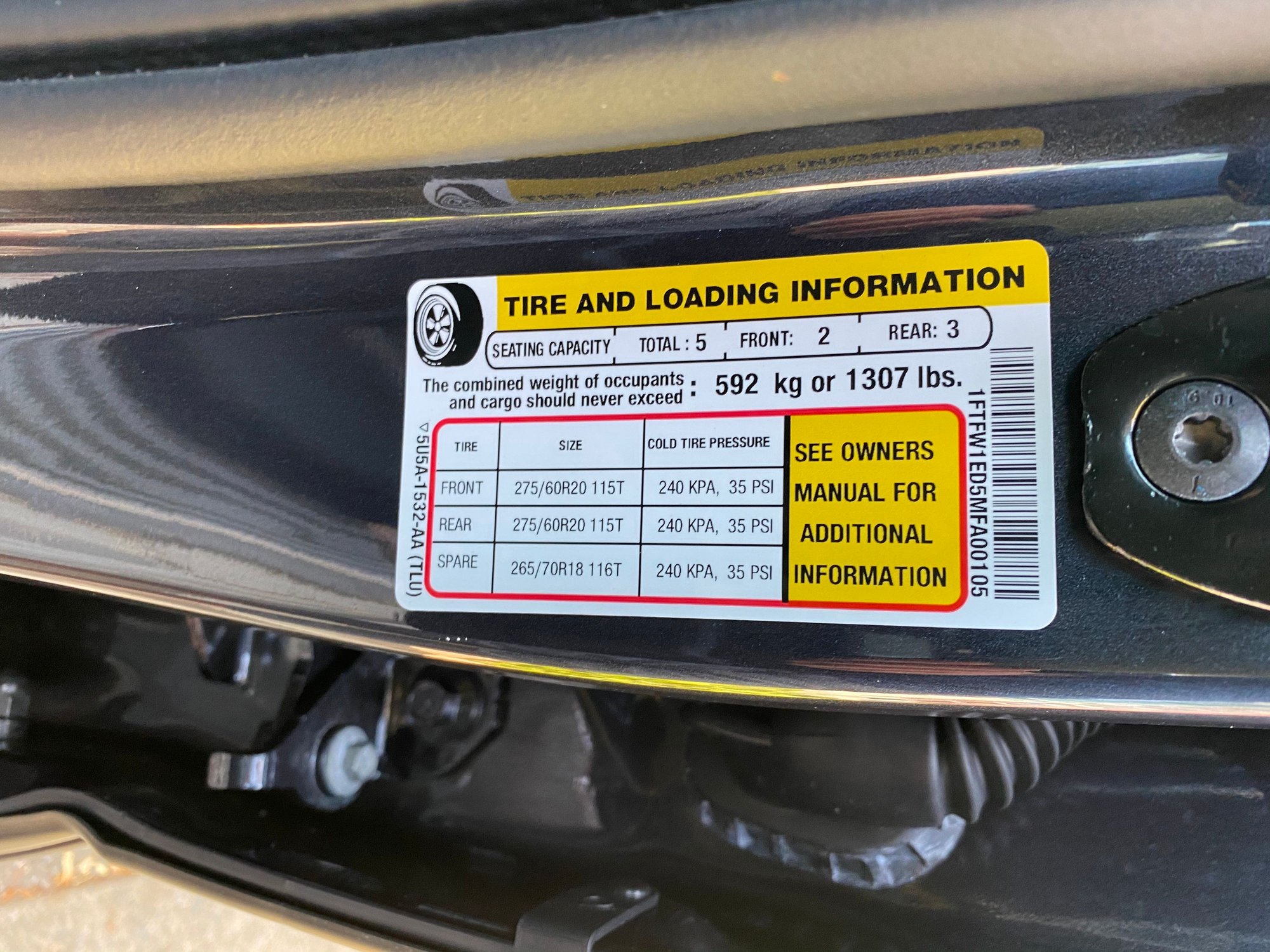

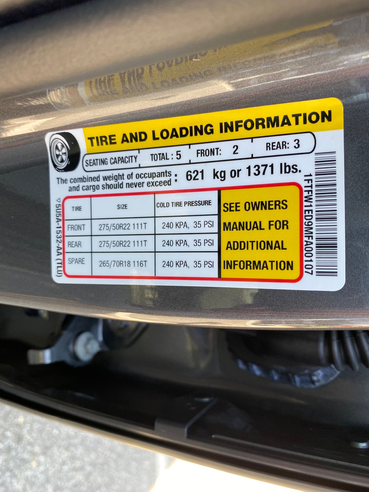

So far the payload on the hybrid is terrible. Here is two, the first is a Platinum and second a Limited. I saw them at the driving event at Mall of GA.

I don't think the hybrid having poor payload is a big shock, or it shouldn't be. Adding an option that weighs hundreds of pounds usually reduces payload by that same amount. Those hybrid batteries are very heavy.
