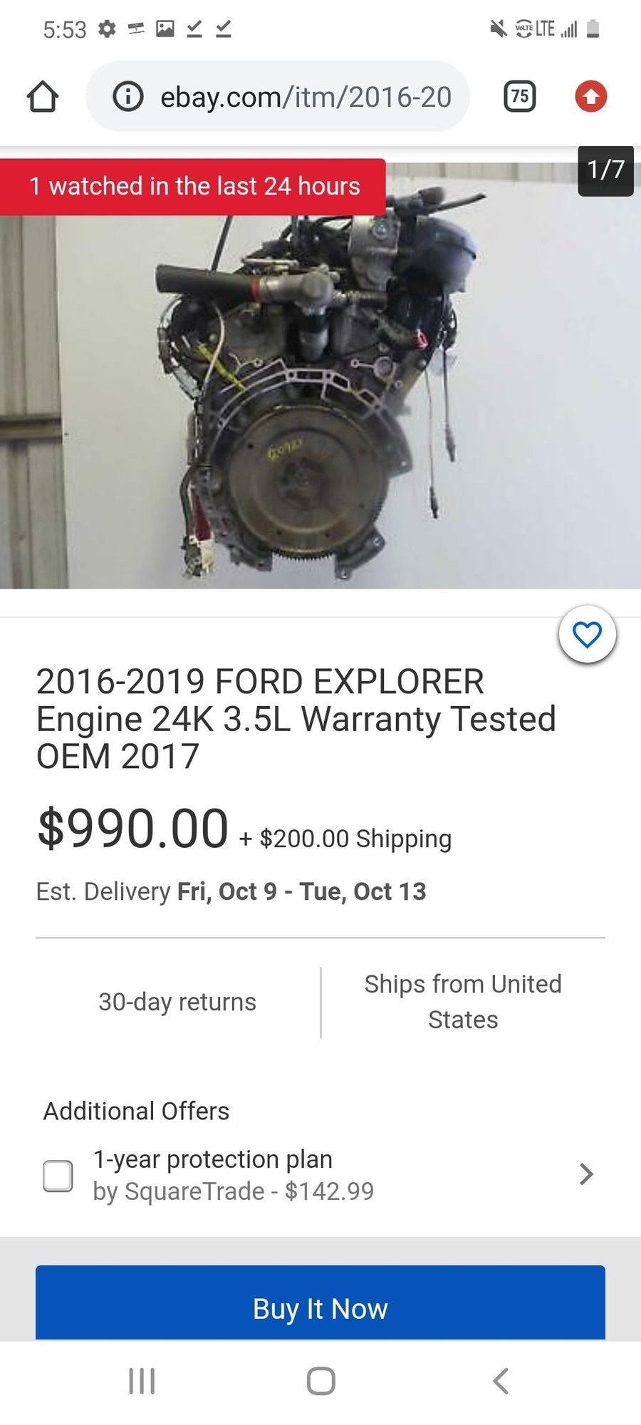

Originally Posted by ford390gashog
Not a chance! Take it somewhere else that is competent. The base 3.5 is so cheap used I would never buy new or reman. Contact LKQ who is the largest parts recycler around. You can get a used under 30k mile engine for less than 1k delivered. They even have less than 5k engines for 1600.00 delivered. There is no shortage of these engines used.
I’ll tell him to look for a local shop with good reviews and to contact LKQ. Great info!

I sent him all the info and pics from LKQ, plus your thoughts on labor.
He's going to look for a local shop to quote him swapping out engines. One of the low mileage engines is less than an hour away from him.
