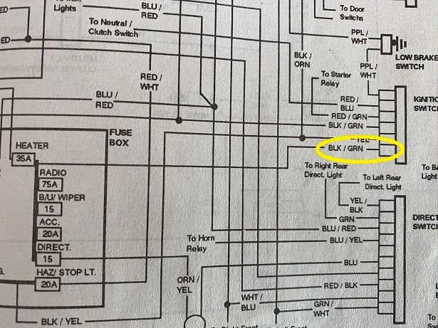

I was continuing my troubleshooting, trying to get in-cabin running voltages higher, when I put my hand on the ignition switch back and the LARGE green & black wire fell into my hand. I pulled the connector off and this wire didn't have an associated plug inside; I assume it was just resting on it's matching switch terminal connection since before I owned it ?!
Before I assume "it's the bigger hole", would someone please send me a photo of their ignition connection so I can insert a proper terminal connector into the correct hole and get this issue resolved? I looked online at generic photos and "it's the bigger hole", but I'd hate to be wrong. Photos below are for reference...

Thanks. Put it in and so far everything is working !
