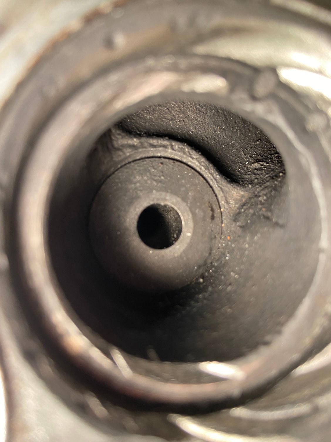

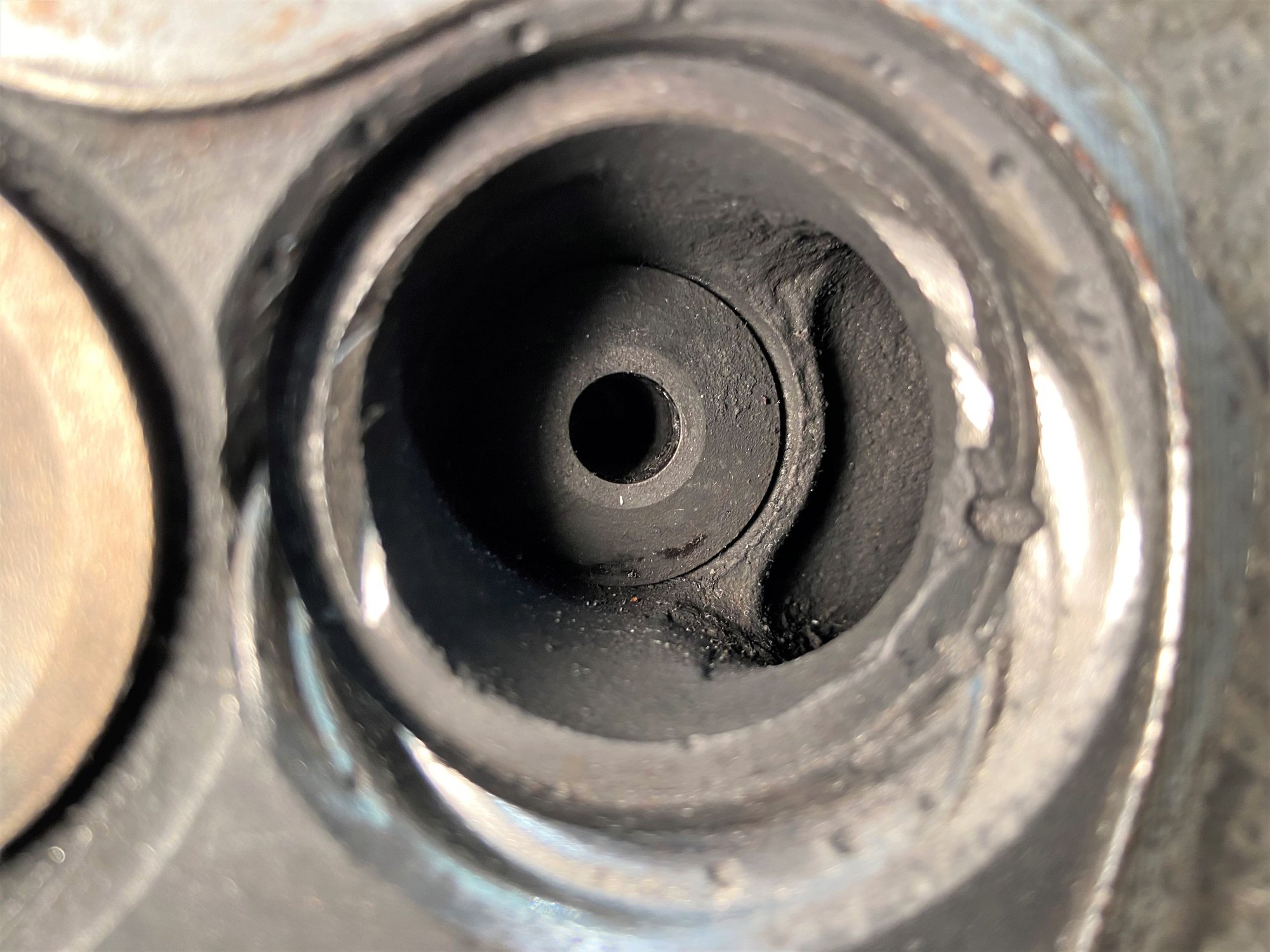

Well I found the trouble. I am attaching some pictures. The valve seat came out of the exhaust port on #3. Its beat it up pretty bad. Don't know if it will clean up and a new oversize seat can be installed that will stay. Found a guy in Mittleburg FL that has a portable machine that will allow me to leave the motor in the truck. The valve appears to be OK, not bent or pitted. I notice that this engine has all concave valves which indicate intake valves. Is this OK or did the rebuilder use the wrong valves?

I am no expert but it does appear that whoever worked on that valve seat had a difficult time keeping it in place...lots of peening and it still came loose.

Oh fun! Glad you figured it out, but man, what a thing to find...
