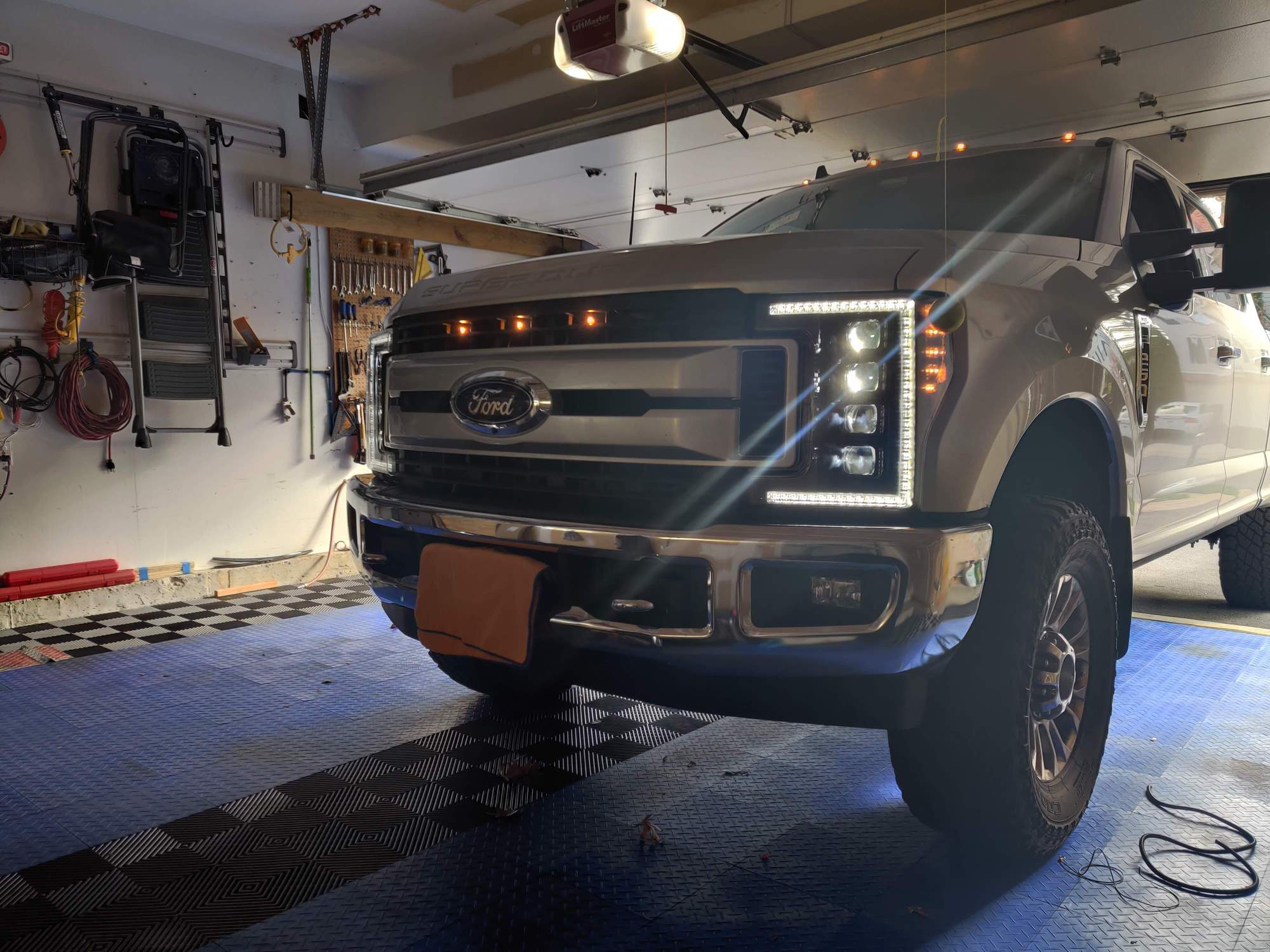

The morimoto hybrid lights are a good upgrade if you don't want the OEM led lights which is a very expensive upgrade.

I put in Morimoto's and got them for 1280, they go on sale, especially around black friday, christmas time. You could also go the Morimoto Hybrids, which I believe are under 1K

I've had these bookmarked for awhile but have been awaiting some real world feedback from people here on the forum. Have you tried them?
I was first in with the Beamtech and really have no complaint with them. But I really like the looks of those hybrids and the "C" outline better than OEM LED.
