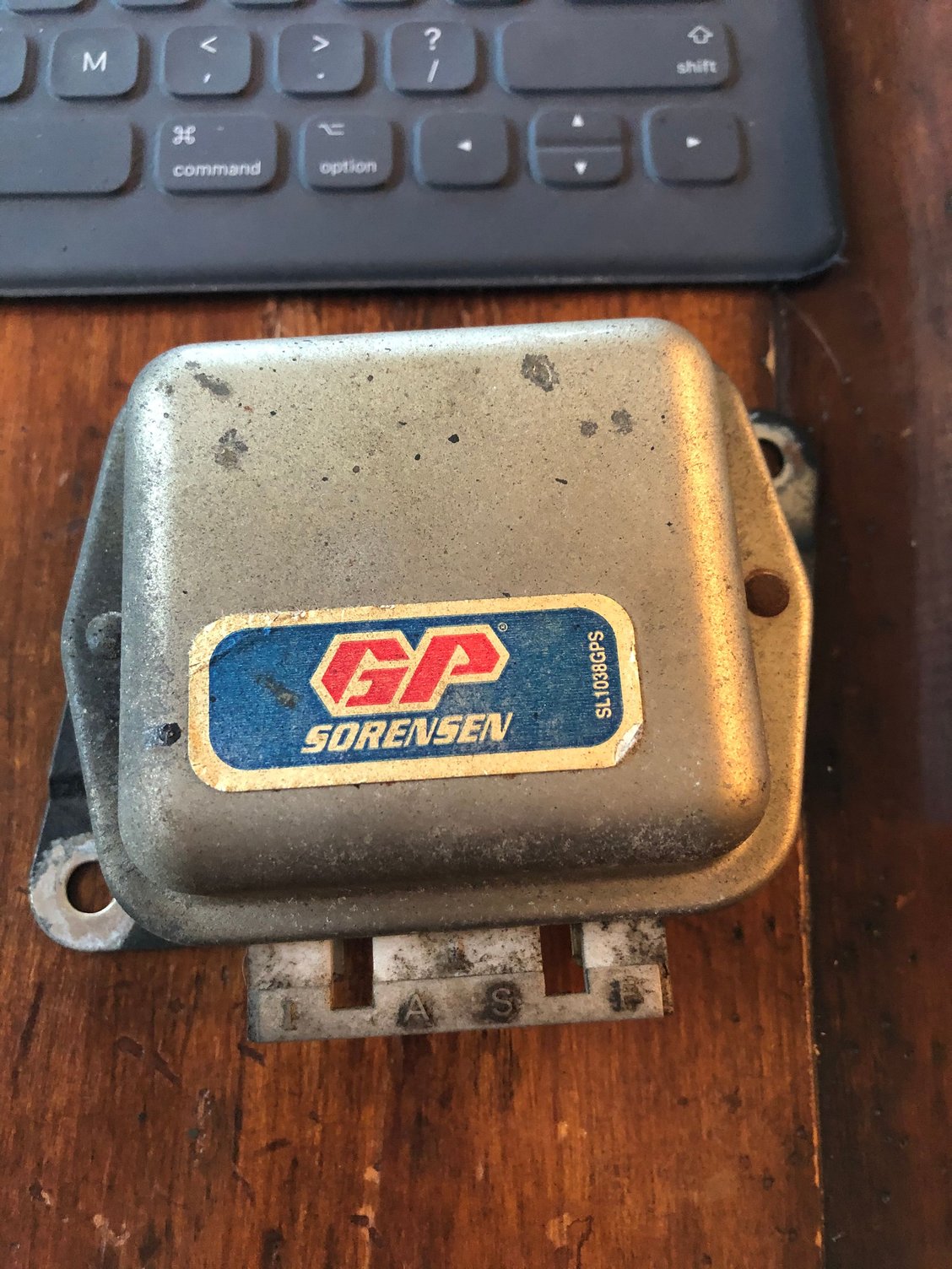

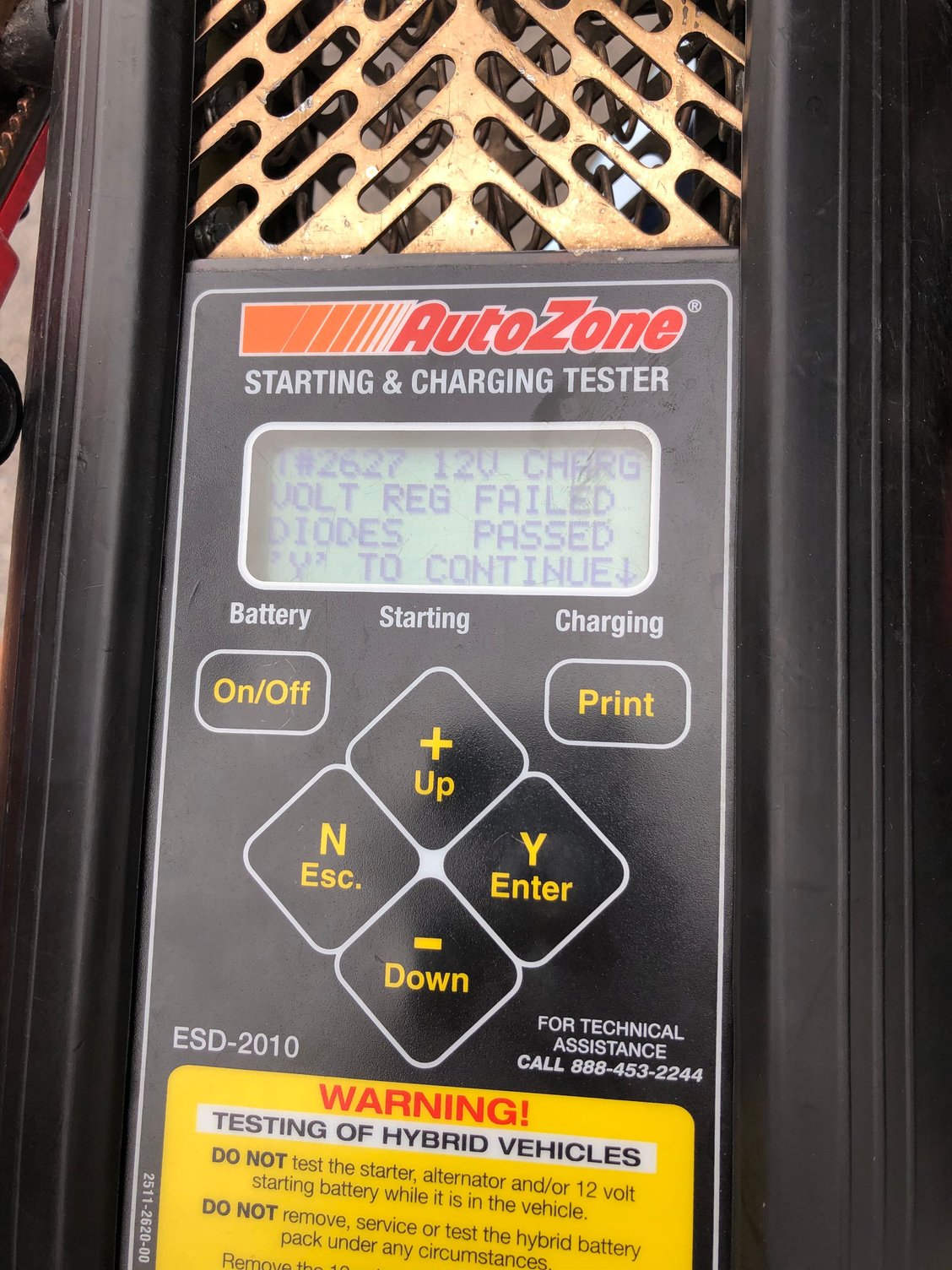

I charged the battery and put it back in the truck, took it to AutoZone. Their report said “voltage regulator failed, diodes passed”. So I bought the regulator they recommended, put it on the truck, and the voltage dropped from 12 to 9. Soooo, I was thinking they gave me the wrong size?
I was also looking to replace a part that attaches from the pigtail of the voltage regulator (on one end) and attaches to the back side of the voltage regulator and attaches to the radiator frame with the same screw that holds the regulator in place. Does anyone know what this is?
WHile I was under the hood I noticed the bolt that held the positive batter cable to the starter solenoid was rusted, and I accidentally knocked that bolt off trying to clean the rust. So now I need a new solenoid.

Autozone report
Old regulator

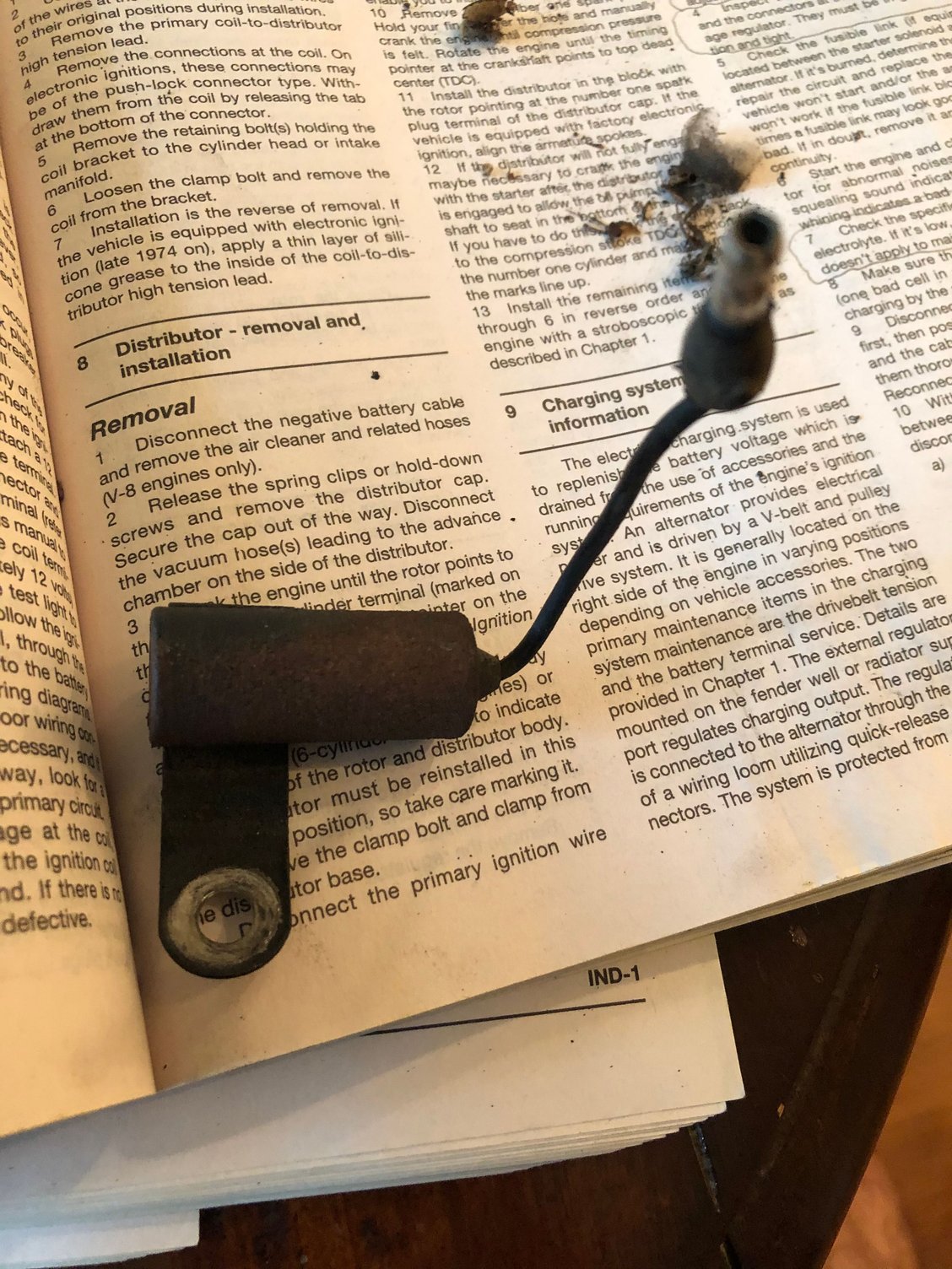

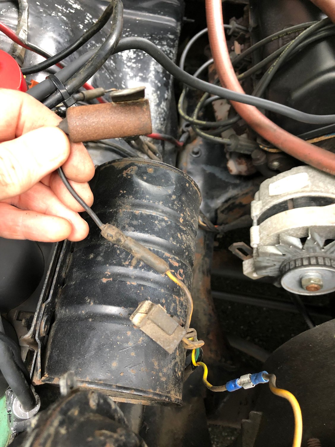

What is this part? Attached to pigtail for regulator and then to back of voltage regulator.
Same part attached to the pigtail. Some kind of igniter or capacitor? No one knew what it was.

One more post on this tonight. I replaced the solenoid, put the old voltage regulator back in , and the voltage at the battery is back up to 13. Where I started this am.
Im guessing the only thing left is the alternator or the belts - but belts look pretty good.

That helps with engine noise in the radio ,it helps filter engine noise or whine out of the radio , may be called a condenser cant remember , on these old trucks there is a lot of interference in the system when its running thru the electrical
Suppressor or a choke coil?
