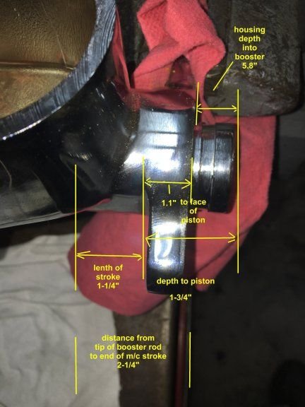

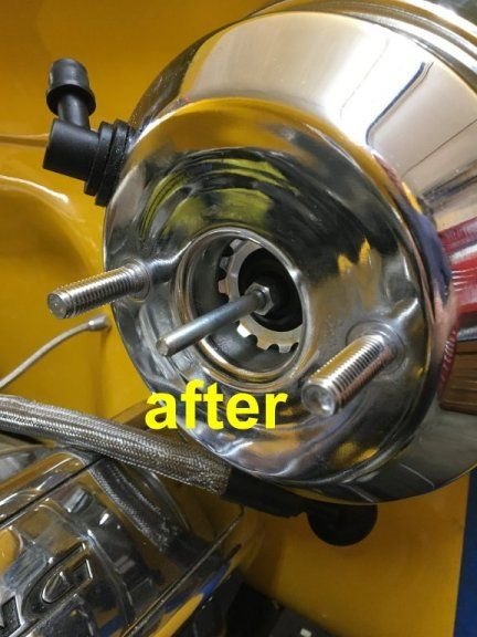

there should have been a rod included with the booster. Mine was 1/4"-20 thread and was too short for my m.c. I used a 1/4" bolt and rounded the end that pushes the mc plunger. You will have to measure the distance you need so the bolt just touches the m.c. plunger when bolted together. If the rod is too short you will run out of pedal before you push the m.c. plunger far enough to actuate the brakes. When you set the rod length make it a little long and as you mount the mc on the booster you will feel the rod against the plunger, Back the rod into the booster just a little till you can just feel the rod making contact and tighten the lock nut... you can feel it better than I can explain it.
john
here's some pics that might help
