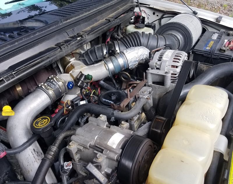

Sounded like it was starving for fuel so I pop the hood to replace the filter and have a look around and a squirrels nest in on top of my engine. The little rat had chewed through the red and green vacuum lines, the wires to the waste gate sensor.
After removing the nest I change the filter, solder the waste gate wire back together and ordered a set of vacuum lines.
It still didn't want to start easily but it finally did start so I ran it down the road to charge the batteries. It was running pretty good.
Next day I do out and same thing is happening. This time I take a better look for more wires chewed and find the spacer and nut for the IPR missing and the coil has moved out of position. One of the wires was chewed on but not broken so I taped it up, put the spacer back on and tie-wired the spacer in place for testing. It still was hard starting, white smoke and dieing after 10 seconds or so. I suspected wiring harness problems at this point. All visible connections were tight going to the 'valve' covers.

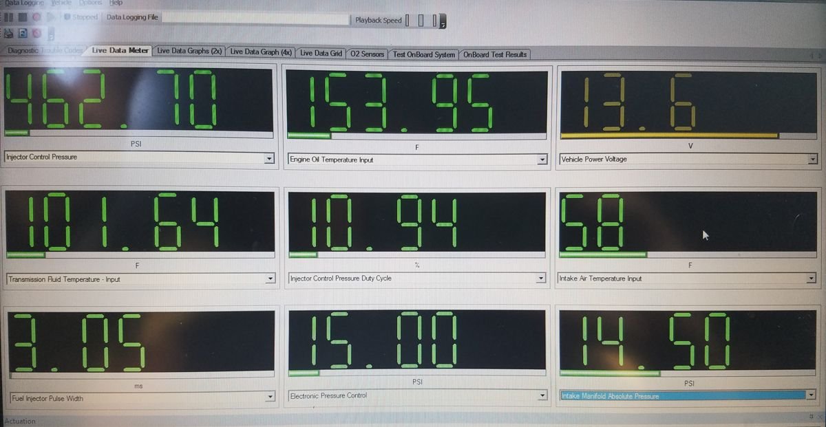

I go in the house to get the laptop and Enginuity rig to run a buzz test on the injectors to check the under cover wiring. I hook the computer up to the truck and cleared all the codes. When I start the truck to get the recent codes the truck starts fine and runs normally. It did take a little bit of extra cranking but it soon smoothed out.
Screenshot below is when truck was running. (I'm not an Enginuity expert at all.)
I still have to wait the the vacuum lines and IPR nut to get here to drive it, but at this point I don't trust the truck. Any ideas?
