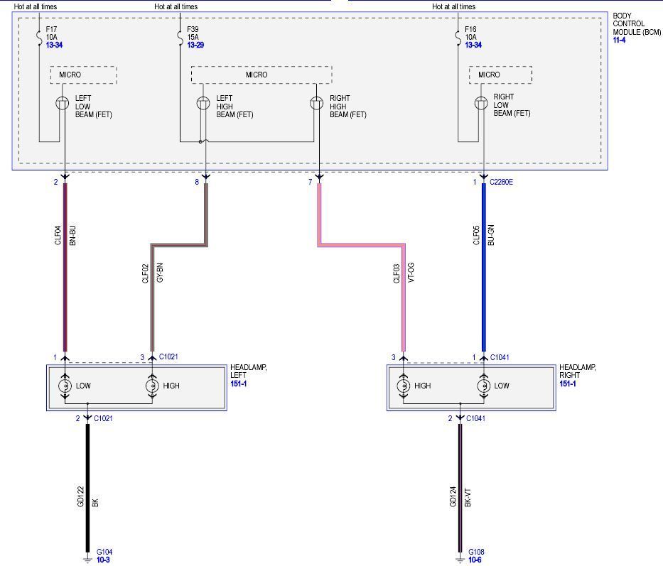

2016 F350 diesel, Canadian DRL. Any help would be appreciated. I installed a light bar via the up fitter switch and tapped into the high beam wire to trigger the relay.
Everything worked for about a year and suddenly I noticed a flickering of the light bar and it went out. Since then I have not had the hi beam that I tapped into. I disconnected the tap wire, checked all fuses and tried a new multifunction switch, all to no avail.
Bulb is good, no power to the hi beam wire when triggered. I’m stumped, and admittedly, not an automotive electrical expert, I’m just a millwright lol.

You have probably blown the FET (field effect transistor) in the BCM. The BCM is NOT repairable per Ford. It has to be replaced.
One should not try to use the lights to power anything since they are FET controlled.

Well, I remembered I had a FORSCAN device (which I rarely use) so I scanned the modules and it was a short to ground on one hi beam circuit in the BCM. Reset it and its OK again. Now I’m thinking I should add a diode to the trigger wire.
I was under the impression that by using a relay to power the light bar triggered by the high beam wire was the way to do it.
If a diode would work, could you recommend a value?

Been so long since I have But looking, the 1N4001 would probably be ok.
