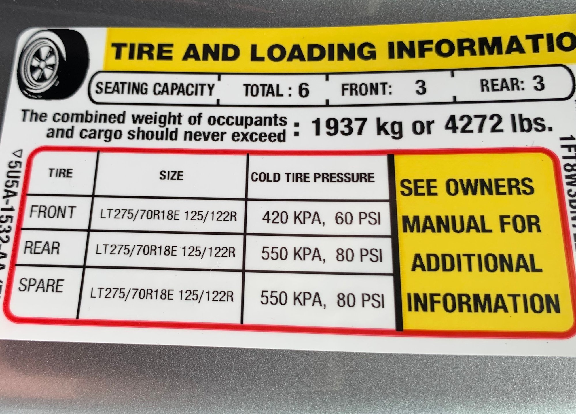

This is my CCLB 7.3 with the camper/snowplow pkg. The "TRUCK CAMPER LOADING" certificate may be interesting to you. I was a little bit confused about why the camper loading paper showed a max weight of 3424 lbs. and the yellow sticker showed a cargo capacity of 4272 lbs. If you read the definitions section on the paper it mentions the weight of the occupants in the vehicle. My truck was ordered without the center console, so I have 6 seats at 150 lbs. per seat for a total of 900 lbs. I also noticed in the "2020 FORD RV & TRAILER TOWING GUIDE" it states "Cargo Weight Rating shown in chart is maximum allowable, assuming weight of a base vehicle with required camper option content and a 150-lb. passenger at each available seating position". I think they are subtracting the estimated weight of the passengers that may be riding in the truck from the cargo capacity available for the camper. However, by that rationale still have a 52 lb. discrepancy.
