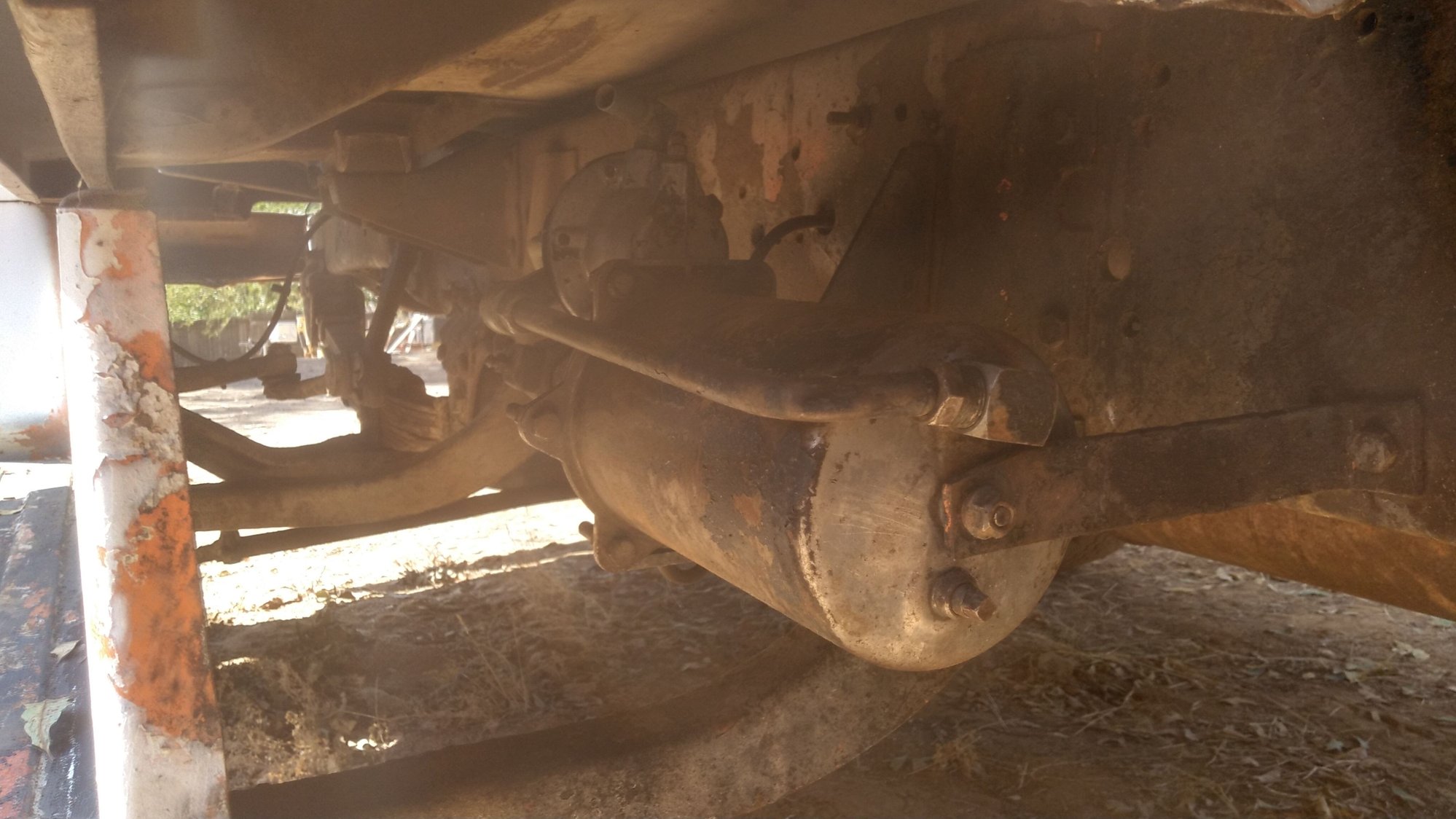

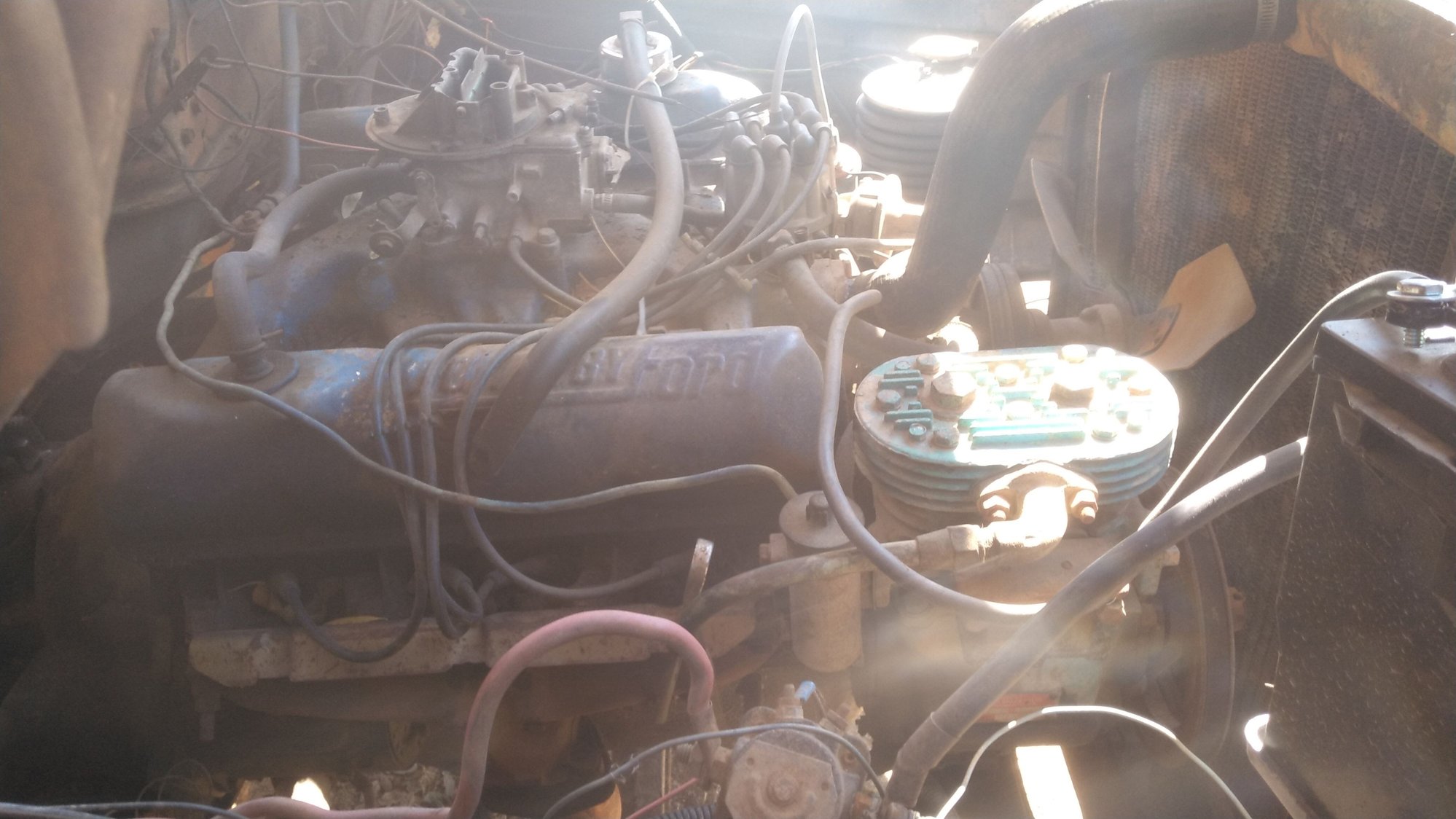

Hey I was wondering about the braking system on this 1968 f600 it is equipped with on board air. One line runs down to driver side frame to a bendix booster for the brakes. It also has just a single master cylinder on the fire wall. To me it looks like air assist booster and not the typical f600 ones? Is this style worth repairing or should i switch over to the more common style. Sorry if this is confusing just trying to sort out what I have. Also It has a chelsea pto operated by air wondering if there was any easy way to make it manually engage and get ride of the air switch?

Trace the line from the booster back to the engine compartment. I think you will find it is connected to the intake manifold.
What you describe is typical of that size truck from all makers. A frame mounted hydro-vac booster, and a single pot master on the firewall.
An air operated "pto" would not be a PTO. You may have an air shifted PTO. Is it mounted down on the side of the transmission?
Post some pictures after you trace those lines.

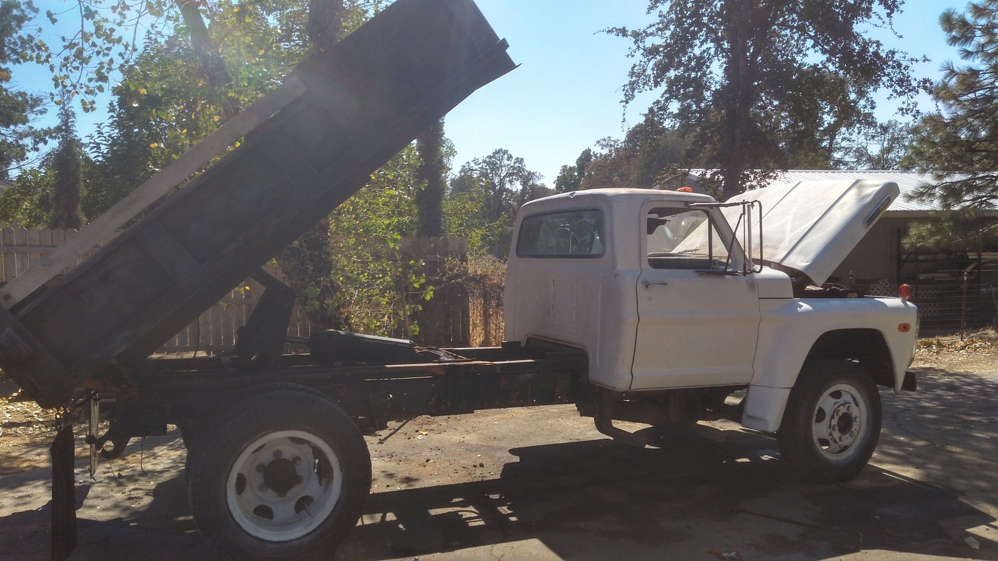

Trying to post some pics of the brakes and the dump truck.

Sorry the pto switch is air operated, would like to change it some how. I did trace line from booster back to the air compressor. I'm picking up a '71 soon and probably a '66 so I will have three f600 to hopefully make one good truck. Here is '71 vin and the pto off of the '68. Thanks for all the info.

OK then, looks like air over hydraulic. Do the brakes work? Air over hydraulic was seen in a lot of military stuff, but otherwise, afaik, seen as kind of oddball.
Last I checked, some states require you to test for air brakes if you have air over hydraulics. Even though the rest of the system is the same as regular juice brakes. You could swap to a vacuum hydro-vac with a little rework. The rest of the brakes need to be gone through anyway, regardless of boost source.
