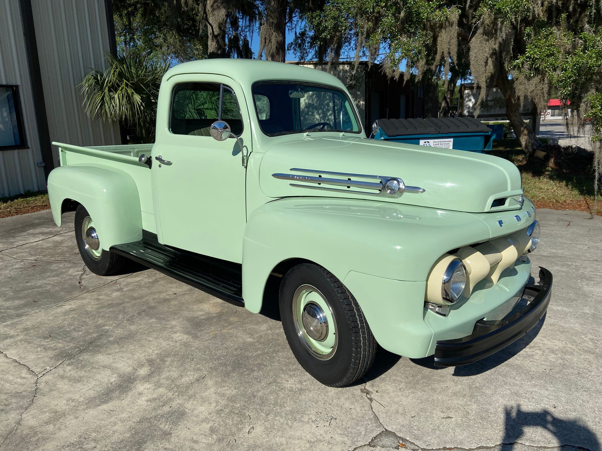

I have recently restored a 1952 F1 pickup and can't get it to run properly and am wondering in anyone knows of a person or garage around St Augustine that I could get to look at it.

Welcome to the forum. That is a very good looking truck; attention to detail. I am on the other side of the state, just a bit too far away to help. What is the old truck doing? Well explained problems usually get attention and result in good answers..

As Ray stated . Welcome to the forum . The best site in the world for old FORD trucks . Yours looks so very nice in stock form . Great job ! Elaborate on the problem . To cap of the five star extra package a bright metal windshield molding would look great . Congrats on the truck . How long for the resto ?
