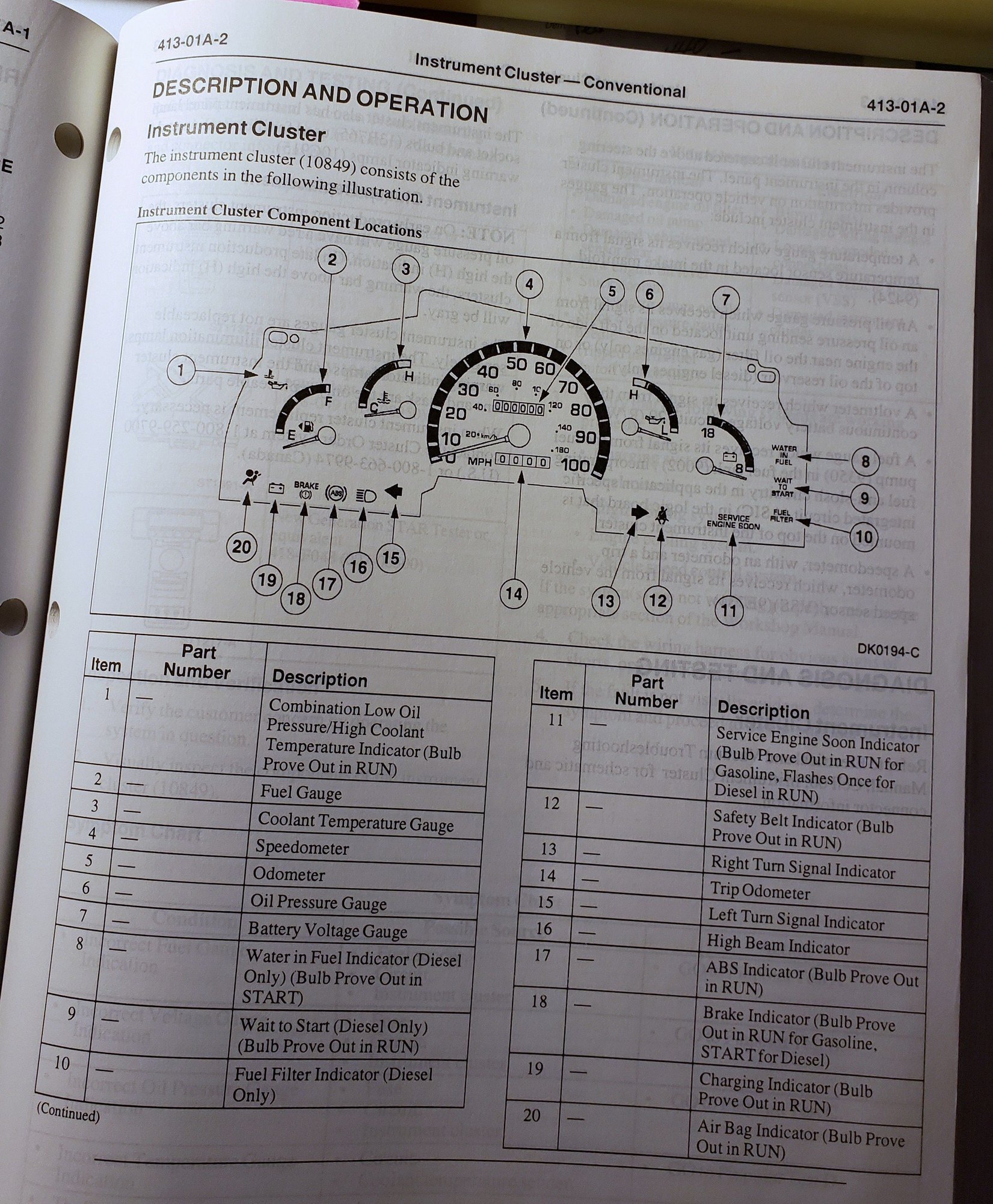

Does anyone have a diagram of the instrument cluster for a 95 e-150 club wagon van? I'm trying to figure out what the lights are next to each turn signal

Here's one from a '98 if it helps;

The 95's are quite a bit different from anything beyond 1997.

Ahh, my knowledge jump is from a '66 to an '81 to Strayhound an '89. Sorry for the misnomer.
