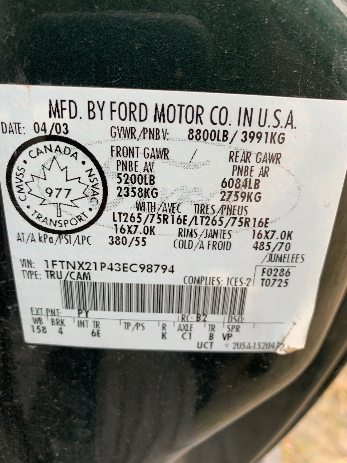

Part of the purchase I also got a separate differential with dually wheels and new tires. The metal tag on it is quite rusted and I can barely see some numbers but there is also a white stiker showing 169S. Base on my research the 169S would be a Limited Slip 4.10. The meal tag is only showing the last few numbers. First numbers I can see are perhaps 101C.2.6E13 (Part on bold is clear the rest I'm not sure). Based on the door tag of my truck I have a C1 Differential (3.73 Limited Slip).
Since I have a 4X4 I need 3.73 gear in the dually. Can I swap the differential gears from my current differentials and put them into the dually differential?

If you brush off the metal tag with a wire brush, someone might be able to read it and give you more info.
Also, if you showed a photo of the rear axle housing cover of both rear ends, one might be able to determine if they are they same size.

Actually I found a picture of the dually diff and I can confirm the truck as a C1 in it but do not have a pic. I only have the door sticker and the VIN.
