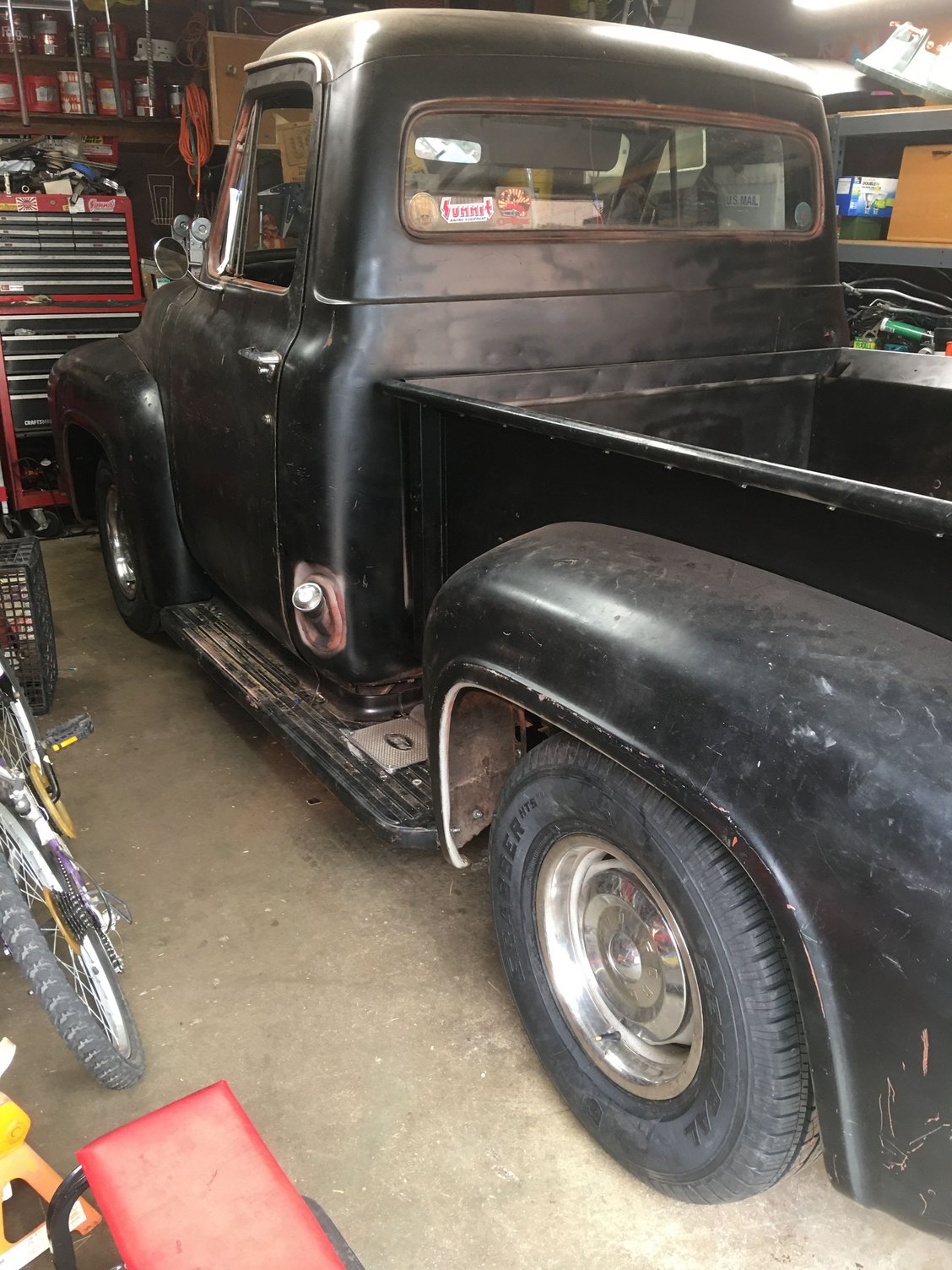

I just put on new tires on my 1955 ford f100. I have 255 70 15 on the rear. And 225 70 15 in the front. I think the rims are 15 by7 inch. I thought a lot about this combination. So I thought that others would appreciate a picture of tire combination.
enjoy
jerry

Sorry I was working on my honey do list. My truck is about to make her maiden voyage. But the back and forth and up and down driveway it’s perfect. I am very happy backing it down driveway with power steering it’s like butter. I was thinking about 255 70!15 on front also. But steering with engine off 255 is a little tough. So I decided 225 70 15 for the front. Plus the bigger 70!series takes up wheel well space and makes the truck look cool and old school.
thanks
jerry
