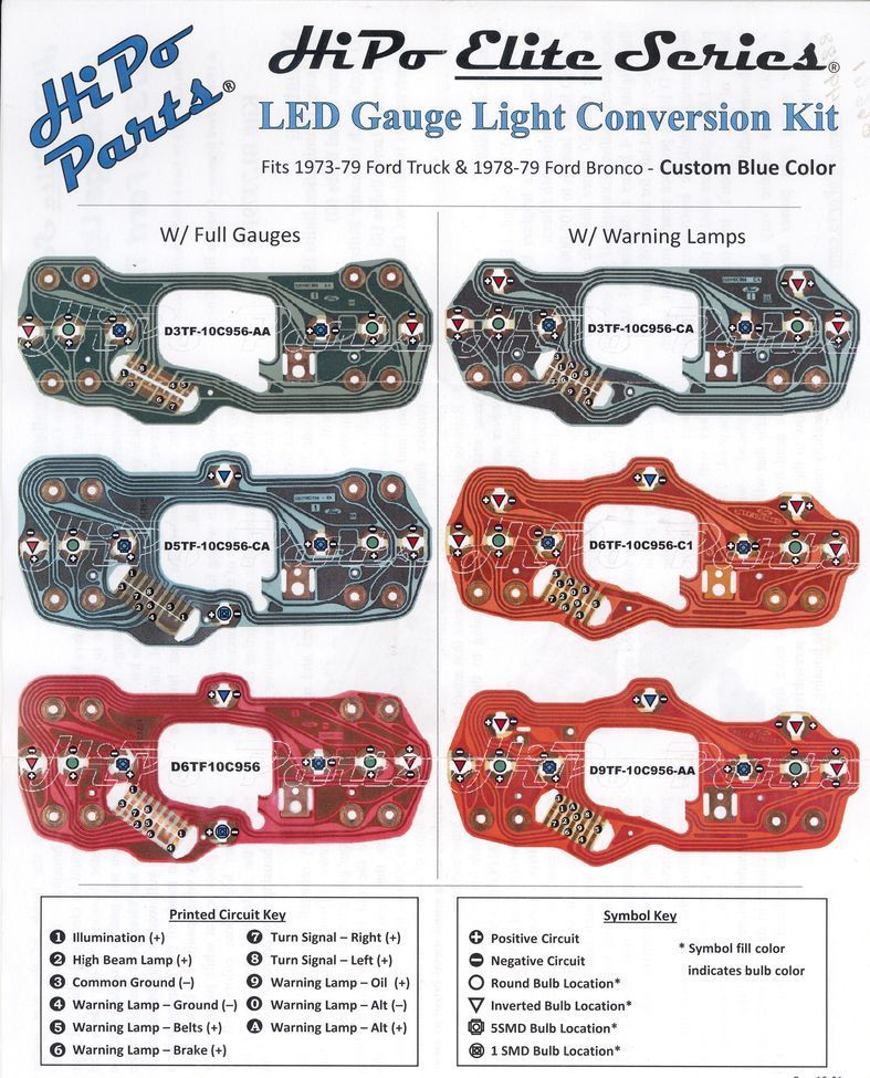

Does your original al cluster have gauges at top left and right or idiot lights? Dennis Carpenter carries the back plates for both. My guess is your new digital cluster just needs a mounting surface, so it shouldn't matter which you use.

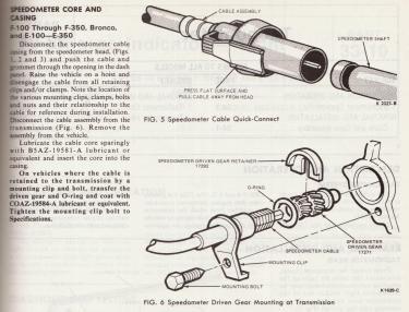

Add I will add the the speedo cable is suppose to STAY in the housing.

Beat me to it Rich. Yeah, maybe detach the speedo tube from the vehicle or the cluster back before you pull the cluster ALL the way out I still need to get that out so I can measure for the replacement.

Anywho back on dash topics, you know why the speedo cables came in different lengths? Is it simply a manual vs automatic thing or was there variation in those two categories? Ima measure either way, but still curious.

I know that if you had cruise control you had a 2 piece cable, due to the CC piece (sensor?) in the middle.

The following 1981/86 or 1981/91 Econoline hard plastic instrument cluster backs replaced the 1975/80 POS composition material cluster backs that TURN TO DUST before your very eyes!
CARPENTER NOS PARTS in Concord NC has both of them = 800-476-9653.
E1PZ-10848-A .. Hard Plastic Cluster Back - Use with Oil/Amp GAUGES / Obsolete
1975/79 F100/350 // 1975/91 Econoline // 1978/79 Bronco.
E1PZ-10848-B .. Hard Plastic Cluster Back - Use with Oil/Amp WARNING LAMPS / Obsolete
1975/79 F100/350 // 1975/86 Econoline // 1978/79 Bronco.
