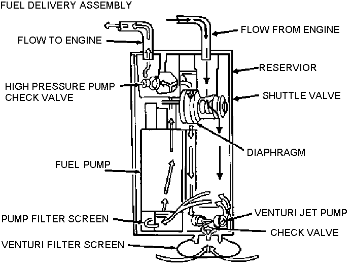

The fuel delivery module:
Attachment 281295

If your front pumps pressure is low it could be because the back pumps module is bad.
That is why I said above check the pressure with a gauge on the road going up a hill on one tank and then do it again on the other tank.
Your symptoms say low fuel pressure and you said the front pump had low pressure.
