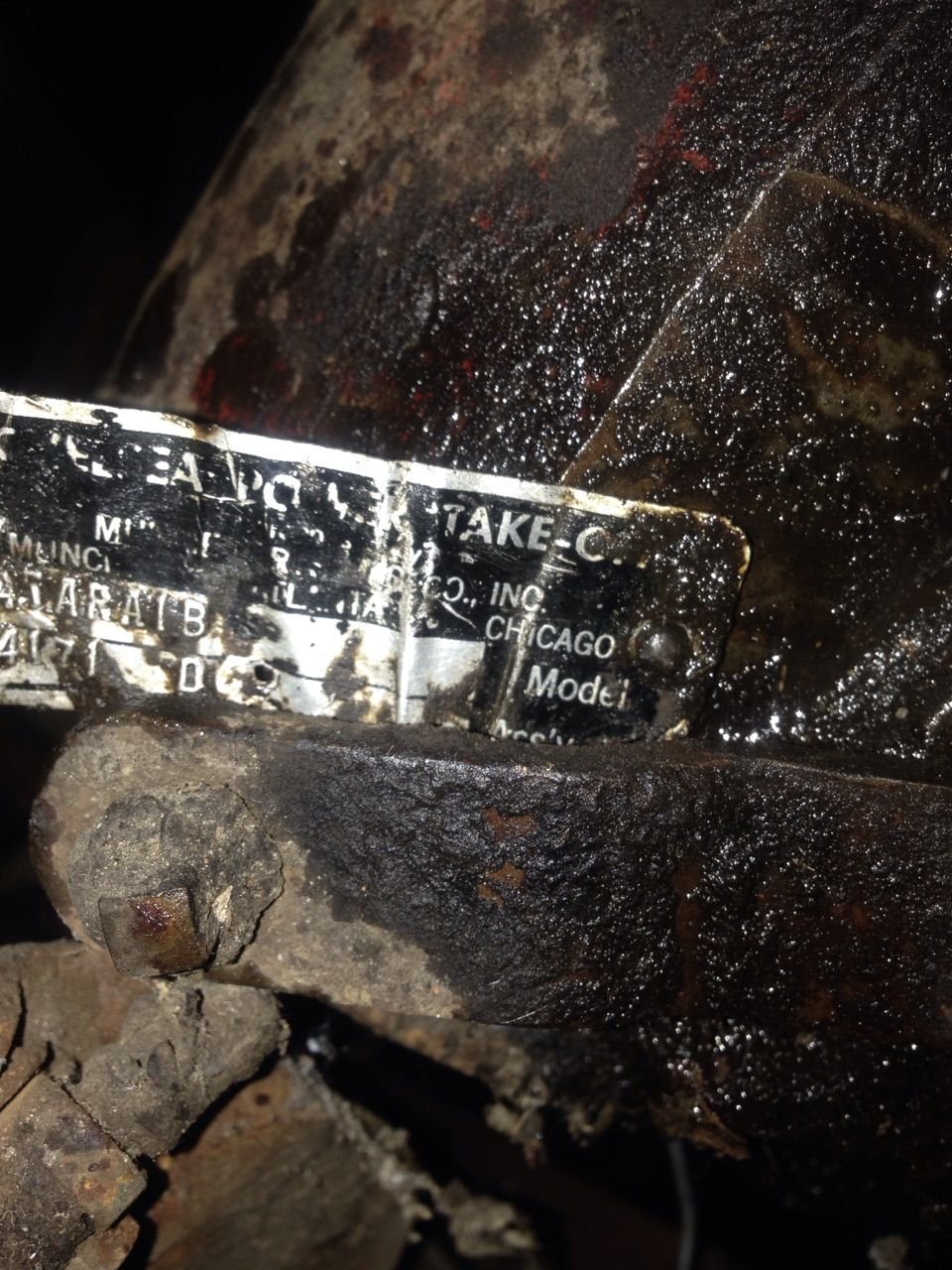

Buddy of mine has this pto and says it's came off of a Ford, but doesn't know which one. He's trying to figure out what transmission it will bolt to. Wanted to see if you guys might be familiar with it. I'll have to get better pictures the next time I'm at his shop. It was late and dark when we took these. Tag was crumpled up pretty bad, did my best to straighten it out. The first digit of the Model is illegible, or there was just a heavy crimp in the tag before the number, the rest were 45ARA1B best I could tell. The second number was labeled Assy and it was either 44171 D or A4171 D. Which is about nothing to go on. I'll post more pictures when I can take some, so you'll at least be able to see it.

Thats a old outdated Chelsea, check the bolt pattern. It will mount to any 6 bolt port with proper shim pack.
