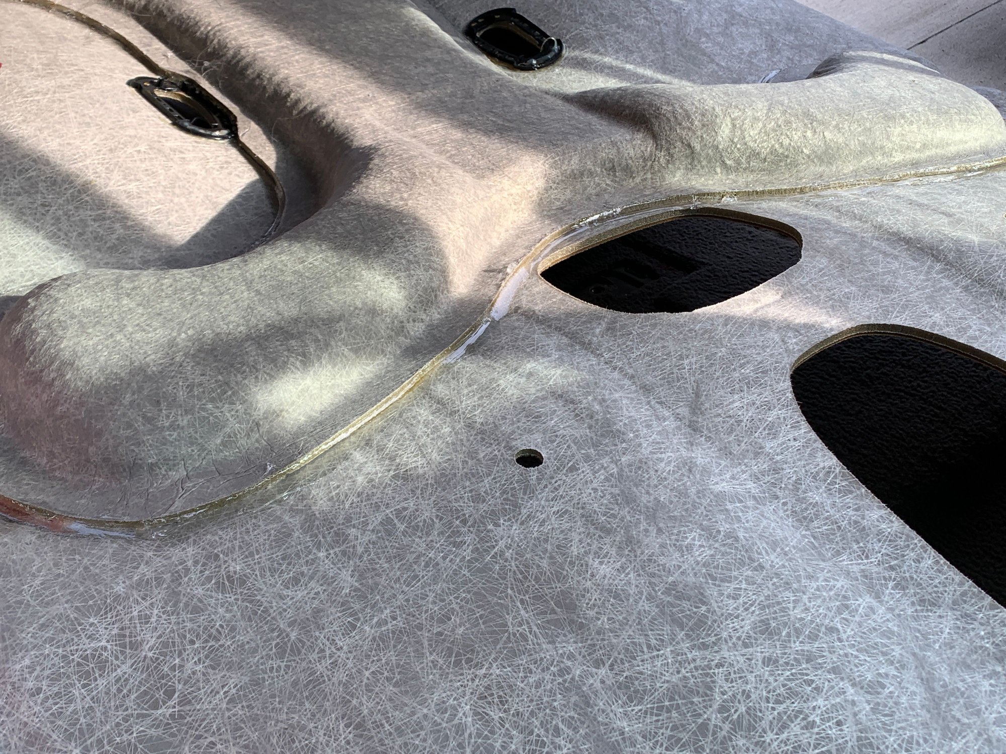

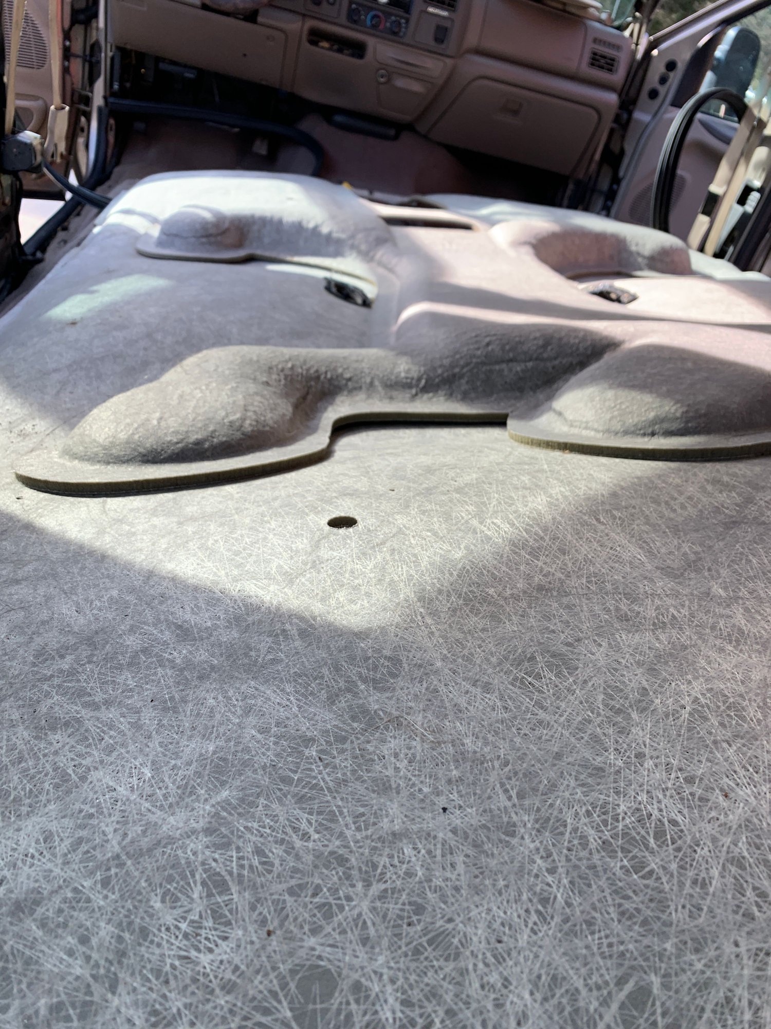

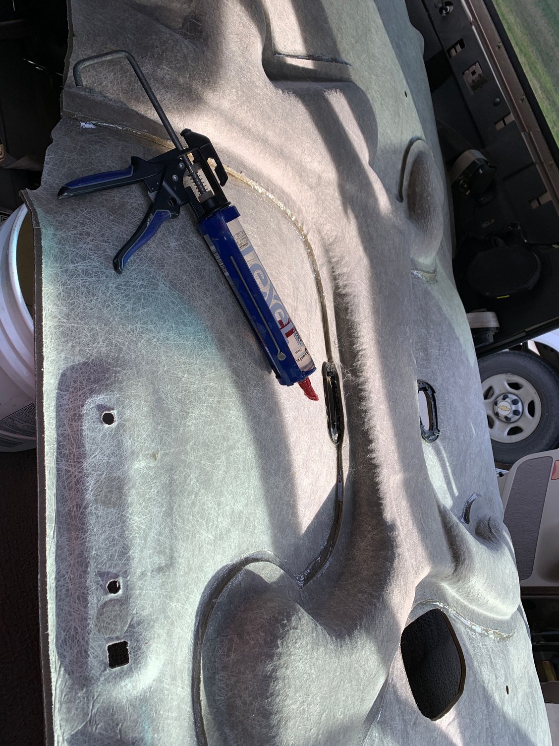

Find my posts somewhere here in the abyss. There a few causes for the airflow issue. One is the foam seal on the diverter door, (floor or ceiling), and or the circumferential foam gasket at the top of the duct tube going up the right side feeding the roof spider.
The headliner, a real PITA, but doable. I posted pics of the diverter door and the unglued foam that blocks not only the air path, but the movement of the door. When I took the headliner down after stripping the rest of the interior to clean, I decided to seal the spider duct tunnel as it had come unglued and was leaking. FYI on the belt re-tractors, if they wind up al the was, you just make sure to pull them out very slow, and in the same vertical position as when installed in the vehicle, they should be fine.

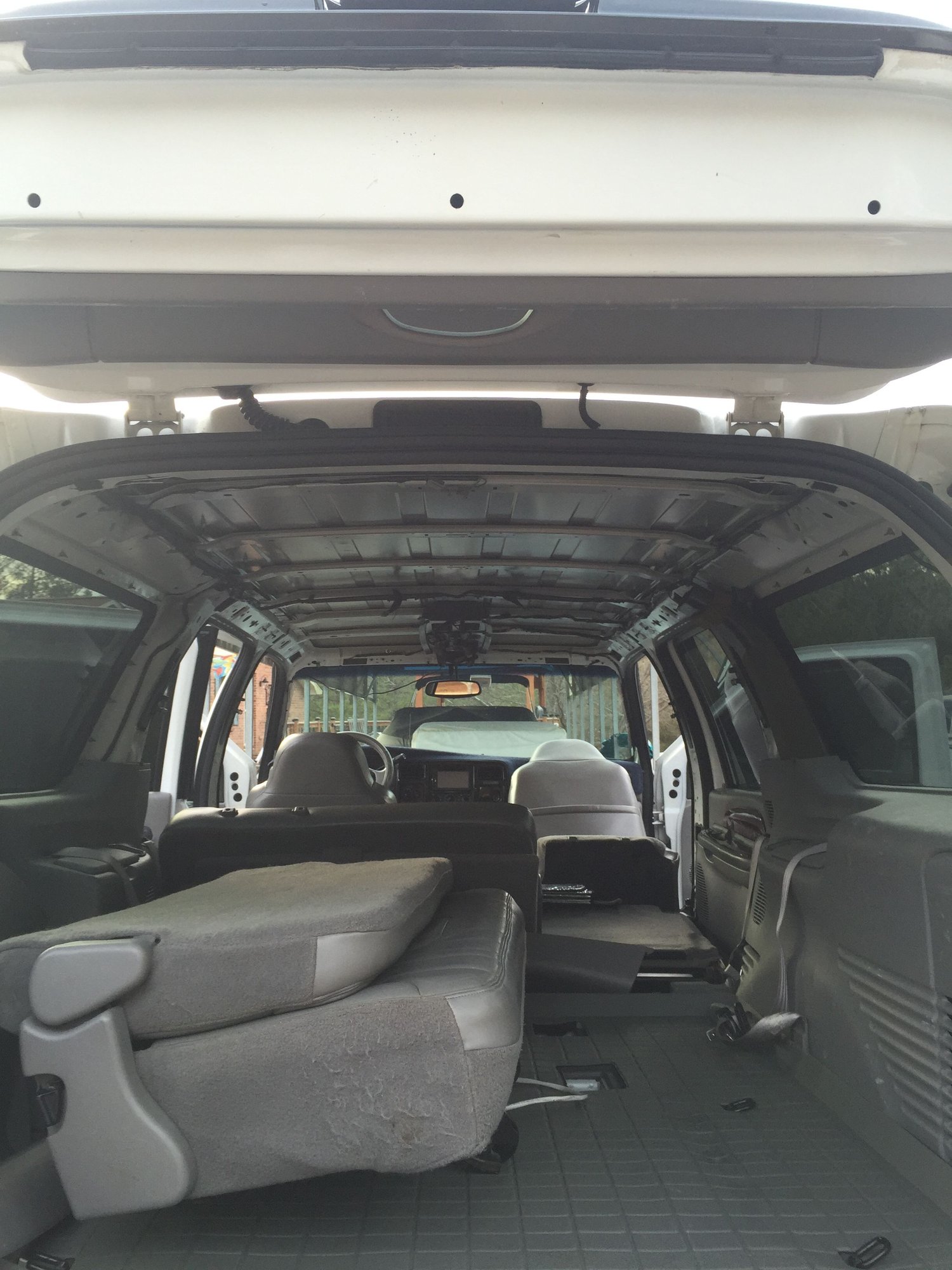

When I pulled the headliner in the diesel to have it re-done in the blue, I didn't take out nearly as much interior parts like the V-10. The V-10 was a full strip and clean. The front seat backs were popped off their recline pin if I remember, and the headliner was tilted down to the right and slid out on an angle.
The rear blower box does not need to be fully removed from the vehicle, but the rearmost pillar trim, large quarter trim panel, rear door sill trim, and seatbelt pillar trims have to come off. The blower box front half can be separated away from the other half mounted to the vehicle body.
