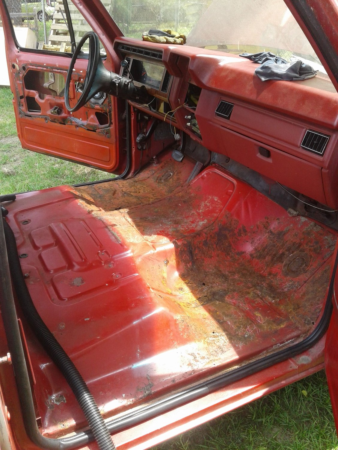

Boy, using this website on a tablet is extremely slow..
I'm starting to think I might need to get someone to help me work on this body work,, i think it's a bit over my head.
I might be able to do the inside, but the underside I'm not comfortable doing..
Here are some pictures of the floor
the floor looks worse than it is...a lot of the batting stuck to the floor..

What's wrong with the underside? Once you fix the inside, all you have to do is slap some undercoating or paint on the underside correct?

A lot has to do with the how you want the job to look when finished, the tools at hand and your skills.
From the sounds you don't have a lot of tools or the skills to make it look factory and that is just fine.
Also know when you start cleaning the floor pans the holes will get bigger and more will show up.
The hardest part will be the under side for cleaning and fixing.
I think for you the fiberglass rosin & matt is the way to go. Use the matt top side and just rosin on the under side
then coat both with a brush / roll on bed liner for protection.
Also pull the metal plugs on the floors as that is access to the front cab bolts and if you glass them in you will never get them off.
Do all the repair then put the plugs back in.

See all those factory dips and bumps in the floor? If you take your time and slop the resin on there good and work the cloth into those dips and bumps, when it dries and you give it a coat of paint, the fiberglass cloth method doesn't look too shabby.

If you just fiberglass over it, I'd get some phosphoric acid or some kind of rust converter and apply that before the fiberglass.
Try and kill as much rust as possible first.
