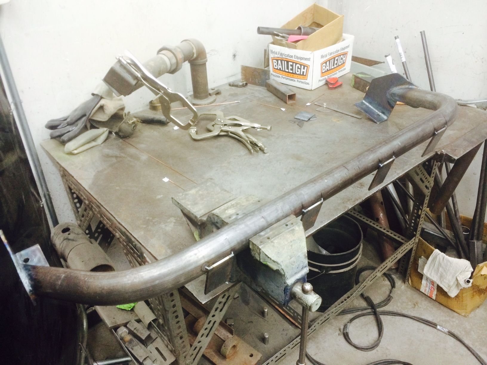

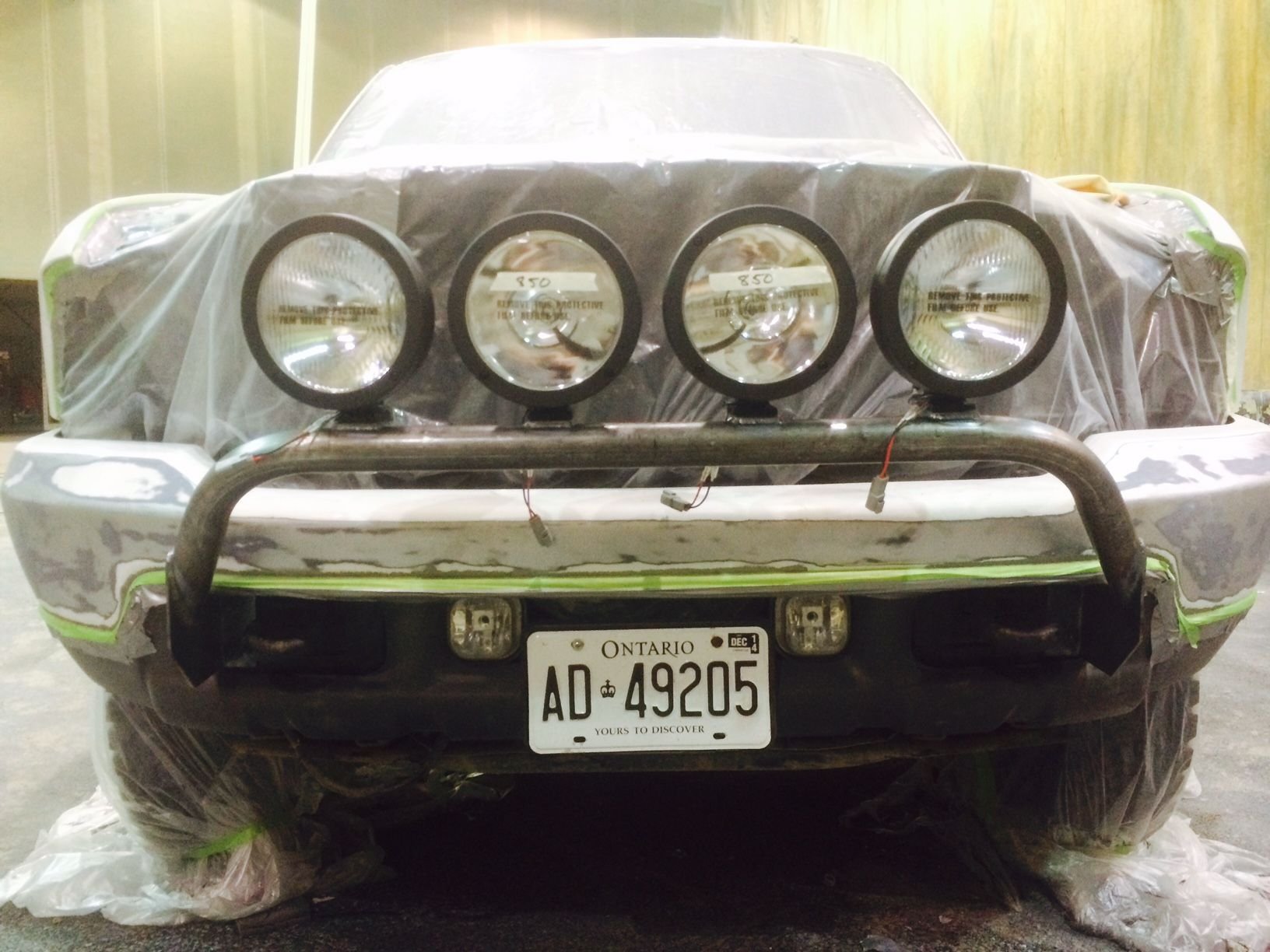

Here’s what I did, I built one years ago. Not for protection really, more for lights, but I did build it with strength in mind for pushing on or going through some light bush etc. The same as the one you found, it attaches to the front bumper mounts, which are actually the frame rails. Best spot on those model years to attach to. This bar is DOM1025 2” (0.125) tubing with 3/16 plate attach brackets. It’s pretty strong. I do not recommend black pipe, It’s very brittle. This tubing was left over from a roll cage build. Strong enough for my application. I’m not sure how it would do with a deer, some protection.
But on our older trucks, there really isn’t a great place like that to attach to. I’m in the middle of fixing up my ‘96 F250, same as yours essentially, and I still have that light bar. I looked for a good spot to attach it to, but can’t really find anything. The only place I can see, is to have it under the bumper, and attach to the frame. At which point, it’s going to have to be so big and thick looping under the bumper to have any strength, it would be low and ugly. The only other option, is to cut into the bumper and have it pass through. Which I thought of doing, but would ruin the chrome.
