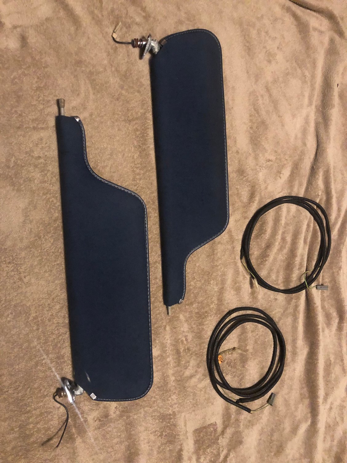

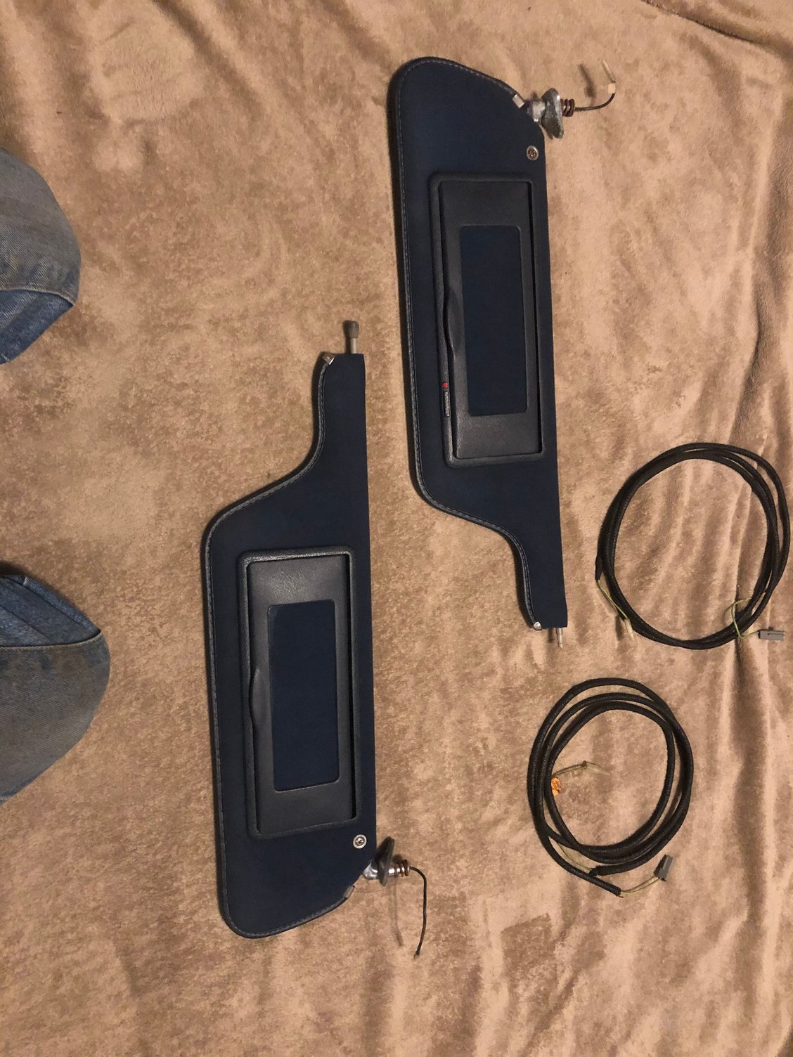

Vanity visors catalog
So, I have a set of cloth Vanity visors that came out of 79 Lariat.***edit: Linc, mk-v**** They're dual vanity and the drivers side has a garage door button. These are identical to the ones in my 78, albeit cloth and the button. I listed them for sale and received a whole lot of flack about it. I know the cars had these but have we ever seen them in the trucks? Can anyone provide the catalog listings? Thanks in advance as i wish to be on the up and up. Pics soon. ***Edit: Storage box was labeled (correctly), I was completely oblivious***

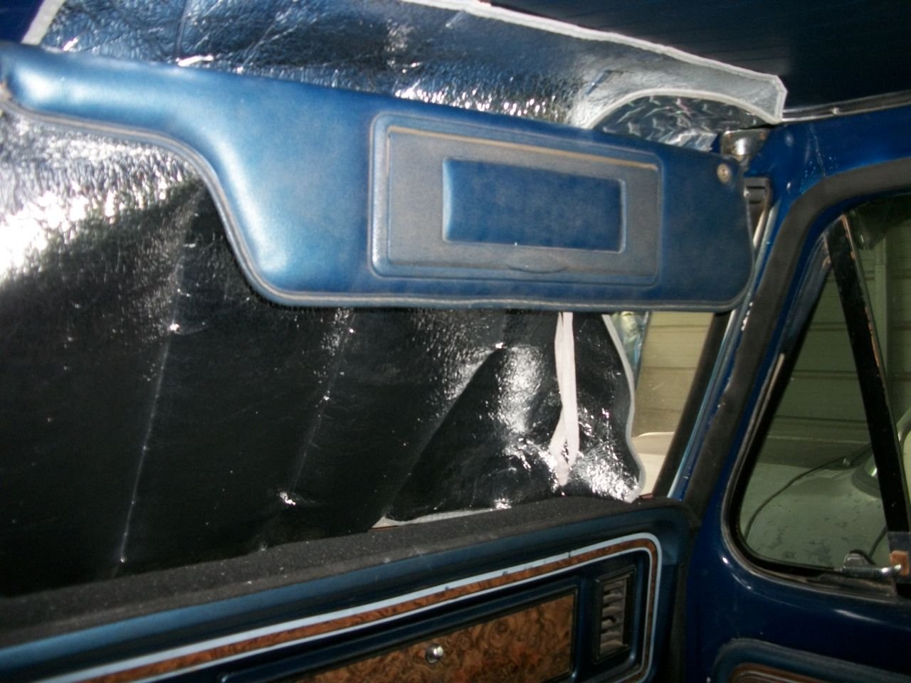

Old Sep 2, 2020 | 10:55 AM
77&79F250's Avatar
77&79F250
Moderator & parts slinger
Posts: 50,256
Likes: 5,818
I have never seen a cloth set or BOTH visors with a lighted mirror. And I never seen one with a Garage button, way cool. I have only seen the passenger side with a lighted mirror....in my blue 78 F250. Looking for the pic.

Old Sep 2, 2020 | 11:14 AM
77&79F250's Avatar
77&79F250
Posts: 50,256
Likes: 5,818
Here you go. Maybe someone will chime in and say they are 1980 visors?

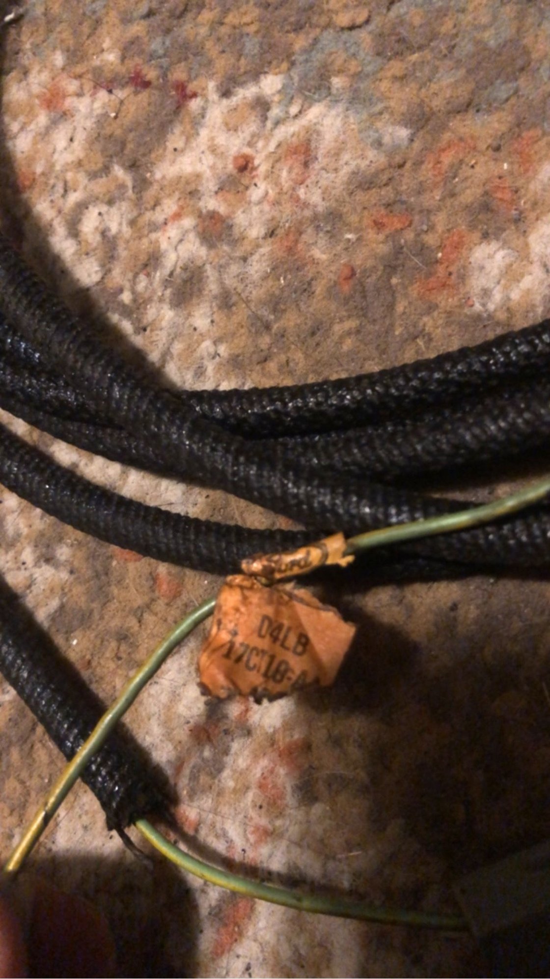

Old Sep 2, 2020 | 11:47 AM
broktruk's Avatar
broktruk
Joined: Jan 2018
Posts: 898
Likes: 70
From: Coos Bay
Ya. They did. That was my first thought.
Doesn’t prove anything but, the last pic has a numbered tag from the wiring.

Old Sep 2, 2020 | 02:55 PM
77&79F250's Avatar
77&79F250
Posts: 50,256
Likes: 5,818
Found it and it works. But man are those visors thick on both sides. Like poofy, like 1/2 thick. And only the passenger side has the mirror.
Old Sep 2, 2020 | 04:38 PM
broktruk's Avatar
broktruk
Joined: Jan 2018
Posts: 898
Likes: 70
From: Coos Bay
The ones in my truck are saddle and same same as yours. Found the original build sheet and they were included from the factory on my 78 EXP. These others are identical, but have cloth instead of vinyl, cloth on the insert for the lid as well.
Old Sep 2, 2020 | 04:41 PM
77&79F250's Avatar
77&79F250
Posts: 50,256
Likes: 5,818
Are yours THICK, like a crazy thickness? Even my drivers side is thick. Like 1/2" or maybe more.....Cool that you have them on your build sheet.
Old Sep 2, 2020 | 05:07 PM
broktruk's Avatar
broktruk
Joined: Jan 2018
Posts: 898
Likes: 70
From: Coos Bay
Yes. Sent a set of green ones to texas. Same guage.
Old Sep 2, 2020 | 05:39 PM
scottscott's Avatar
scottscott
Joined: Dec 2007
Posts: 1,512
Likes: 340
From: Wildwood Pa
Going off the tag on the wire harness you pictured, those visors (or at least the wire harness) are from a 70's Lincoln.
D= 70's, 4 1974, L = Lincoln, B = body.
Old Sep 3, 2020 | 09:00 AM
broktruk's Avatar
broktruk
Joined: Jan 2018
Posts: 898
Likes: 70
From: Coos Bay
Yes. And would be more helpful if I read the labels on the box i stored stuff in. 79 Lincoln mk-v. The lariat visors are vinyl.

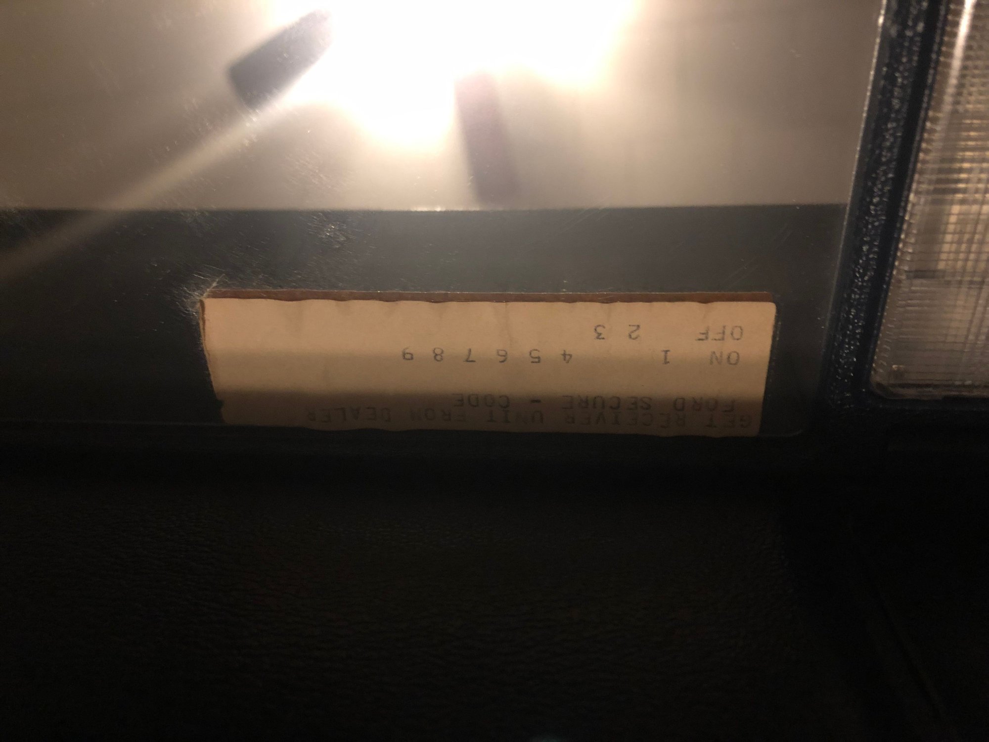

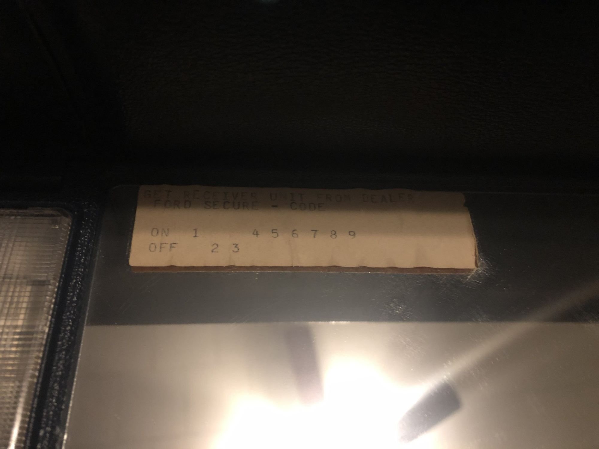

Old Sep 3, 2020 | 10:36 AM
meangreen92's Avatar
meangreen92
Joined: Jul 2005
Posts: 4,217
Likes: 154
Those numbers represent a bunch of little On/Off micro-switches in the opener assembly's receiver. You can see that 2 and 3 would be set to the Off position, while the rest are set to On.
